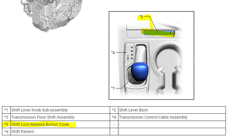

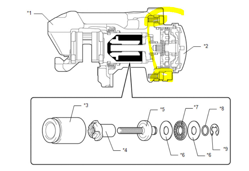

As far as the parking brake is concerned, if you have no power, the only suggestion I have is to remove the electronic parking brake actuator on the rear of the brake caliper. See pic below. There is a long screw that turns and pushes the caliper piston and engages the brake.

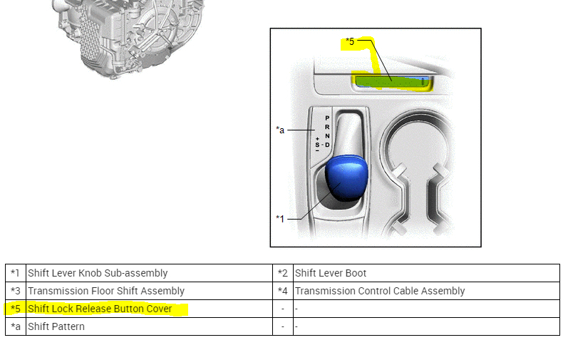

To remove the transmission from park, there is a shift release button. If you look at pic 2 below, it shows the location. Remove the plastic cover and the release button is below it.
Let me know what I can do to help. Also, these are great vehicles, so I'm not sure what led to this happening on such a new vehicle.
See pics below.

Thank you for your response! Car is a repo with no keys. It's in immobilized status. I was able to get it unloaded from carrier by removing the electronic emergency brake motors and putting it in Neutral by pushing the shift release button.
