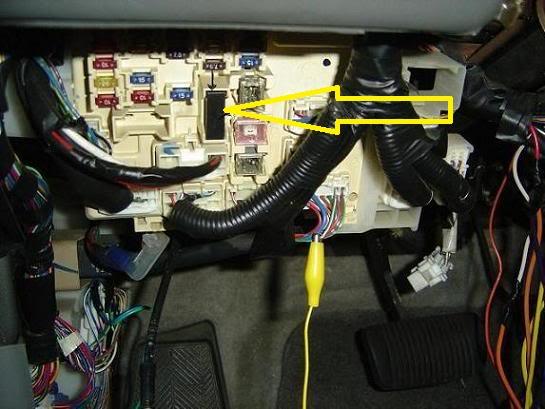

Hi Sir, I checked further and found a big black fuse-like part (see the pictures) in the fuse box below the steering wheel. I pulled it out and found a part numbers on it "90980-04066". It's not transparent and can be seen filed with epoxy from the bottom. I found no continuity (no current passing through) between the 2 blades. Toyota calls it "condenser" and several dealers can't tell me what it's and it's a special order item. People in the internet said it's a fuse, circuit breaker, relay, diode, or capacitor. If it's a fuse or circuit breaker, then it's blown. But if it's diode or capacitor, it might be normal and I don't need to order it. Please advice. Thank you very much!!!

Sorry, I forgot to attach the pictures.

The yellow arrow in the last picture pointing to this big black fuse-like part in the fuse box.

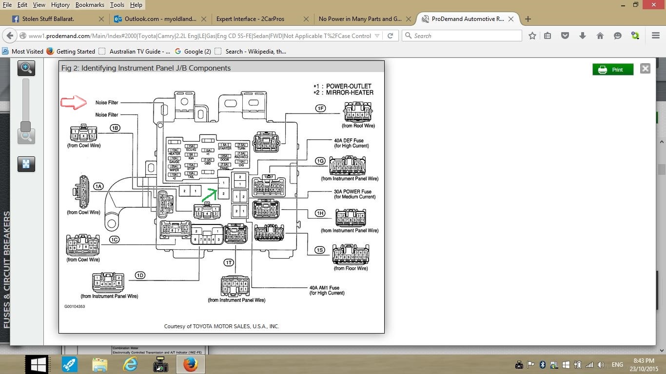

From what i can find out it is what is called a noise filter, it 's exact function is something that i will have to look into, but i do believe that it will not case the car not to start and i am not sure how to test it, its something that i have never had to deal with before.

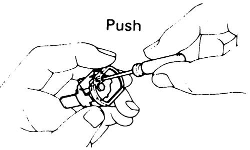

I have went through many internet messages on this condenser 90980-04066 and just found one person said both new and old condensers had no continuity between the two prongs. If true, it is more and more likely to be a circuit breaker opened. Many people talked about a re-settable circuit breaker in Camry 1988 ~ 1996 (see the attached pictures), but I can't find it even after the left kick panel was removed. The Hayes Repair Manual for Camry 1997 ~ 2001 very briefly talks about circuit breakers, but doesn't show numbers, locations and pictures.

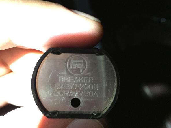

Please see the pictures from some internet messages on re-settable circuit breaker.

Tye re set circuit breaker is quite easly identified with the hole to access the re set function, i believe that Toyota have not used these for a while now, but i could be wrong, what you have identified on the earlier pic is not a circuit breaker, but a noise filter as shown in my pic.

i am thinking the same, but not for sure. People found their re-settable circuit breaker near that black condenser in the fuse block area behind the left kick panel, and their Camry was built before 1997. Another person also didn't find it in his 1999 Camry. The Hayes Manual for Camry 1997 to 2001 shows details and photos of fuses, cartridge-type fusible links and relays, but only has 3 sentences on circuit breakers without any details and pictures. So many parts without power suggest most likely an opened circuit of a main fuse/relay/circuit breaker, right? Is there any possibility of computer software issue that needs reset by Toyota? Thank you so much for your kind help, time and efforts!!! Really appreciate.
