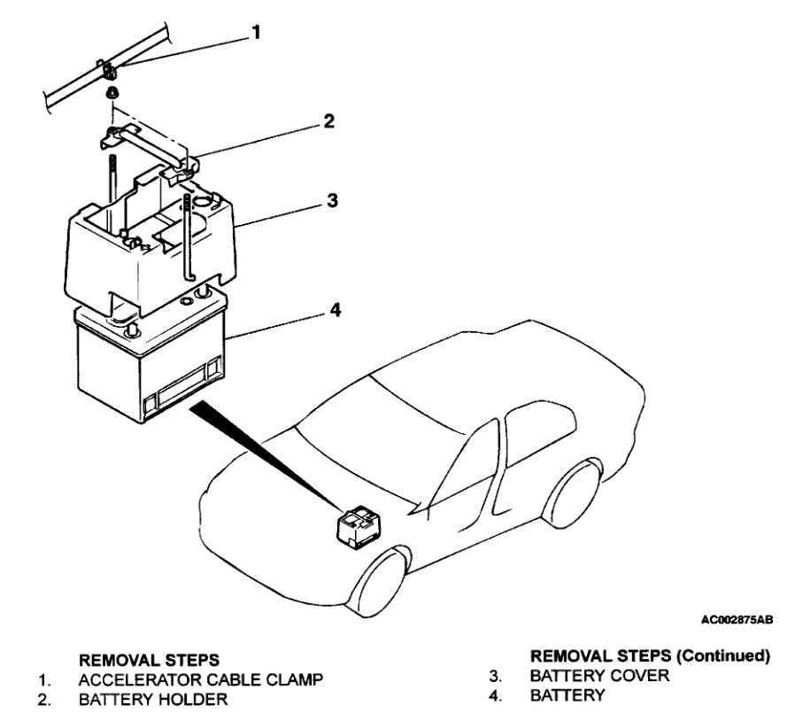

It sounds like the battery cables are dirty/loose or the battery is no good.
here are two guides to help us fix the problem:
and
Please go over these guides and I have included how to change the battery out in case you need it as well. Check out the images (below). Let us know what you find.
