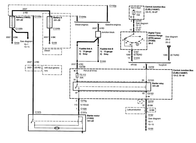

I have seen many ground issues and ignition switch issues with these trucks. I will include the starting system diagram but one easy way to verify ground continuity is to get a set of jumper cables and go from the battery to the chassis to see if things change. You can also try that from the body to the chassis.
