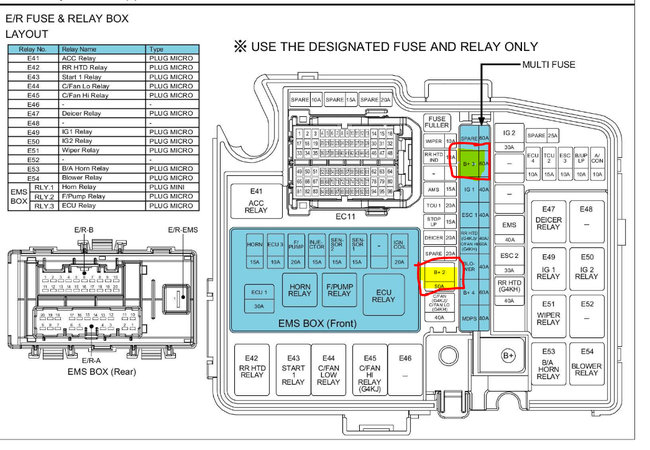

I turn the key and motor turns over but no power to anything inside the car. What could it be?
Dec 20, 2019 at 8:20 PM
CERTIFIED EXPERT
110,175 POSTS

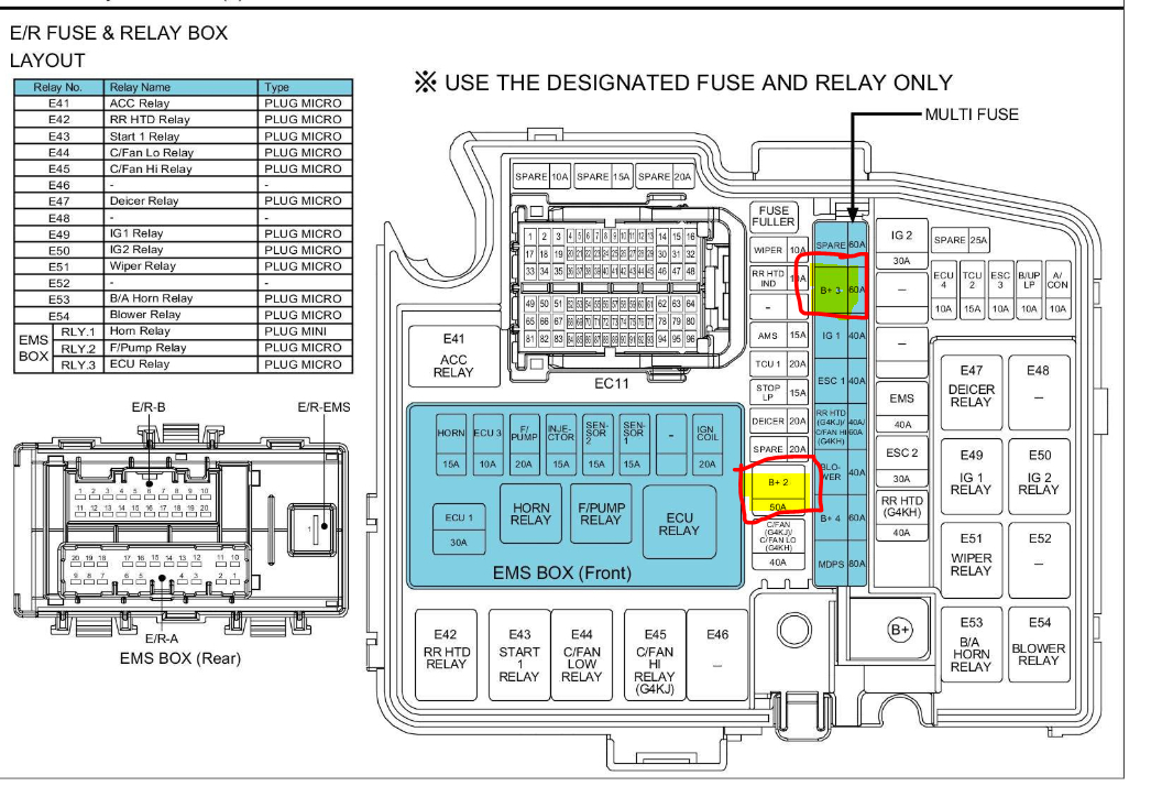

There are two fuses under the hood of the vehicle (power distribution box) which supply power to the instrument panel fuse box. I attached a pic below of their locations. Check both of them.
