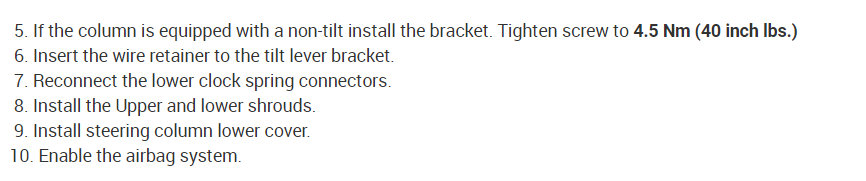

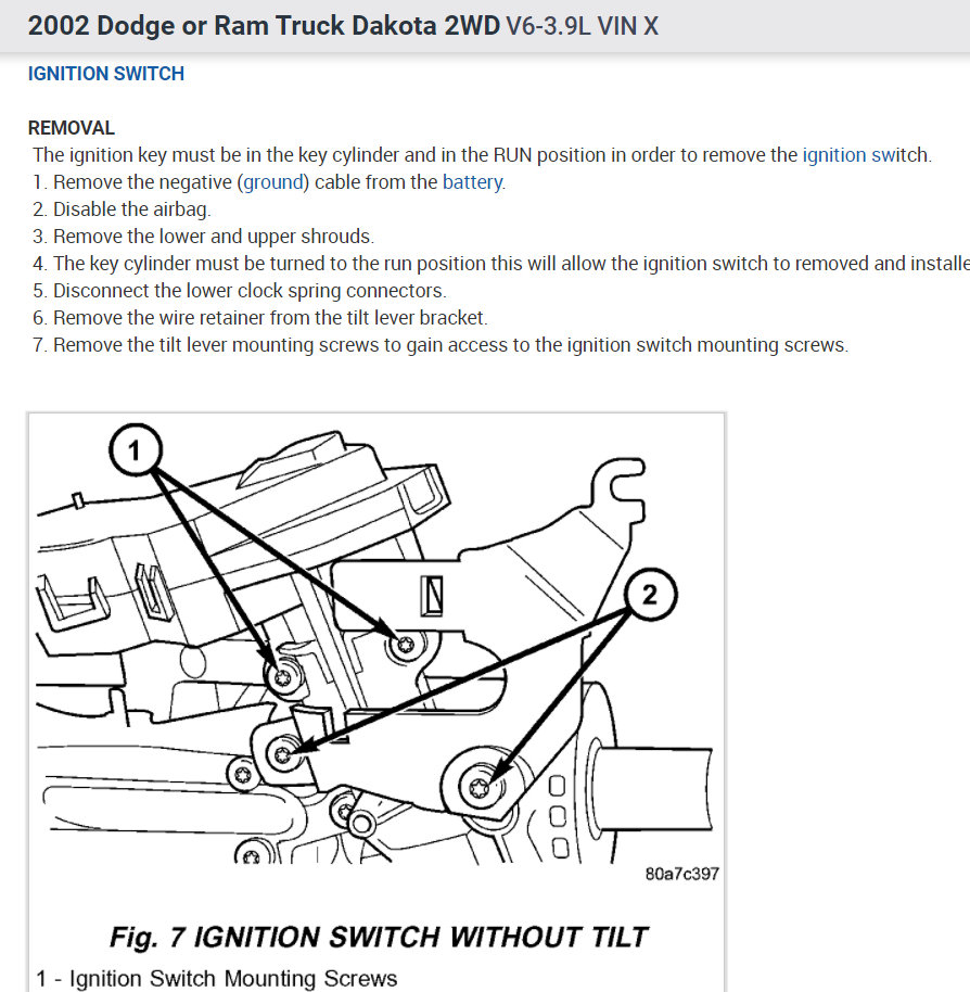

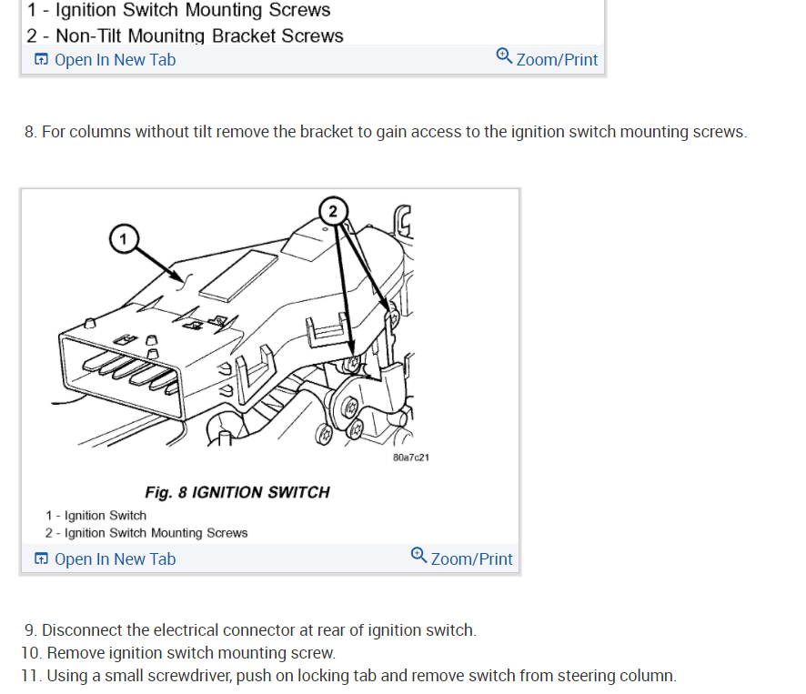

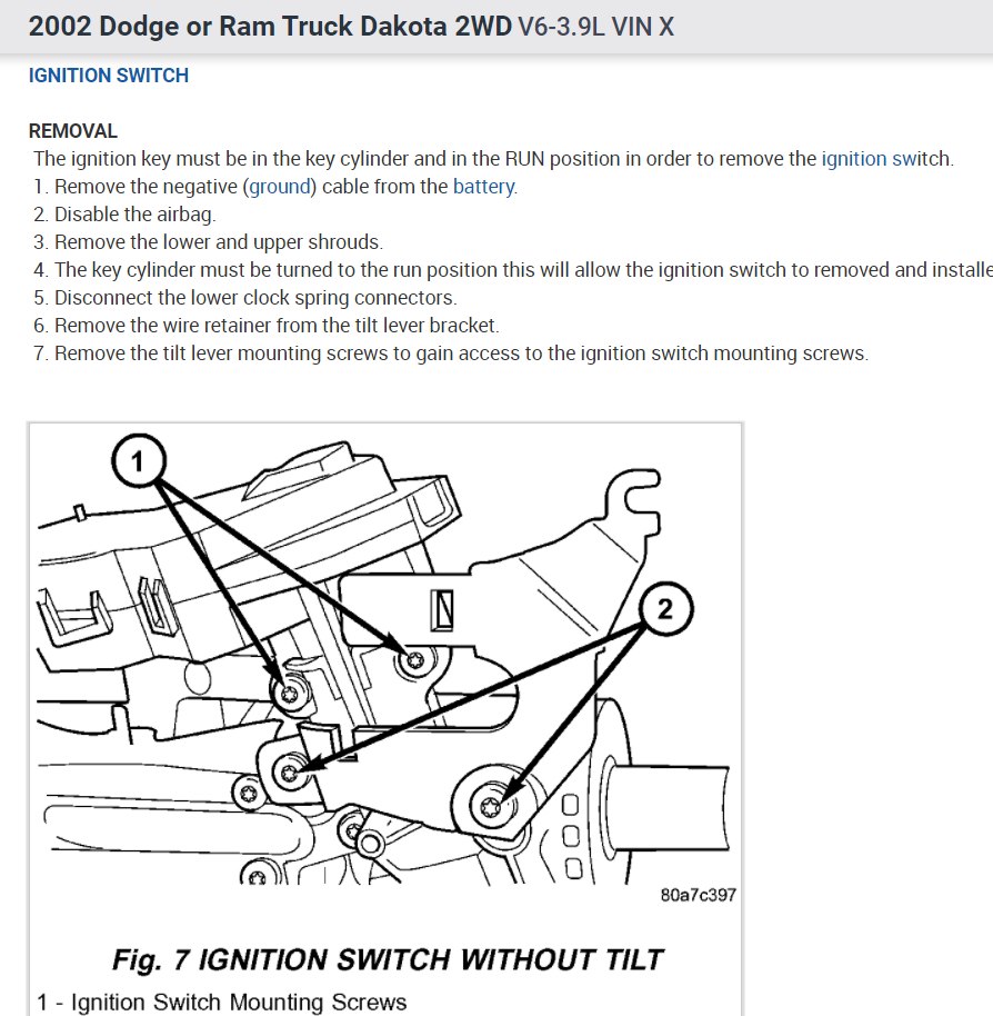

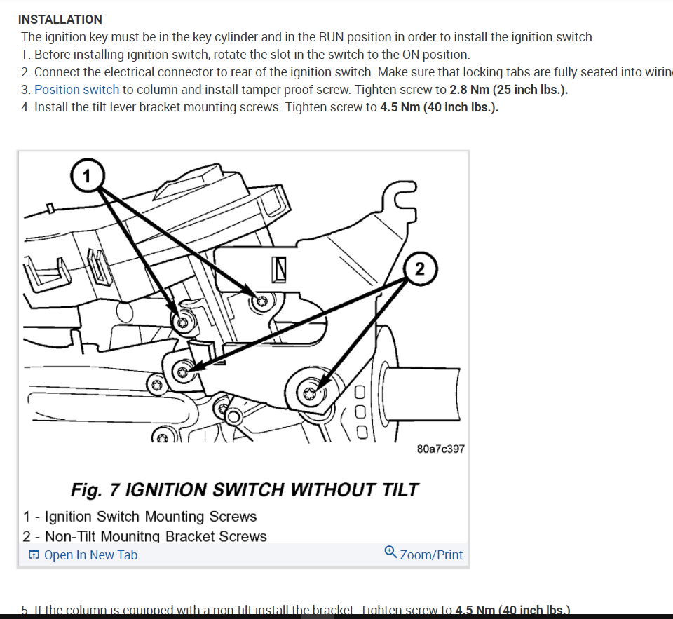

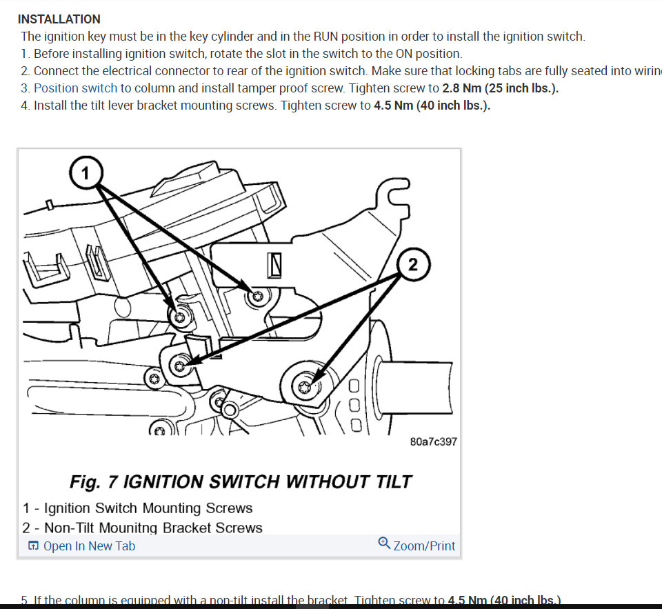

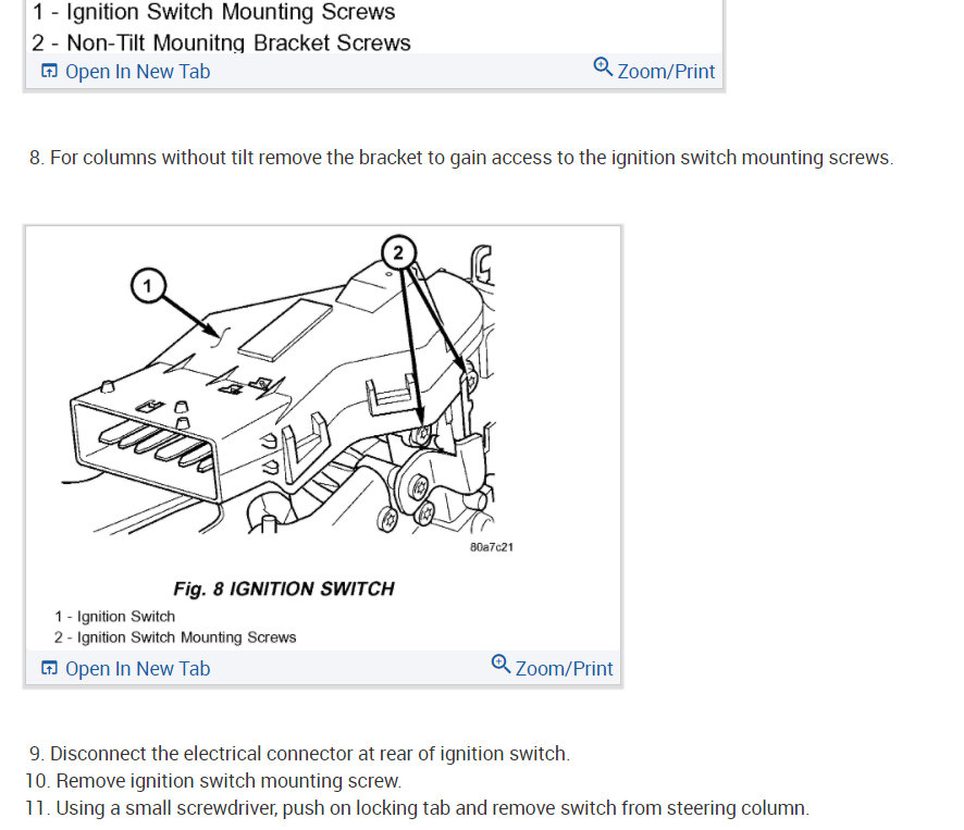

This sounds like the ignition switch went out which is common. here are instructions in the diagrams below on how to replace it. Check out the diagrams (below). Let us know what happens and please upload pictures or videos of the problem.

Believe ignition switch shorted draining the battery. Removed ignition cylinder. Now have power; but need to replace cylinder and ignition switch. Soon. Thank you.

Sorry I'm late.... promise to do better in the future.... Problem was the damage to the steering column.... Ignition cylinder failed... Ie. unseated out of its "position..." did not turn the ignition switch off.... sat on for several days.... Ruined the battery. replaced steering column... new switch, and new battery... starting find.
