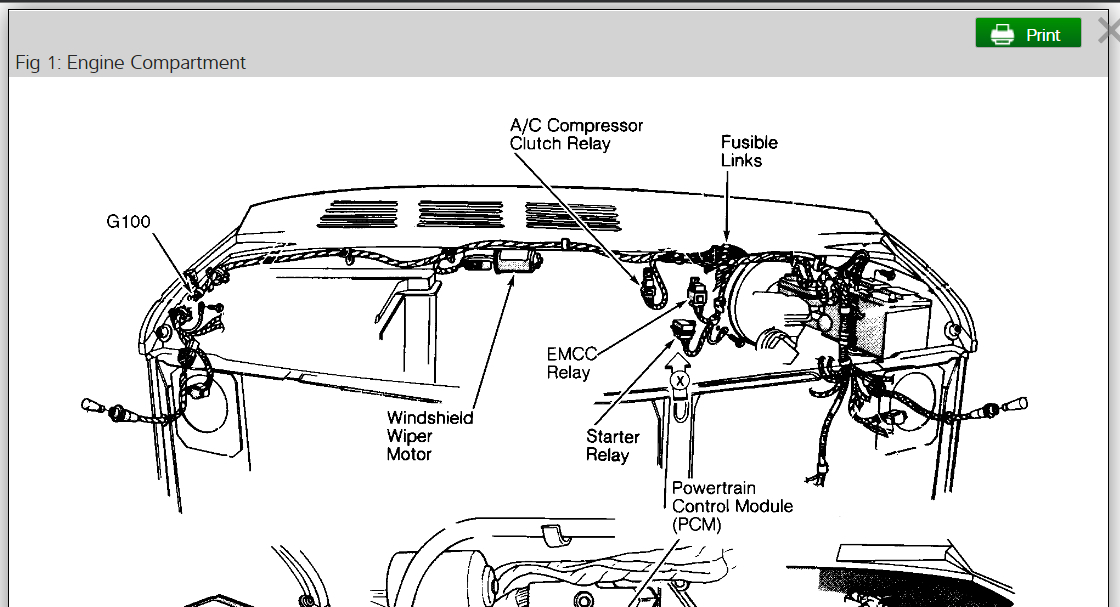

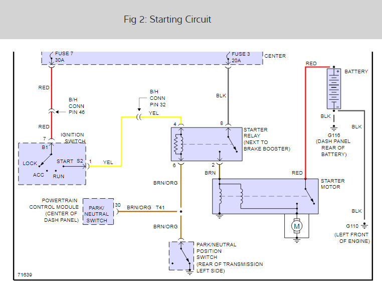

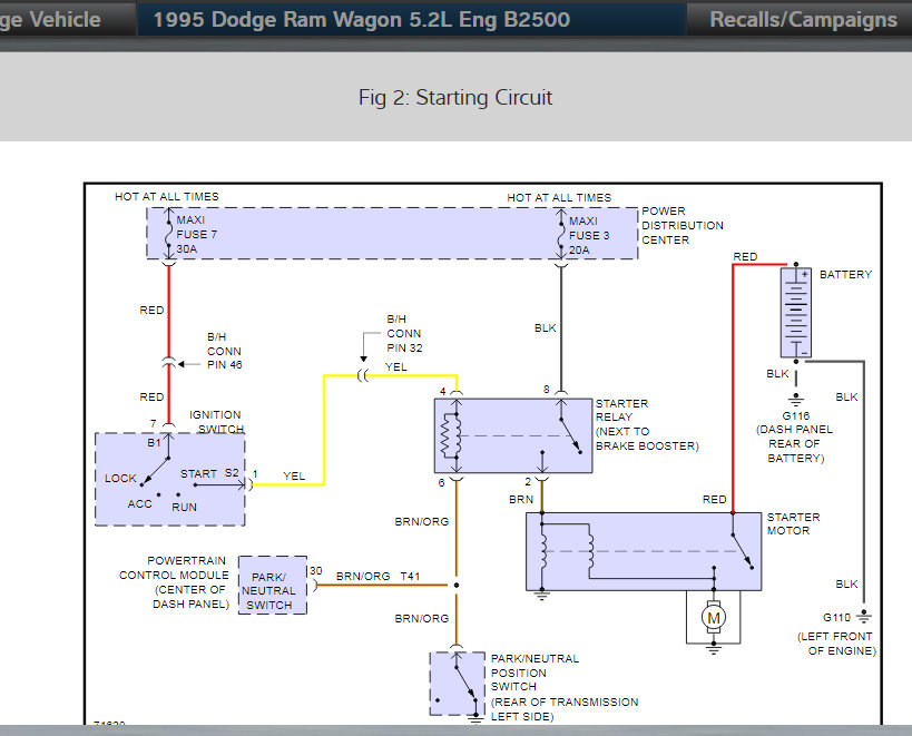

Will do, but nothing has worked so far. Changed some of the fuses and swapped the battery but still no power coming from the battery and did I mention that the oil dipstick is live for some reason? It will shock the crap out of you if the van is turned on.
I'm not sure what else to do, but I do know that a lot of the fuses were incorrect as far as amps and position. But anyway still nothing.
