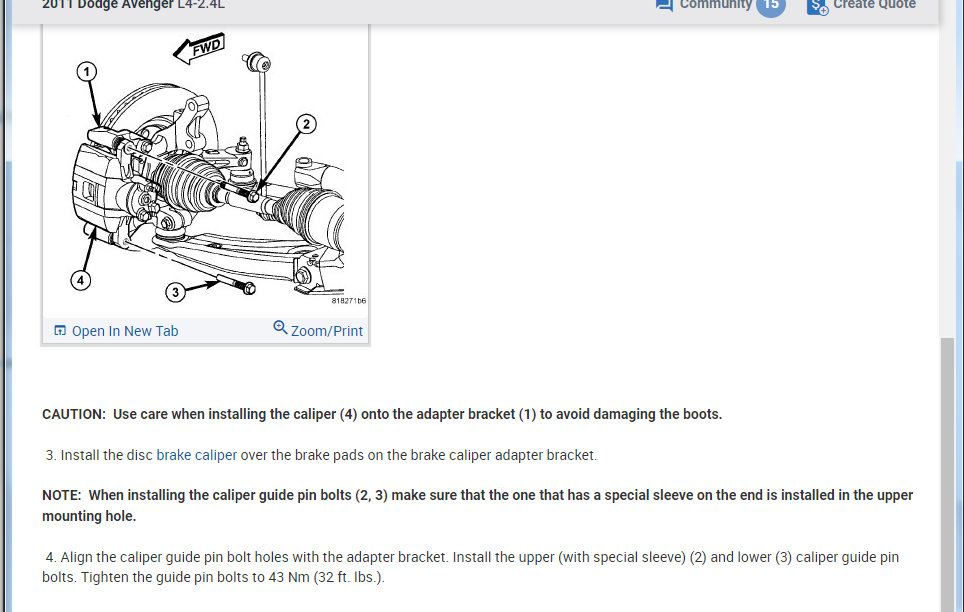

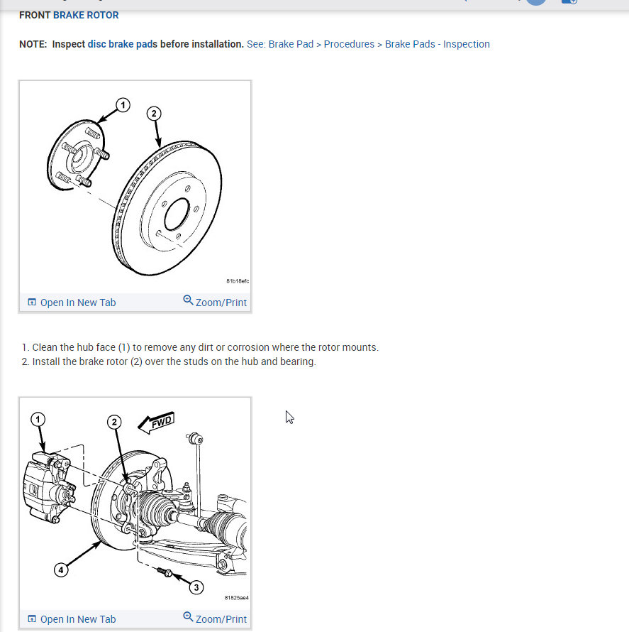

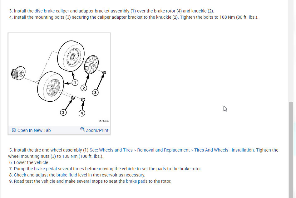

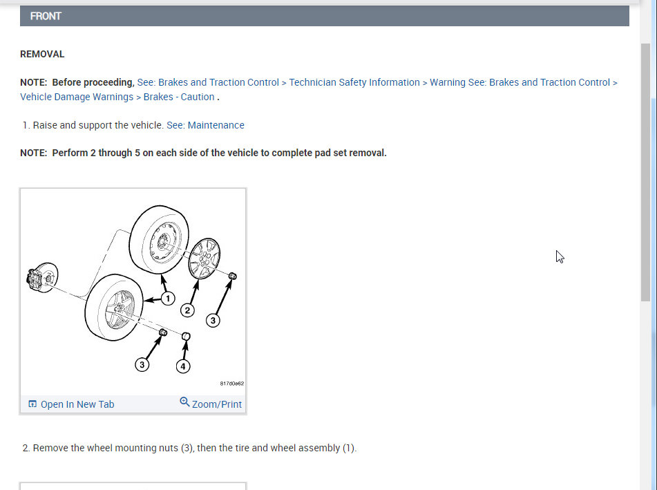

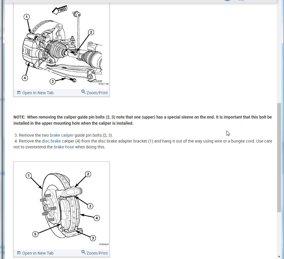

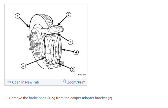

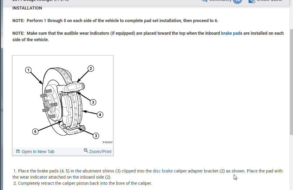

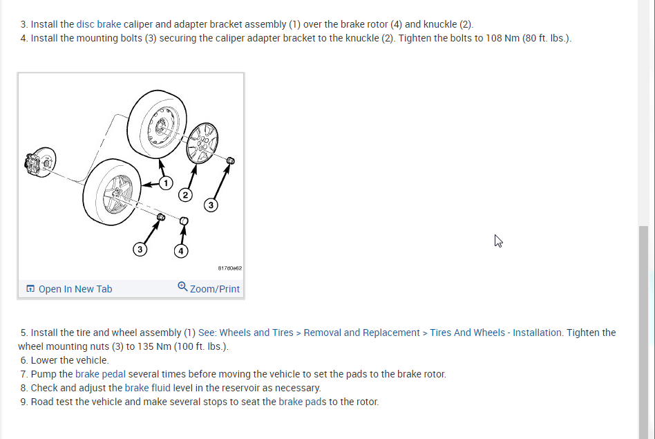

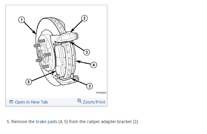

Lastly below is the process from the manual that will help with replacing the pads on this vehicle. Let us know if you have other questions. Thanks
Mar 30, 2021 at 2:02 PM
Additionally, here are the installation instructions for the pads and rotors including torque specs.
Let us know if more info is needed.
