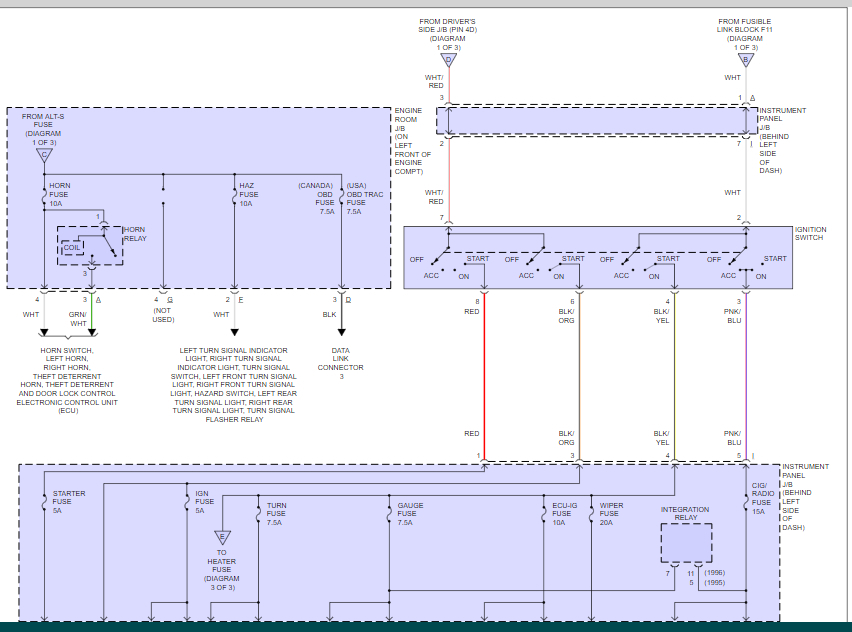

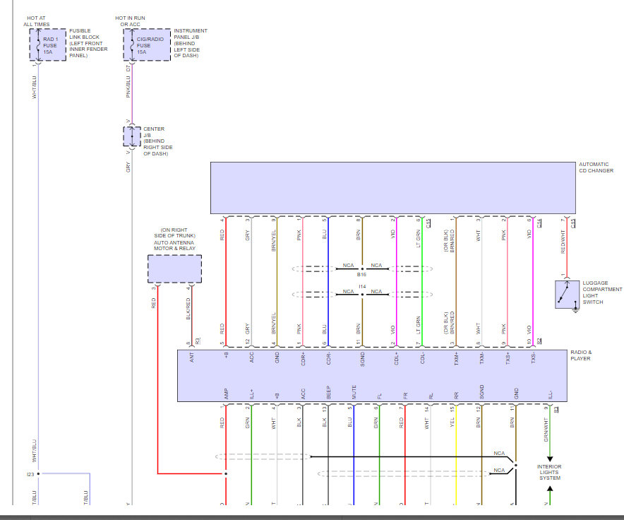

I have no power to radio or AC. Worked fine but suddenly lost power. Checked all fuses and relays all seemed to be good. Any ideas?
Jul 15, 2018 at 6:17 AM
ROL*S.
CERTIFIED EXPERT
61 POSTS
Hi Shawn, that cigarette/radio fuse is for radio, A/C. Do you have a test light to see if it has voltage? And if not, you have to go back and look for volts at ignition connector #3.
