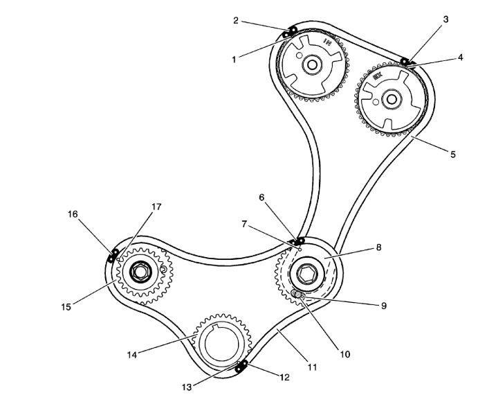

The next step would be compression to verify timing between cam and crank.
Do a compression test or pull the front cover to verify the timing marks

It's starts great, idles great. scanner indicates cam and crank are in sync.
May 17, 2019 at 5:07 AM
I would still check the compression to be sure.
