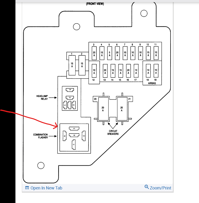

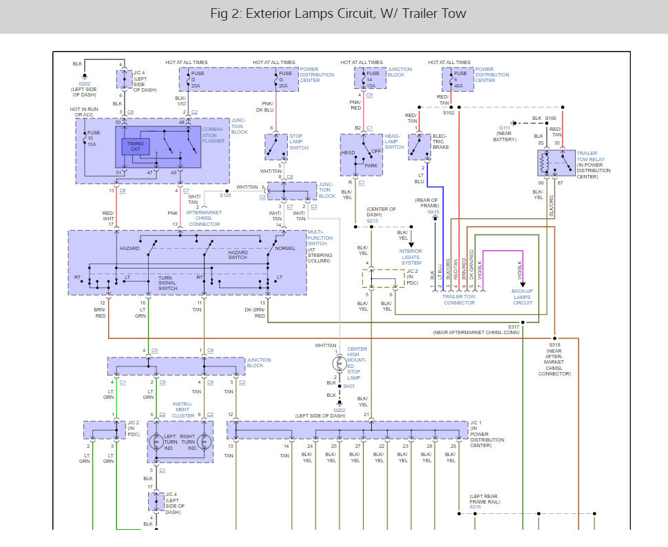

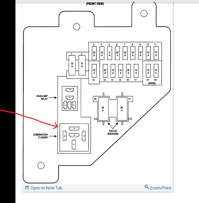

There are 5 fuses that run the system please check them for power with the key on. Please check fuse D, G and 6 in the under-hood fuse panel and fuse # 14 and 10 in the interior fuse panel.

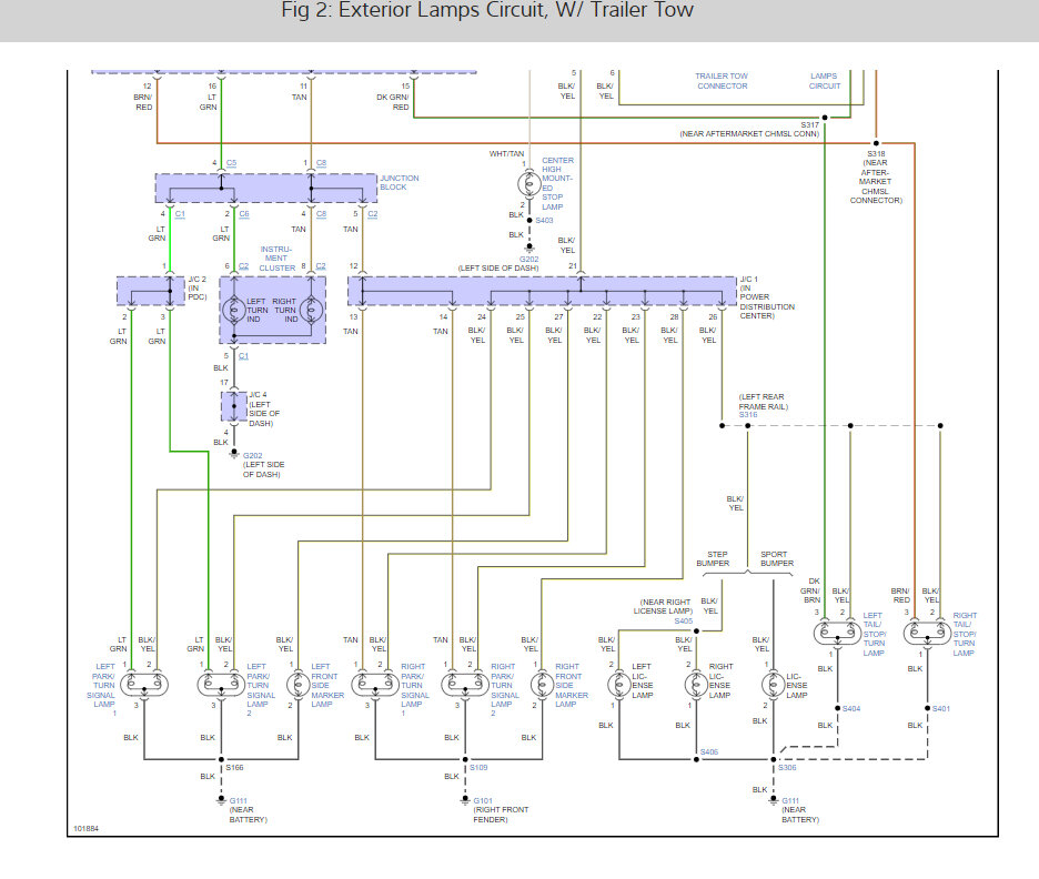

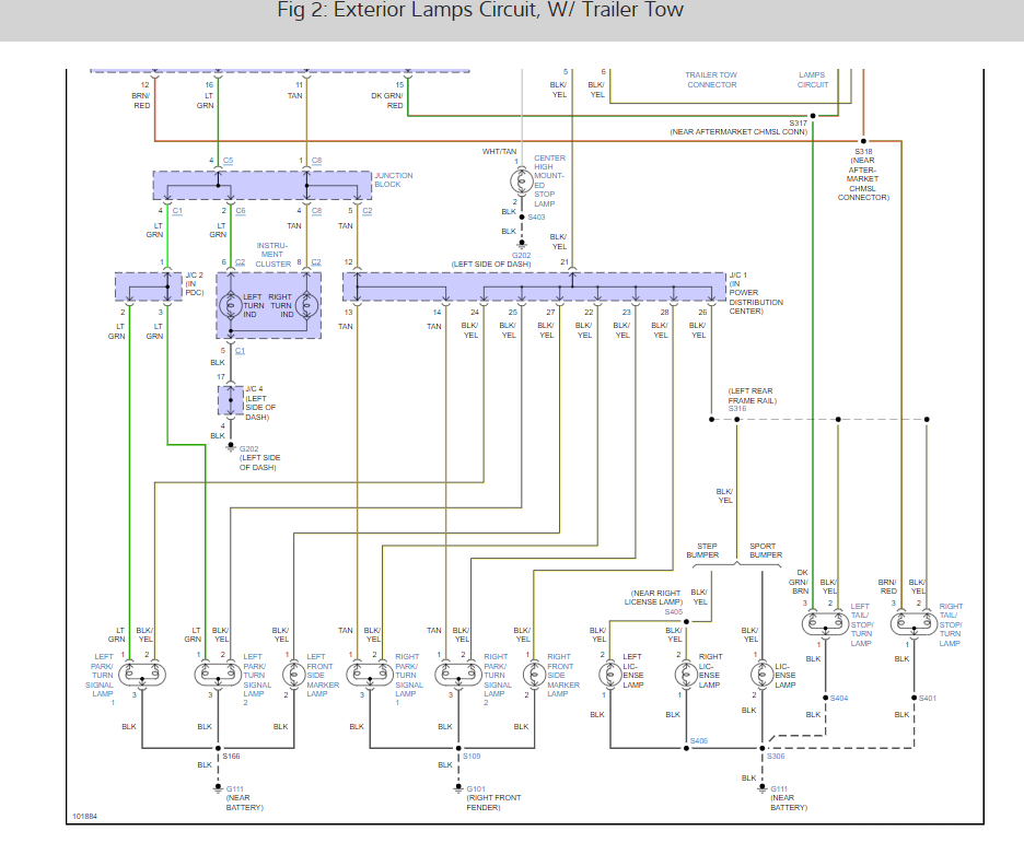

Here is a guide to help and the running light wiring diagrams so you can see how the system works. If all fuses are good, I would replace the combination flasher here is the location for that as well. Check out the images (below). Please let us know what you find. We are interested to see what it is.
