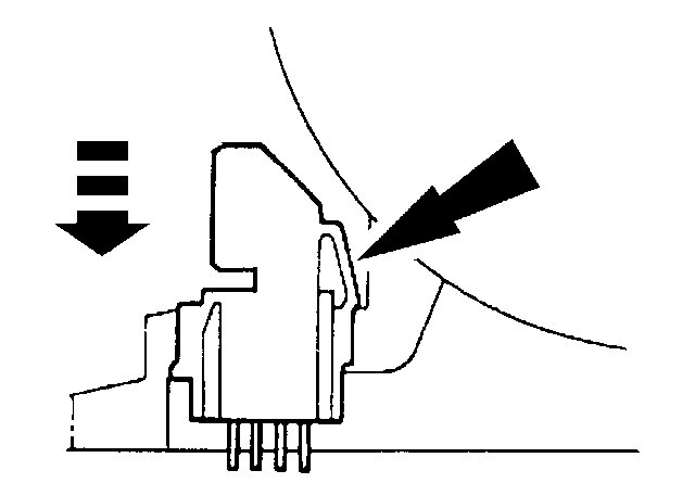

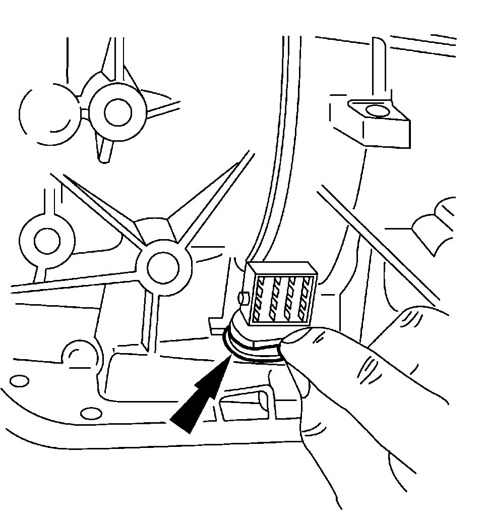

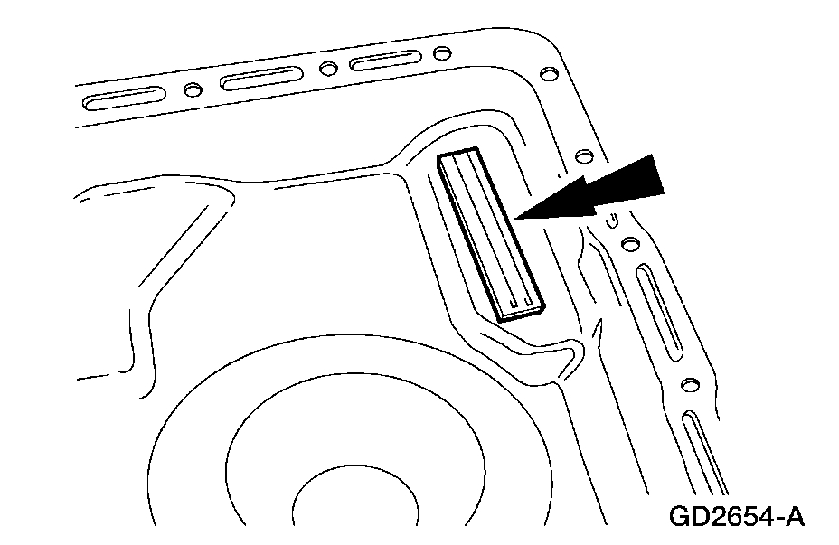

1. With the vehicle in NEUTRAL, position it on a hoist.
pic 1

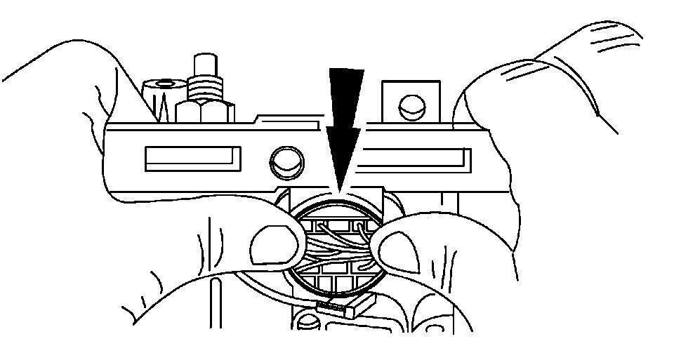

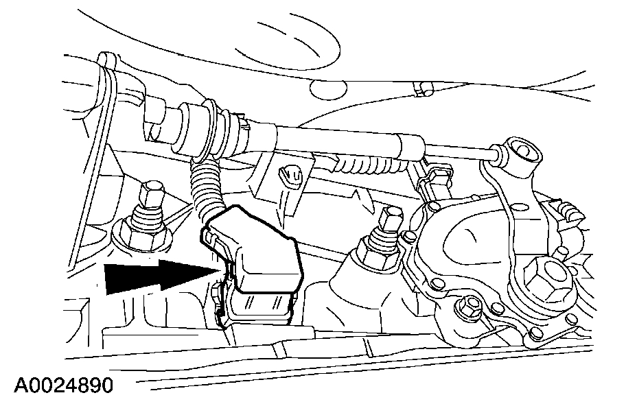

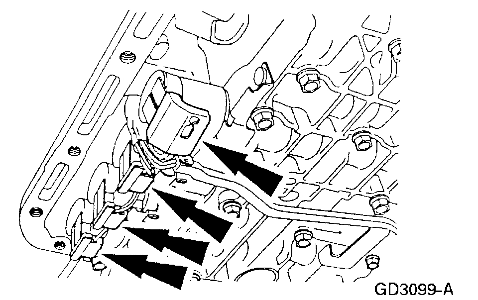

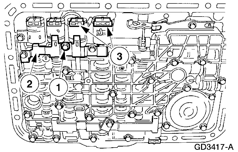

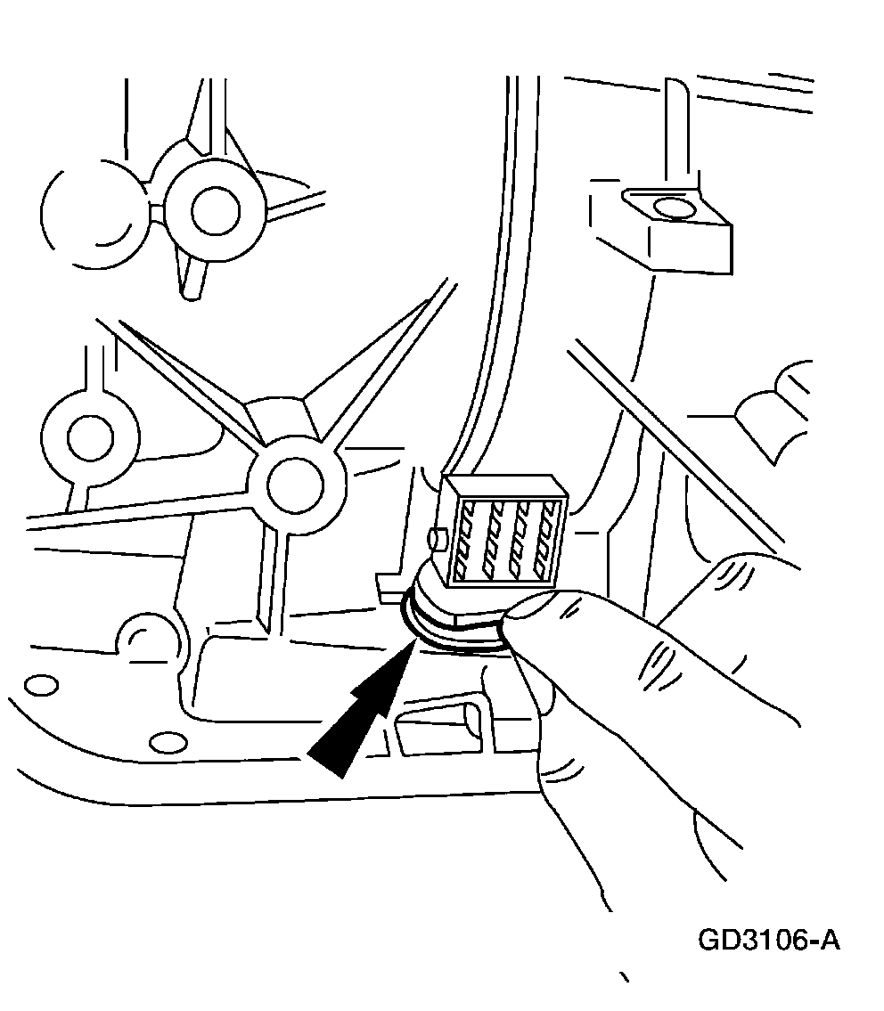

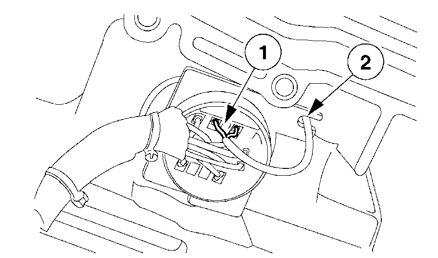

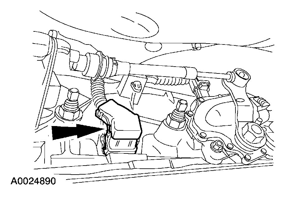

2. Disconnect vehicle harness from transmission case (16-pin) connector.
pic 2

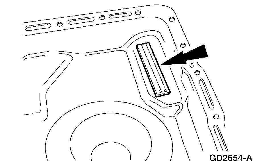

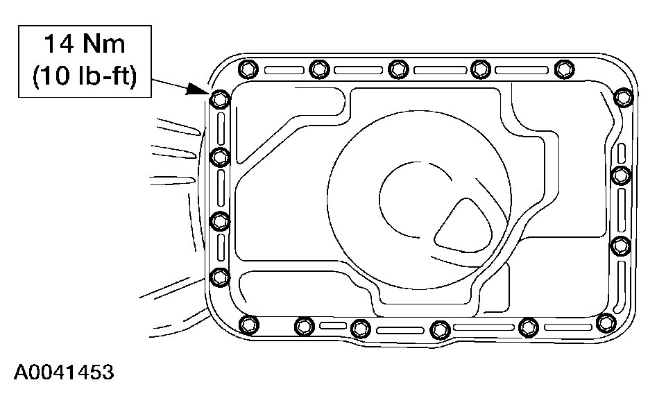

3. Drain transmission fluid.

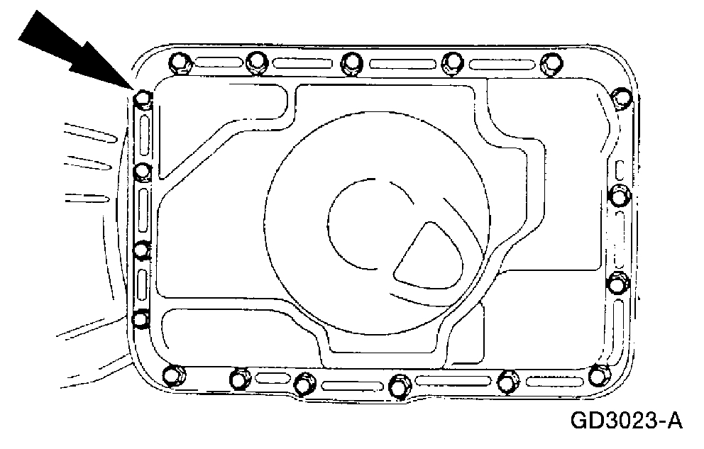

^ Remove all the transmission fluid pan screws except for two in the front. Loosen the two front transmission fluid pan screws. Pry the rear of the transmission fluid pan down and allow fluid to drain. After fluid is drained, remove the front two transmission fluid pan screws.
pic 3

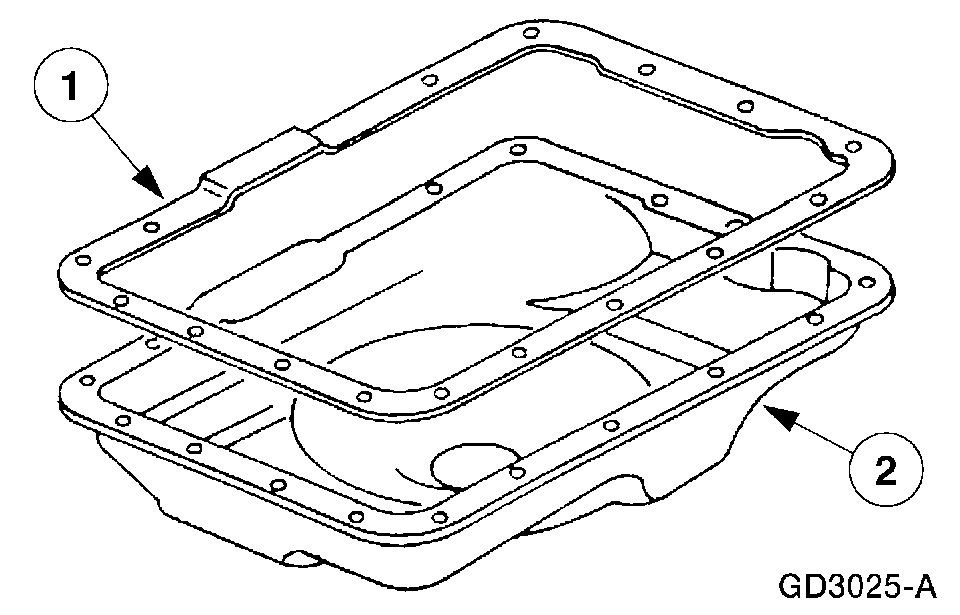

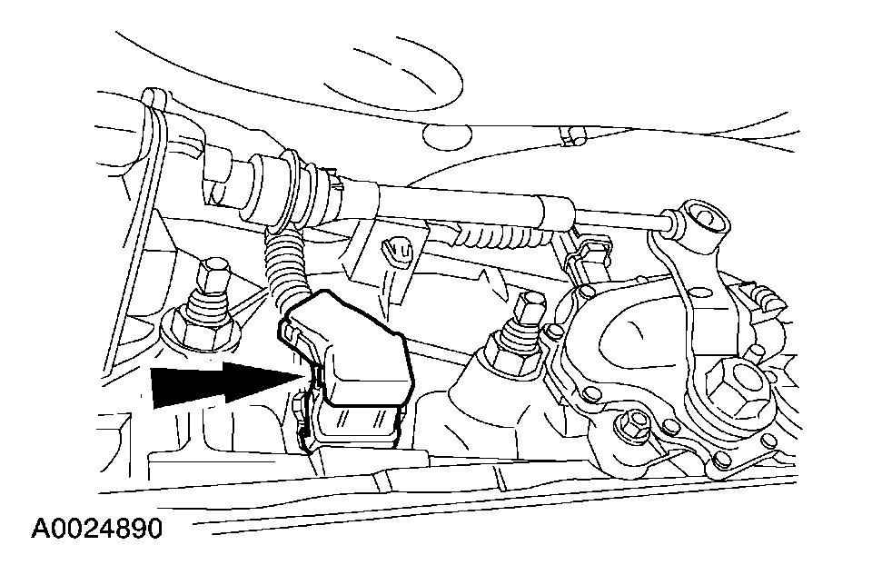

4. Remove the transmission fluid pan.
1. Remove the transmission fluid pan.
2. Remove and discard the transmission fluid pan gasket.
pic 4

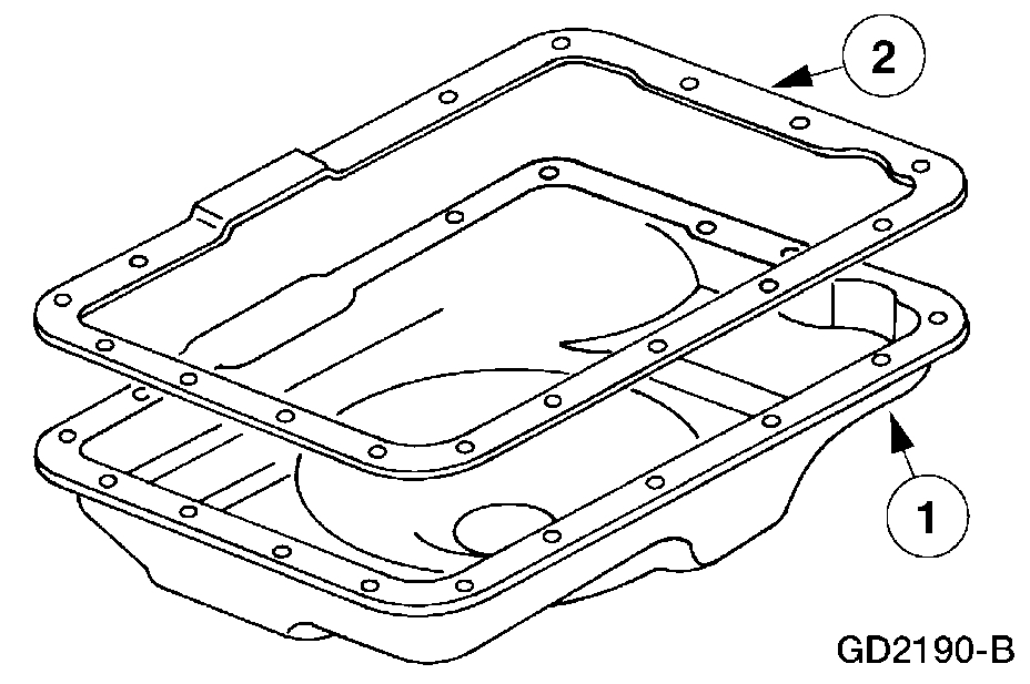

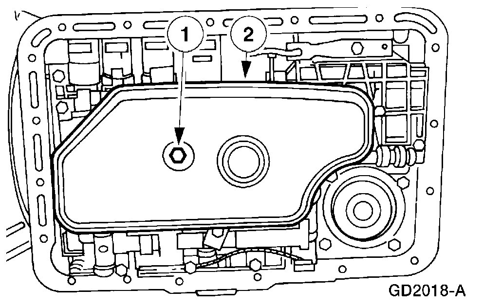

5. NOTE: The main control assembly does not need to be removed.

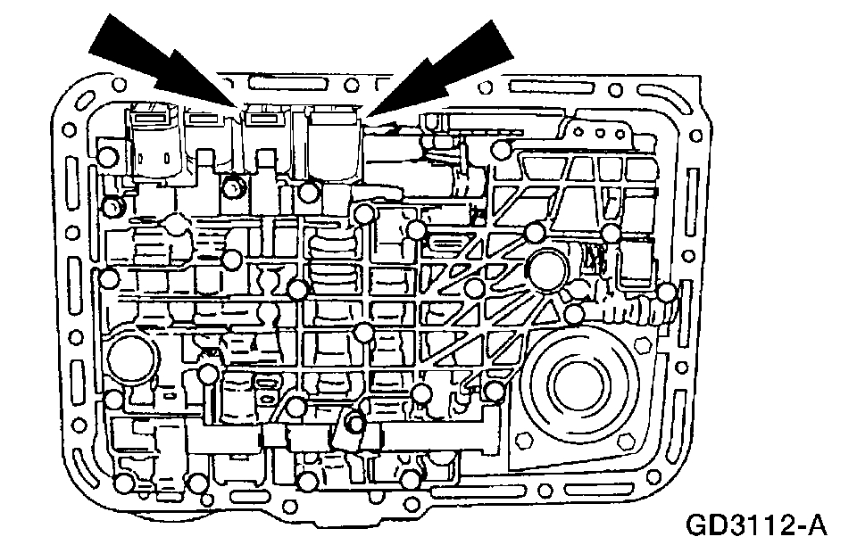

Remove the transmission fluid filter.
1. Remove the transmission fluid filter screw.
2. Remove the transmission fluid filter.
pic 5

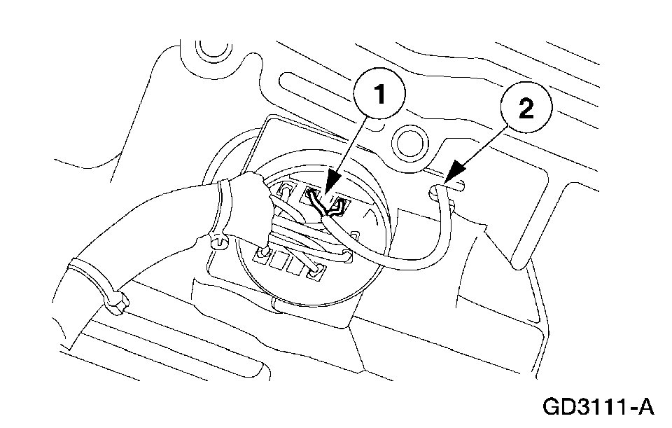

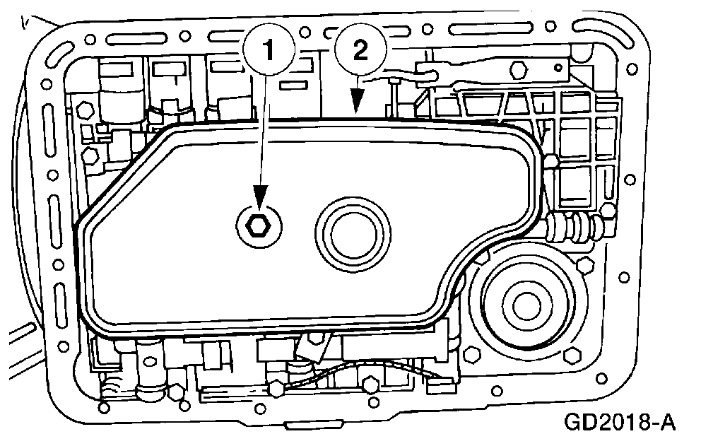

6. Clean and inspect the transmission fluid pan and magnet. Clean all mating surfaces.
pic 6

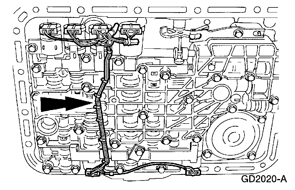

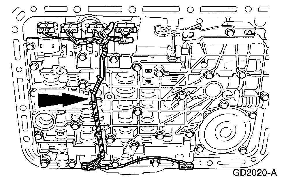

7. Remove main control valve body wire loom.

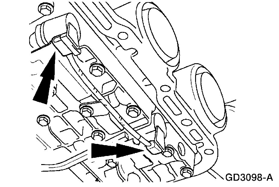

^ Carefully lift up on wire loom guide and protector and disengage the retaining pins from the solenoid clamps.
pic 7

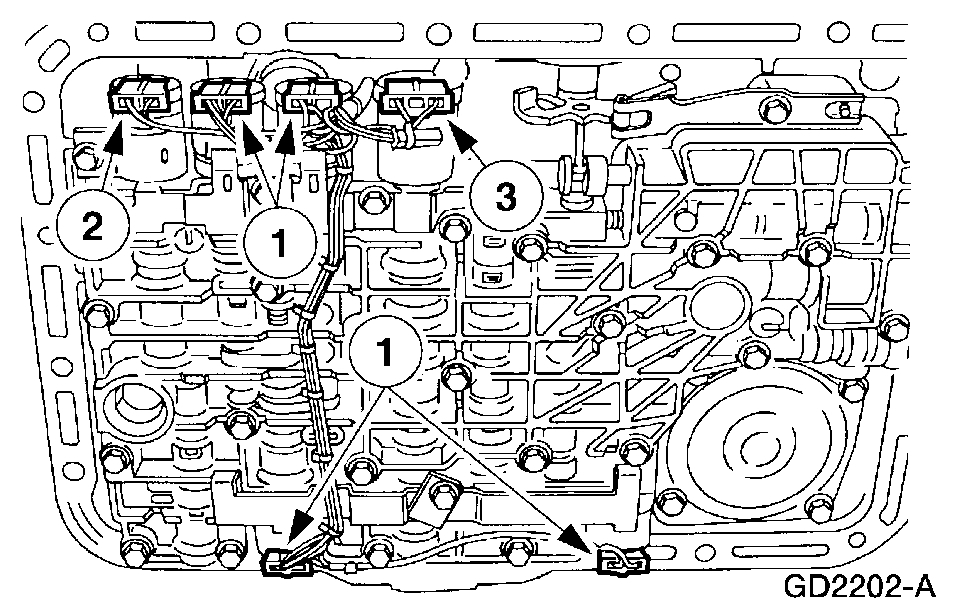

8. Disconnect the solenoid electrical connectors.
1. Disconnect the SSA, SSB, SSC, and the SSD electrical connectors.
2. Disconnect the torque converter clutch (TCC) solenoid electrical connector.
3. Disconnect the electronic pressure control (EPC) solenoid electrical connector.
pic 8

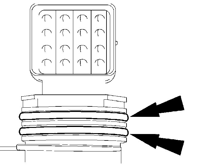

Remove the transmission case (16-pin) electrical connector retaining spring.
pic 11
12. CAUTION: Do not damage the connector or harness.
Remove the transmission case (16-pin) electrical connector.
^ Compress the tabs on the transmission case (16-pin) electrical connector.
^ Push the transmission case (16-pin) electrical connector out of transmission case.

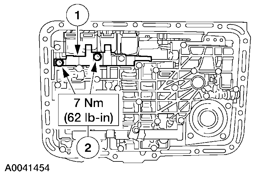

6. CAUTION: The solenoid clamp must be installed in the TCC and EPC solenoid grooves, shift solenoid pockets and the No. 204 plug.
Install the solenoid clamp.
1. Position the solenoid clamp on the main control valve body.
2. Install the solenoid clamp screws.
pic 18

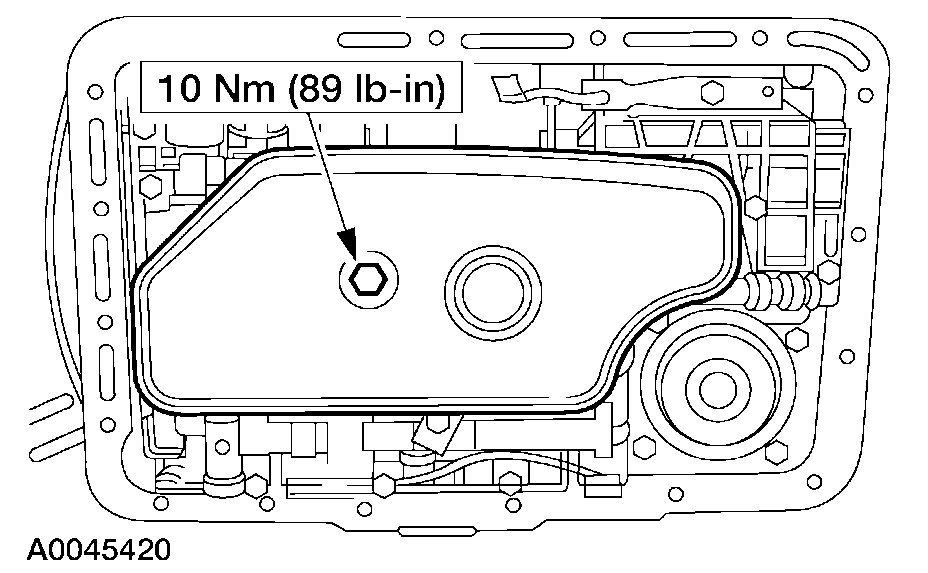

13. Tighten the transmission fluid pan screws.
^ Tighten the transmission fluid pan screws in a crisscross sequence.
pic 25

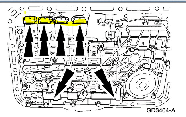

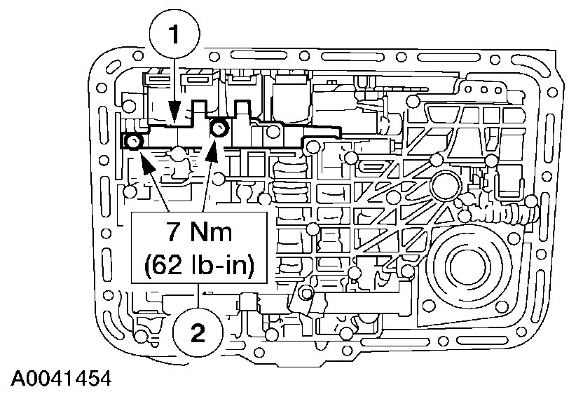

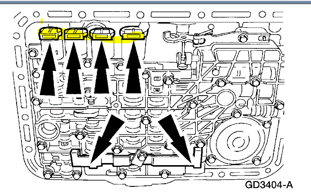

If you look at pic 26, I highlighted the shift solenoids. These solenoids are what cause the transmission to shift from one gear to the next. When actuated, the allow fluid to flow in a different direction and engage different clutch packs.
As far as a kick down cable, there isn't one on this vehicle.
Also, keep in mind there could be a pressure related issue causing the issues with the shifting.
