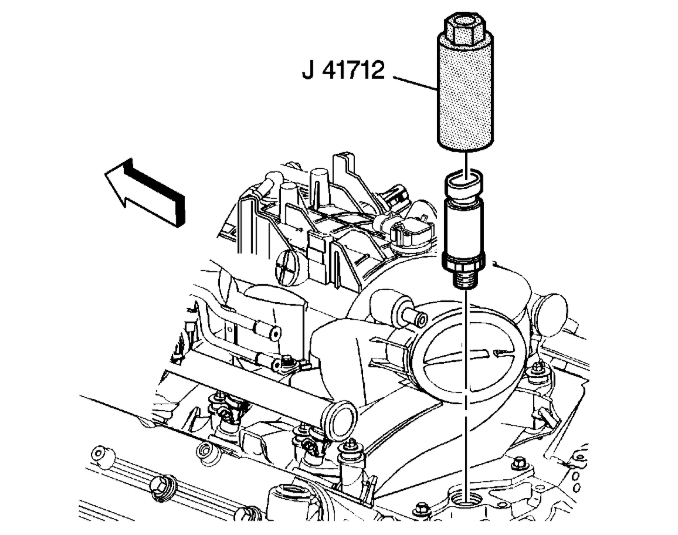

Okay, then the next step is to do a manual oil pressure test to see if it is either a real oil pressure issue or the sender unit is sending a false signal.
Remove the sender unit and insert a manual gauge and crank up the motor and see if it has oil pressure.
