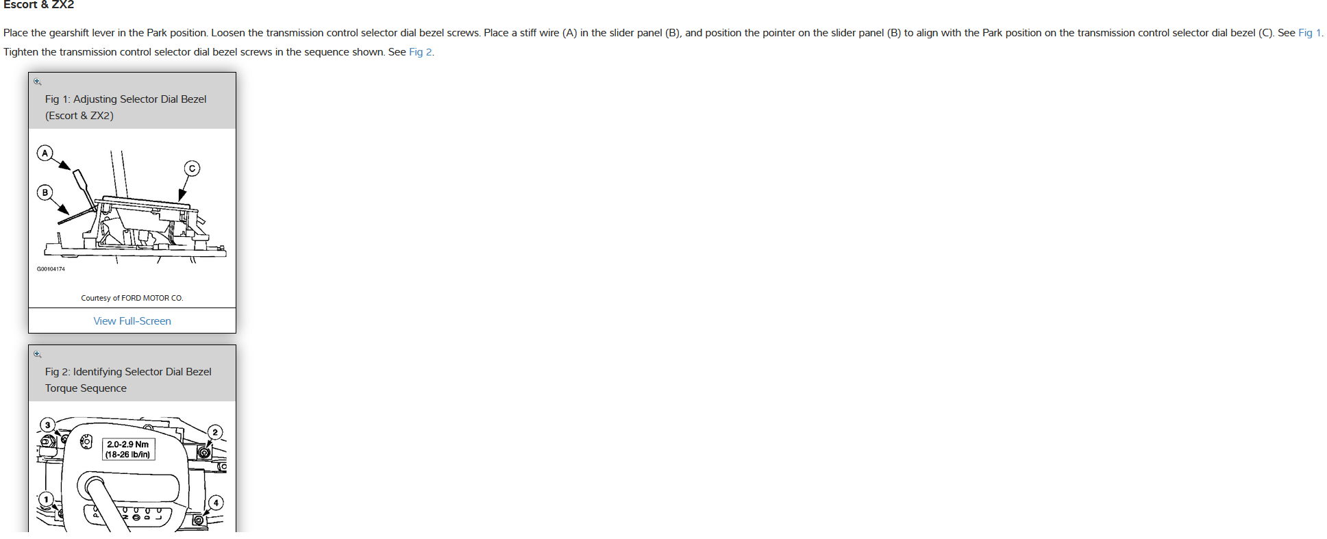

It sounds like your shifter needs to be readjusted. You will find the procedure below.

Adjusting the cable didn't help. so i put the car in reverse right at the transmission and still moved forward. is it possible to have a bad switch?
