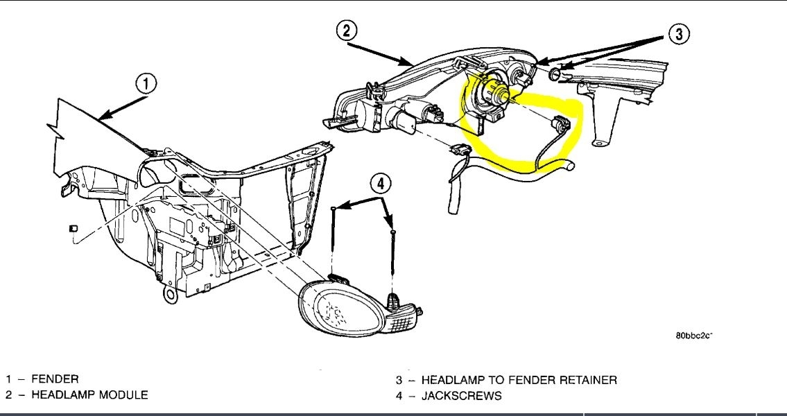

Did you test for power to the headlight with a voltmeter or test light?
Did you replace the headlight bulb?
https://www.2carpros.com/articles/how-to-replace-a-headlight-bulb
I attached a wiring diagram for you to view.

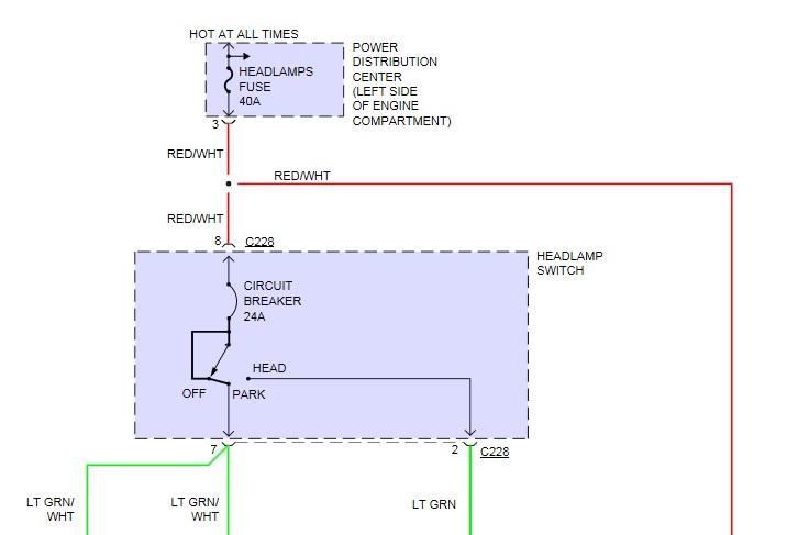

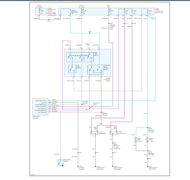

If that smell is electrical, I'd definitely have to check under your dash for any melted wiring, around the fuse box--headlamp switch--everywhere. That could start a fire.
Next check the wiring circuit from head lamp switch. You could check voltage and ground at the head lamp connector.
In the diagram, you can see the head lamp fuse, red wire carries voltage to headlamp switch, when switch is turned on, the green wire carries voltage to dimmer switch. I'd have to check those circuits. Go from there
