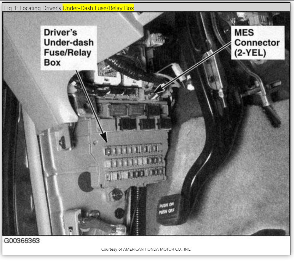

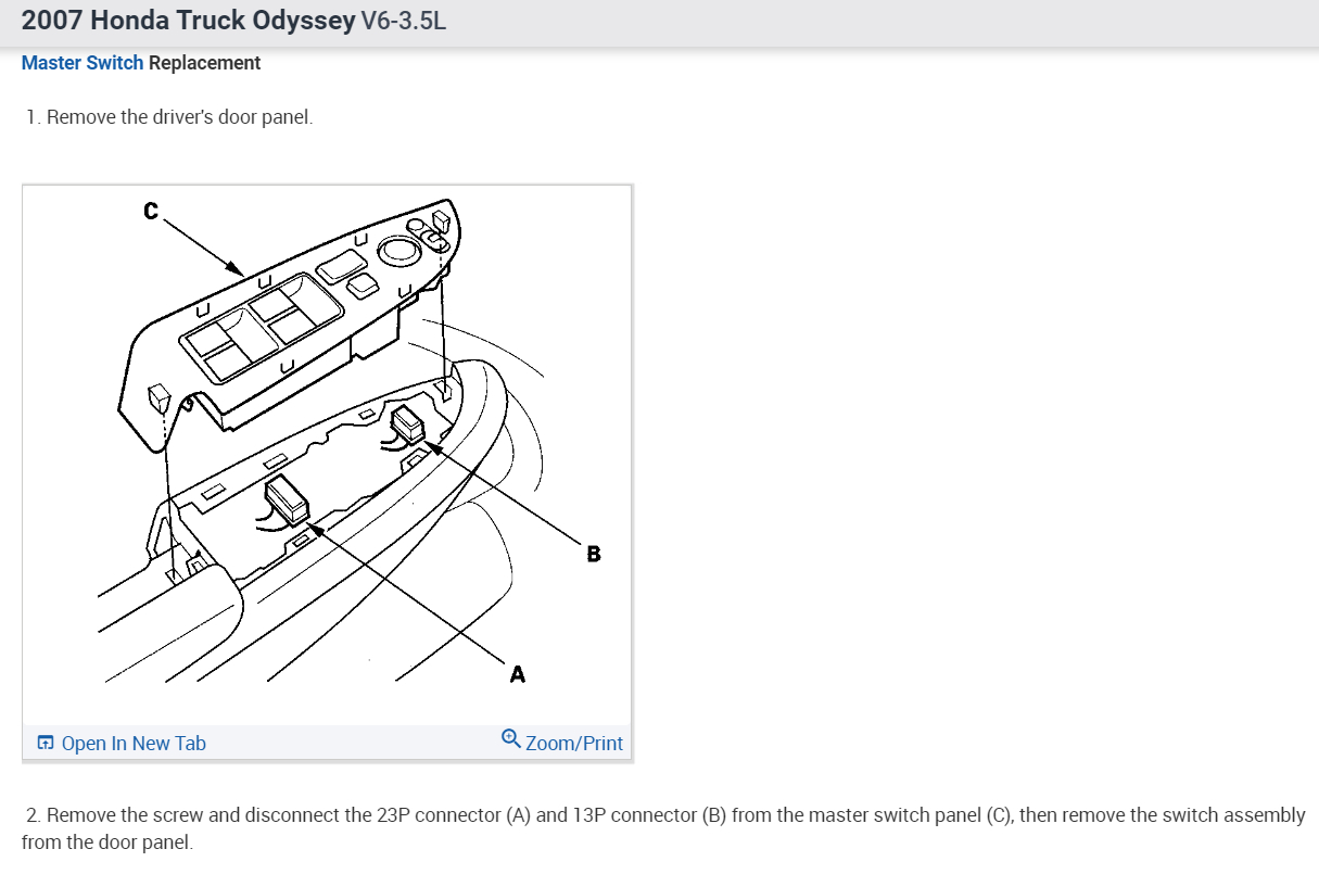

So, it first started off I tried to get the three windows working that weren’t working. The only window that was working was the driver side, so I pulled his switch out and I took a paper clip, and I started touching each terminal and what I did was touch too hot together And I got a spark now all of a sudden, the windows are working, but not the high beams. No turn signals, no wipers. help.
Aug 22, 2023 at 9:16 AM

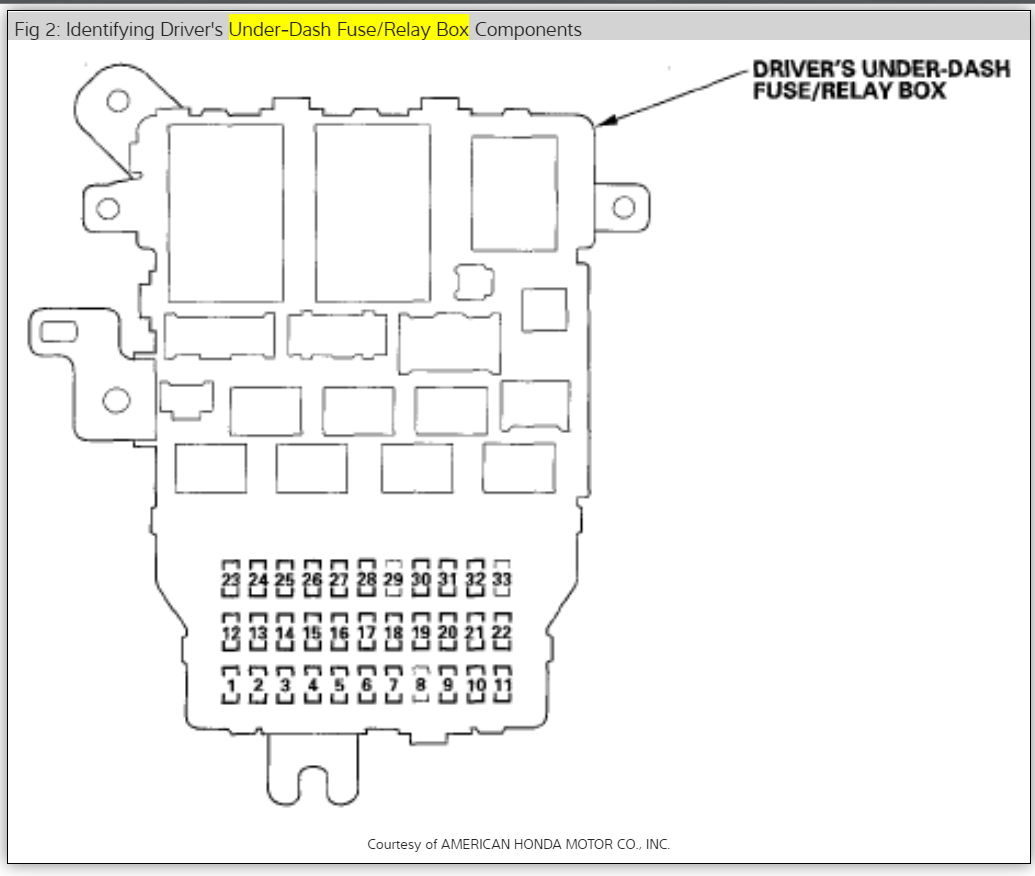

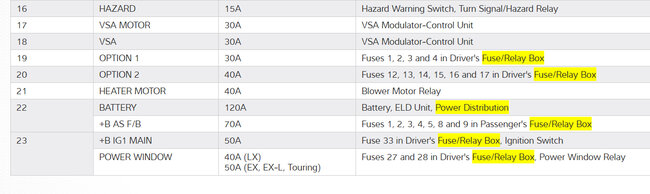

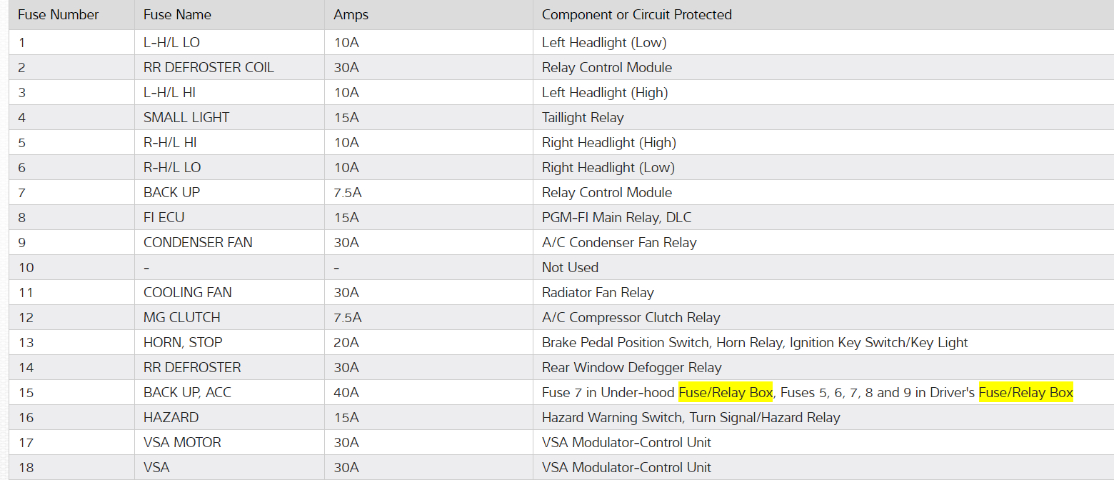

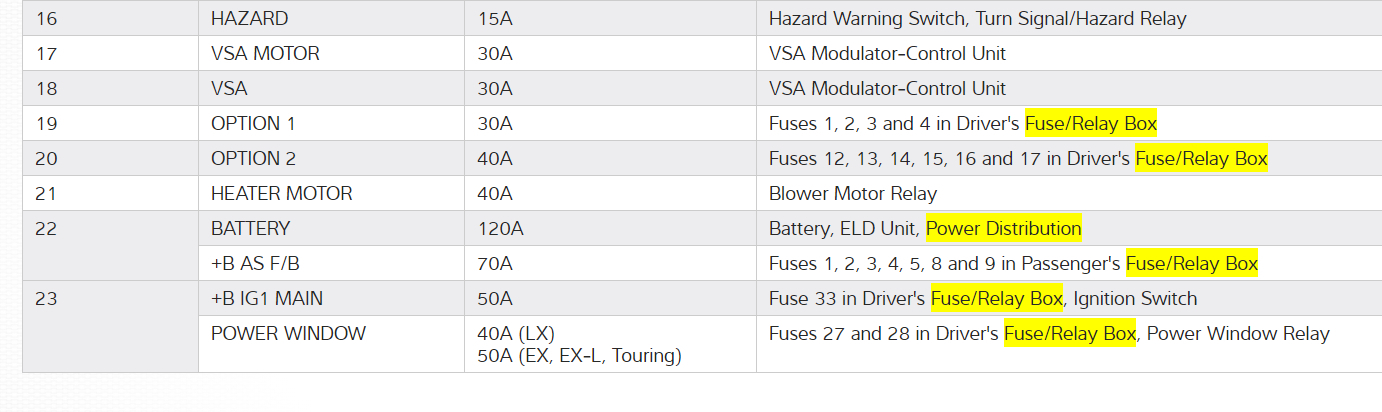

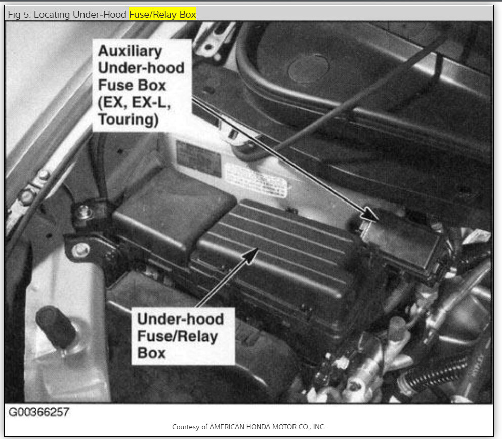

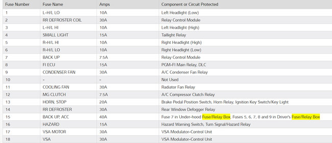

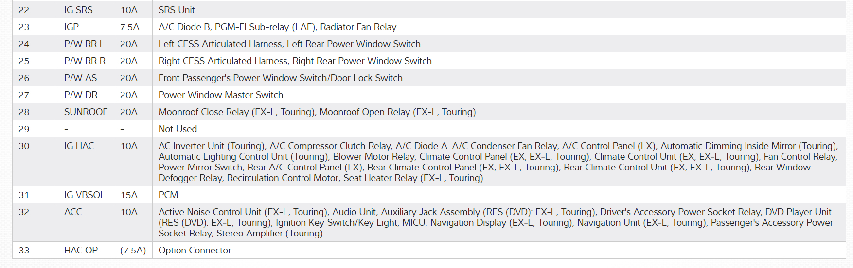

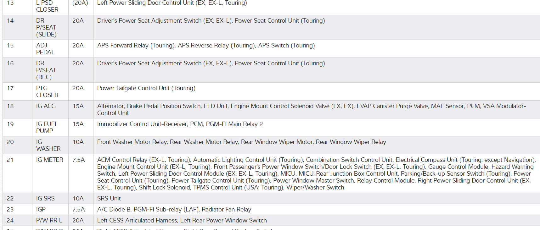

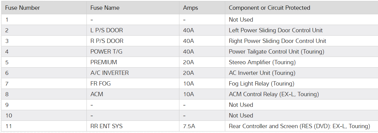

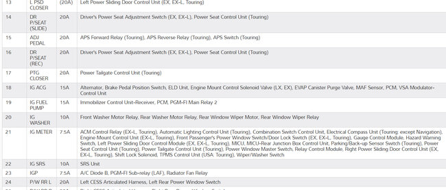

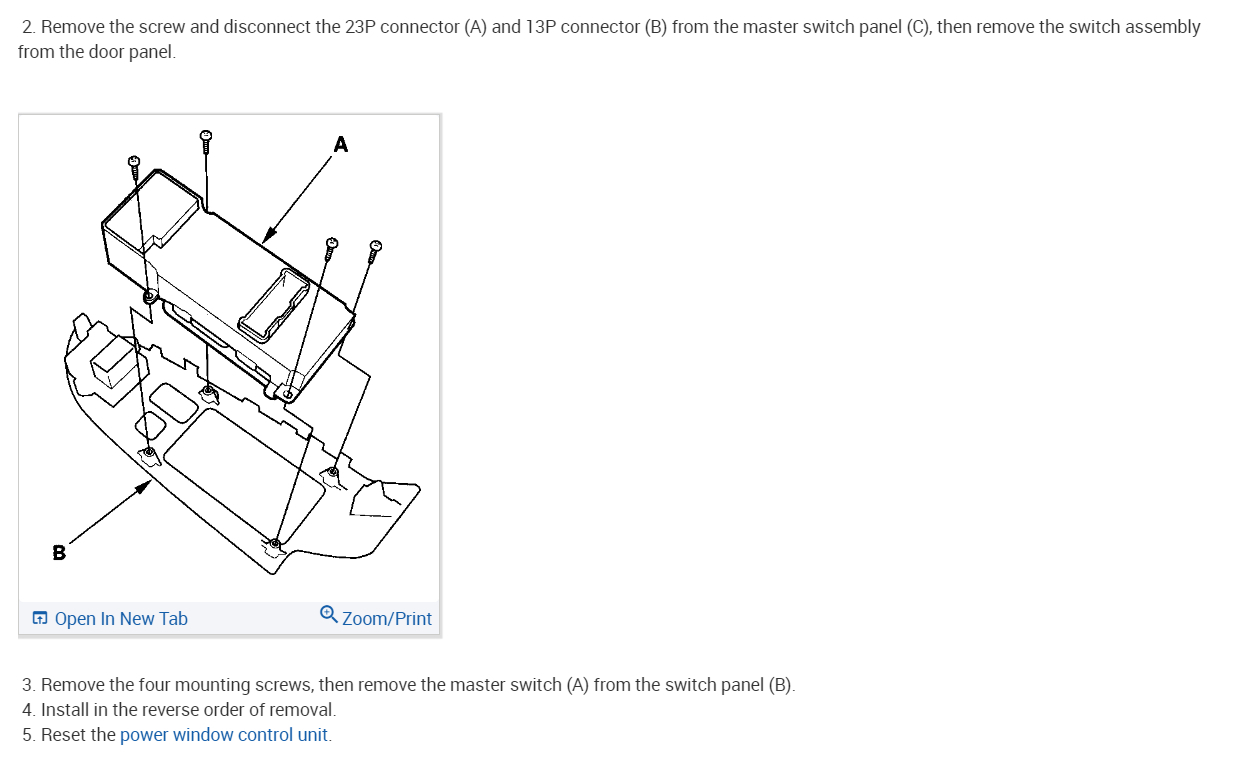

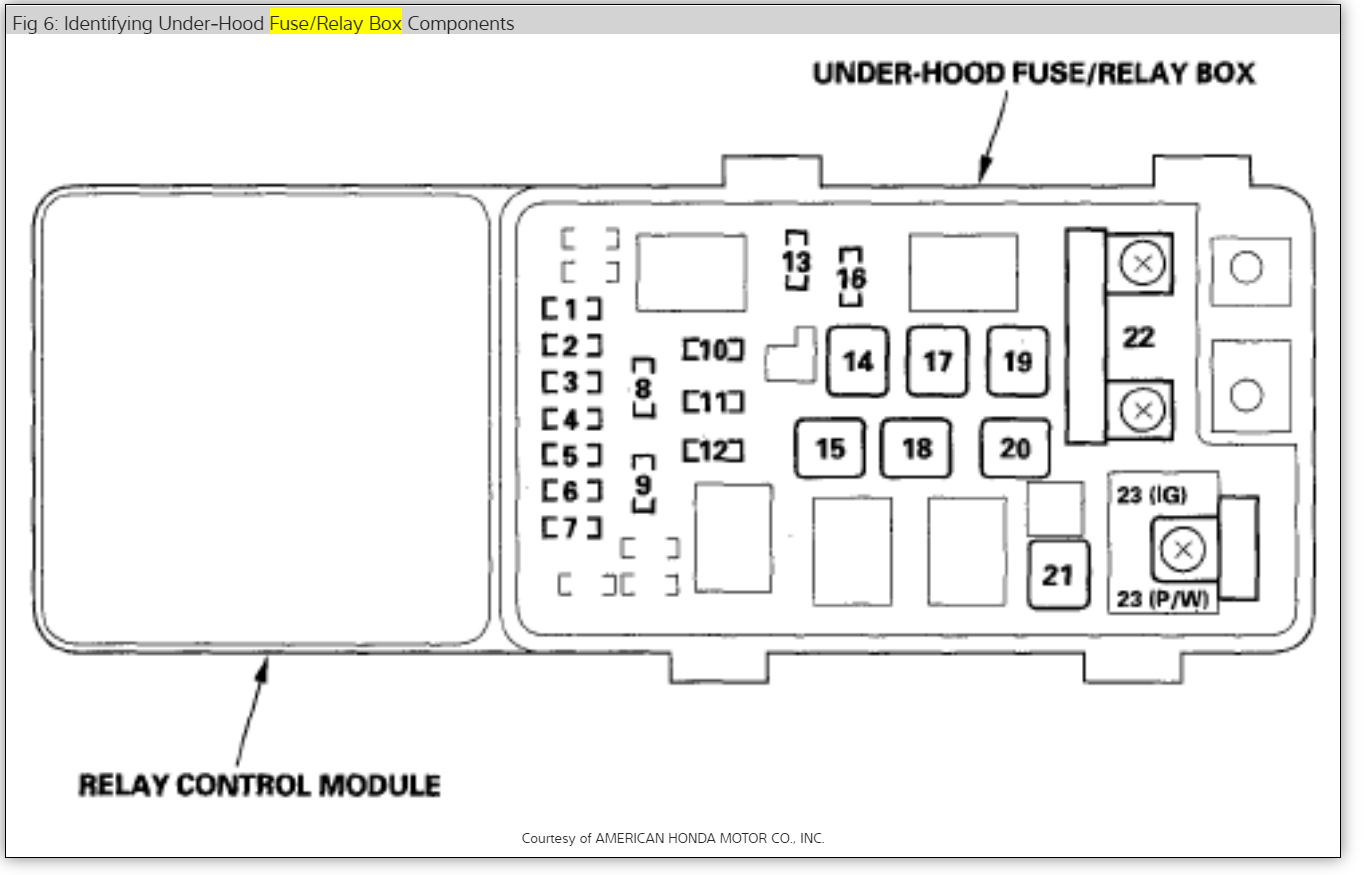

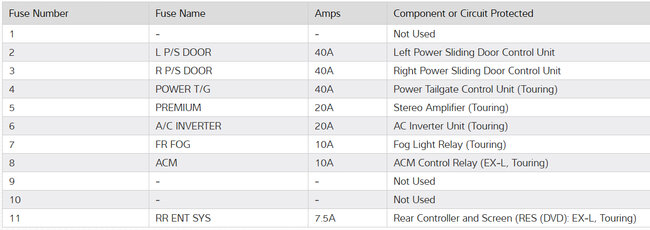

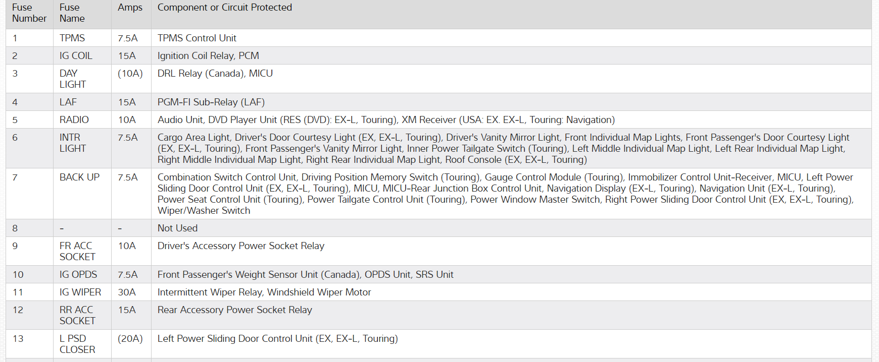

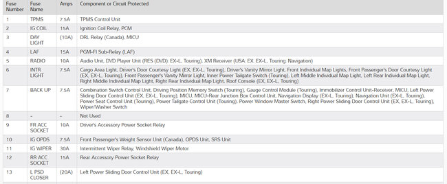

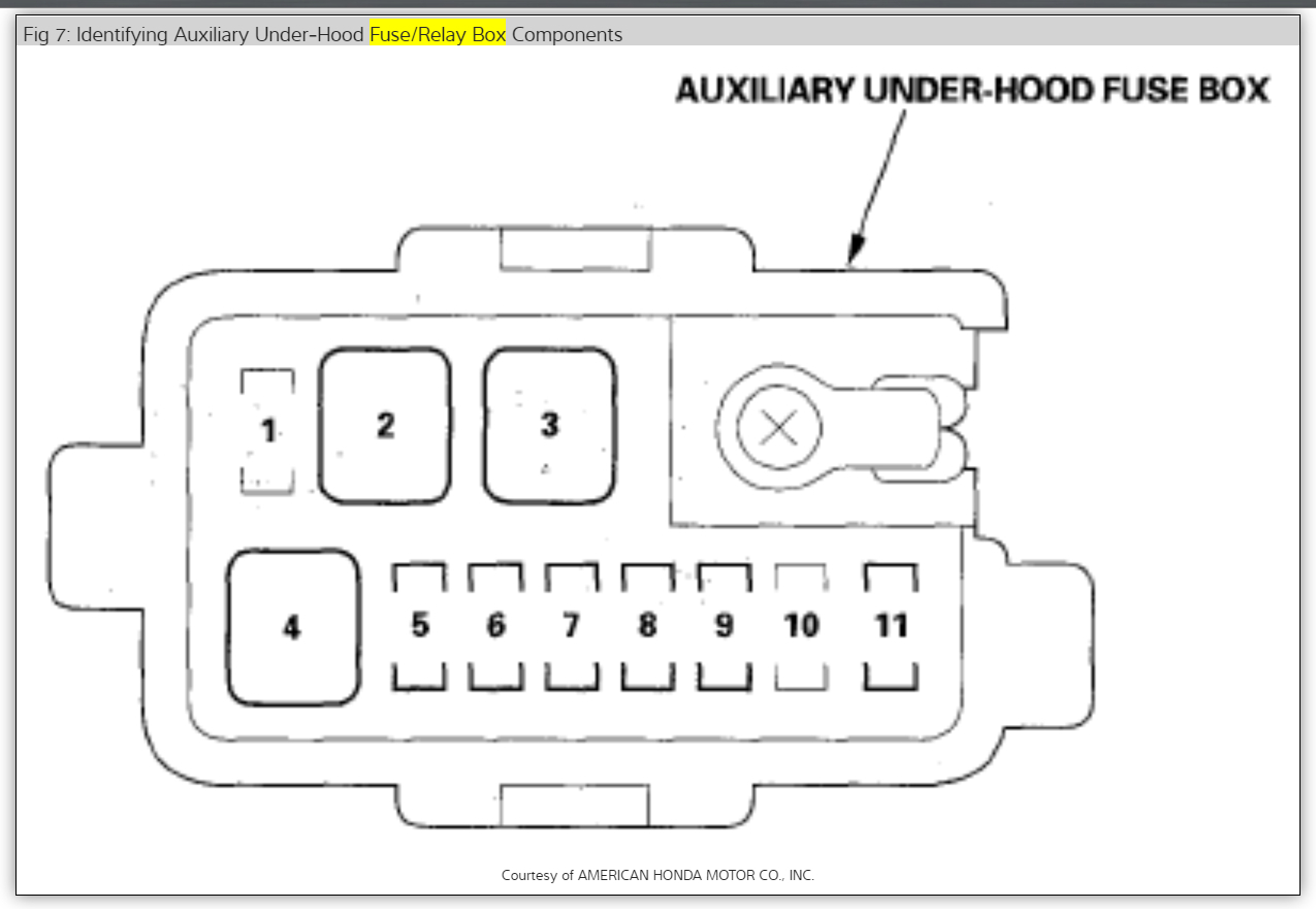

It sounds like the main window switch needs to be replaced, but you need to check all fuses, here is a guide to help and the fuse locations to help:
Check out the images (below). Let us know what happens and please upload pictures or videos of the problem so we can see what's going on.
