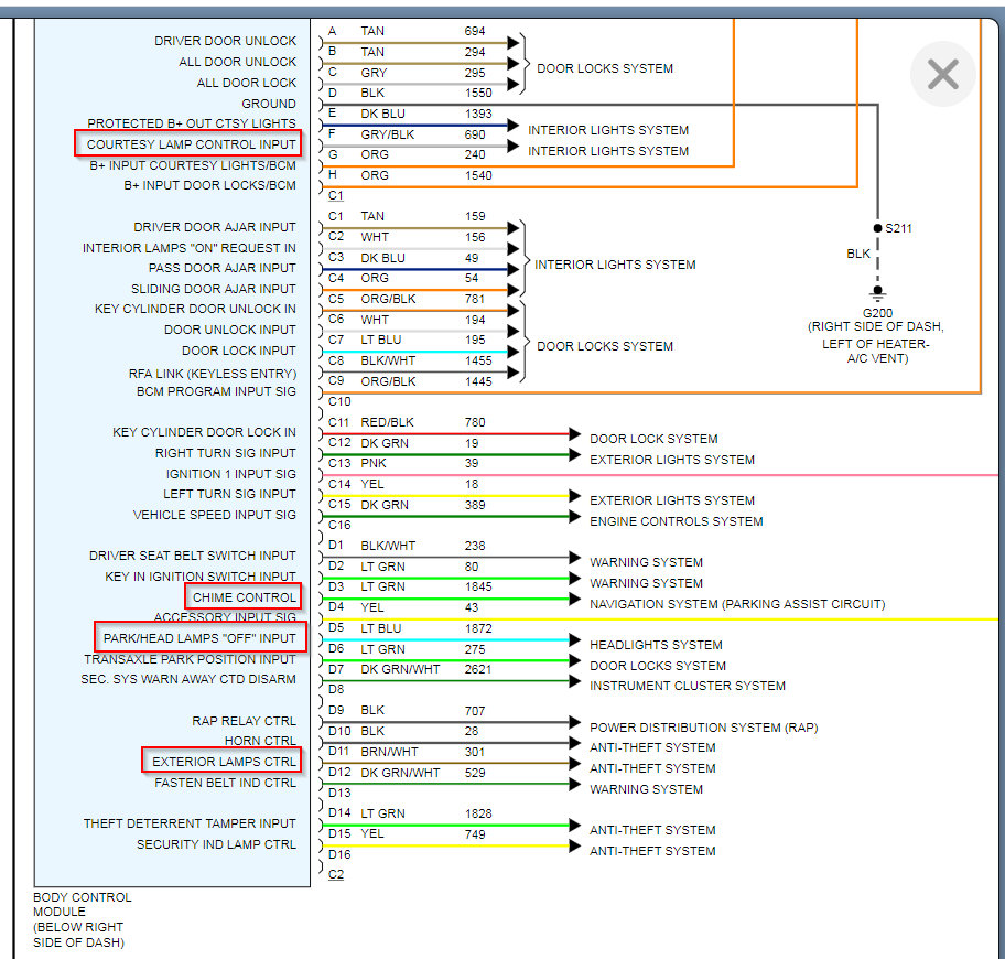

Okay. Then the only thing that would make sense is the BCM is malfunctioning. Take a look at this wiring diagram. The way to confirm this is to measure voltage on the highlighted circuits when you are operating the lights. However, the rapid chime is what is pointing me here the most because that is solely controlled by the BCM.
Jul 3, 2020 at 7:00 PM
