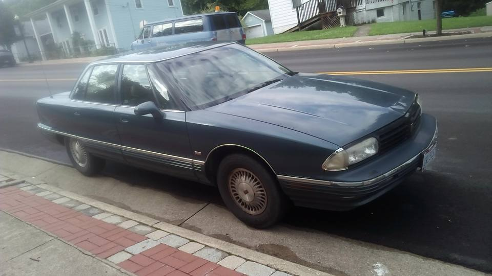

over the summer i lost the keys to my car. well my husband thought he could just remove my ignition and shove and screwdriver where the key goes and my car would then start. well he did not realize the chip in the key would stop all this from my car running. so now that i desperately need my car we have no money to replace the steering column or get a new key and ignition we need to know how to disable or completely remove the vats system or pass-key two to start my car (hot wire) until i can actually get it fixed the correct way. so if there is a way to disable this without the key it would be greatly appreciated to know how. thank you
