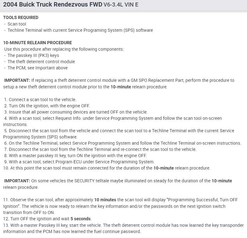

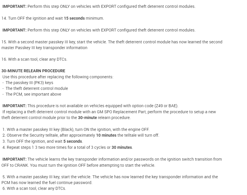

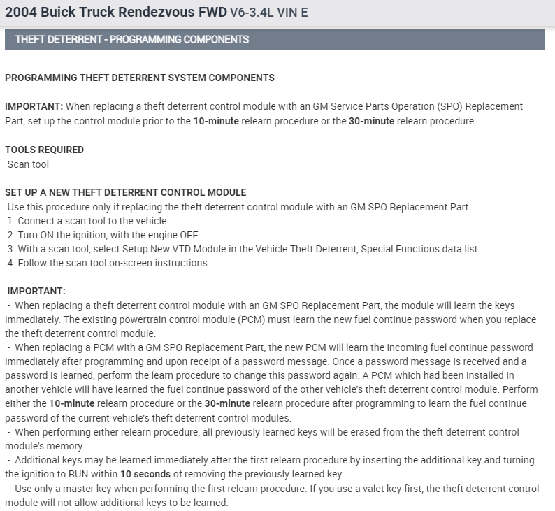

If you do not have a original key available, you will have to program the new key to the vehicle in order for it to function properly.
To do that programming it will require a key programming capable scan tool.
https://www.2carpros.com/articles/how-to-reset-a-security-system
I have attached the programming procedure below.
