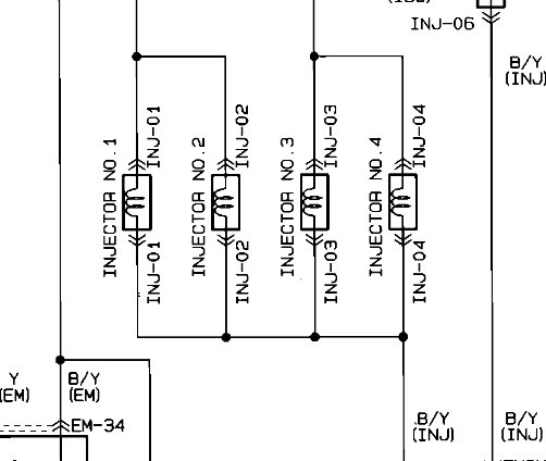

Truck will start if I feed it gas, but the injectors do not pulse. I was wondering if you could start me on what I need to check?

I would start by verifying power to the injectors with the key on.
If you do, then you need to use a test light on the other wire and back probe it while cranking. it should flash. that will tell you if the PCM is turning the injector on and off.

can you tell me which wires to check?

Okay.
the black yellow wire is the one that needs battery voltage. check it with key on. the other wire is the one that needs to flash while cranking.

The black and yellow doves have full voltage when the key is on, but the other wire does not flash when you spend the engine over. what should I check next? thank you very much.
