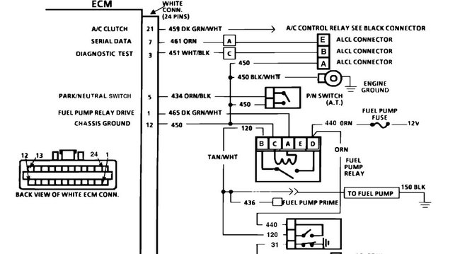

The ECM has its own ground. It does not need one from the battery. There is nowhere to mount a ground wire from the battery to the ECM.

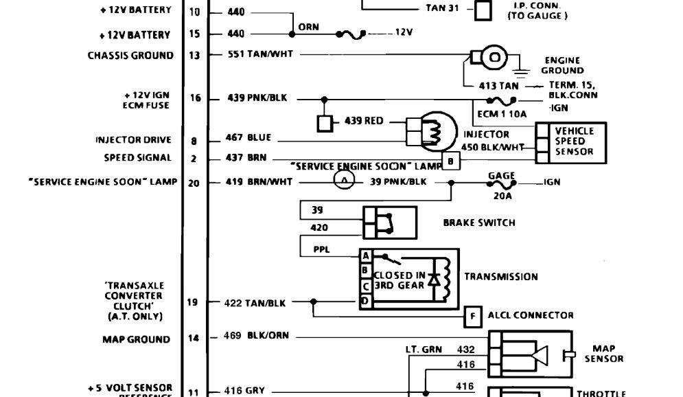

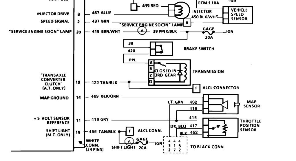

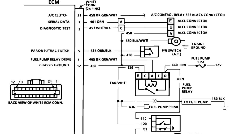

I attached a pin-out of the ECM for you to view. Let me know if you want to do some wiring checks for the injectors.
