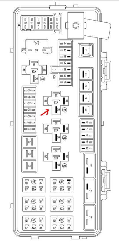

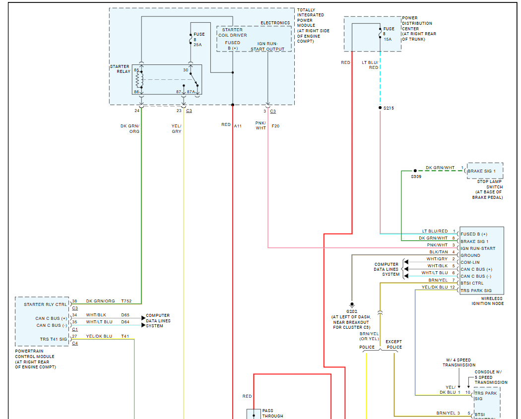

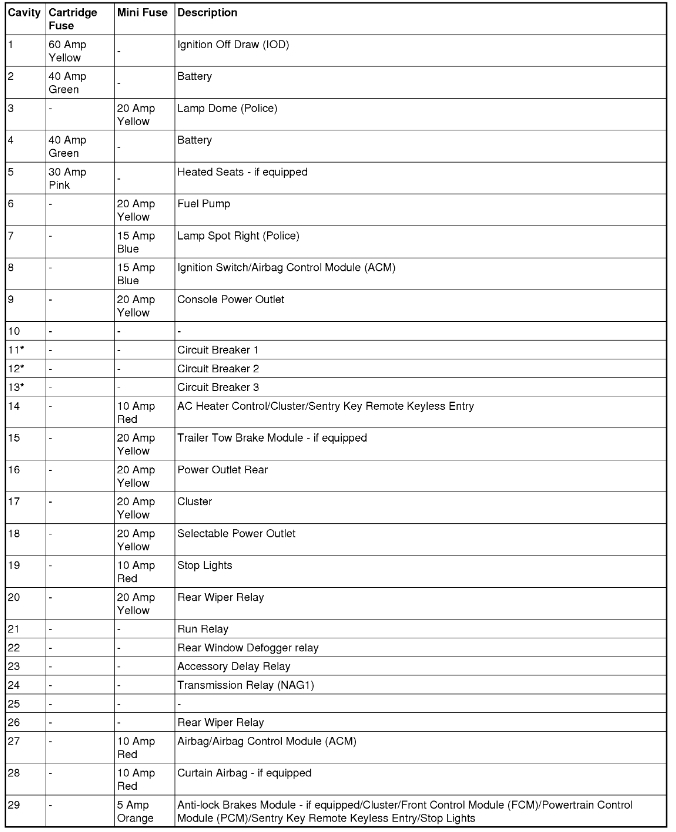

Dash won’t turn on with key on run position. Please I would like to know the ignition relay location, also will like to have the modules block diagram. Diagram for the key switch. I have no communication with all modules.
Does this model have a gateway?
