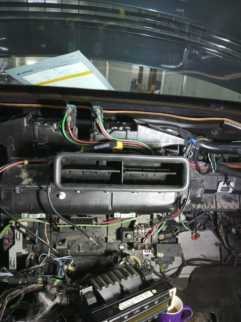

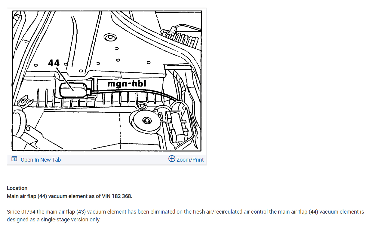

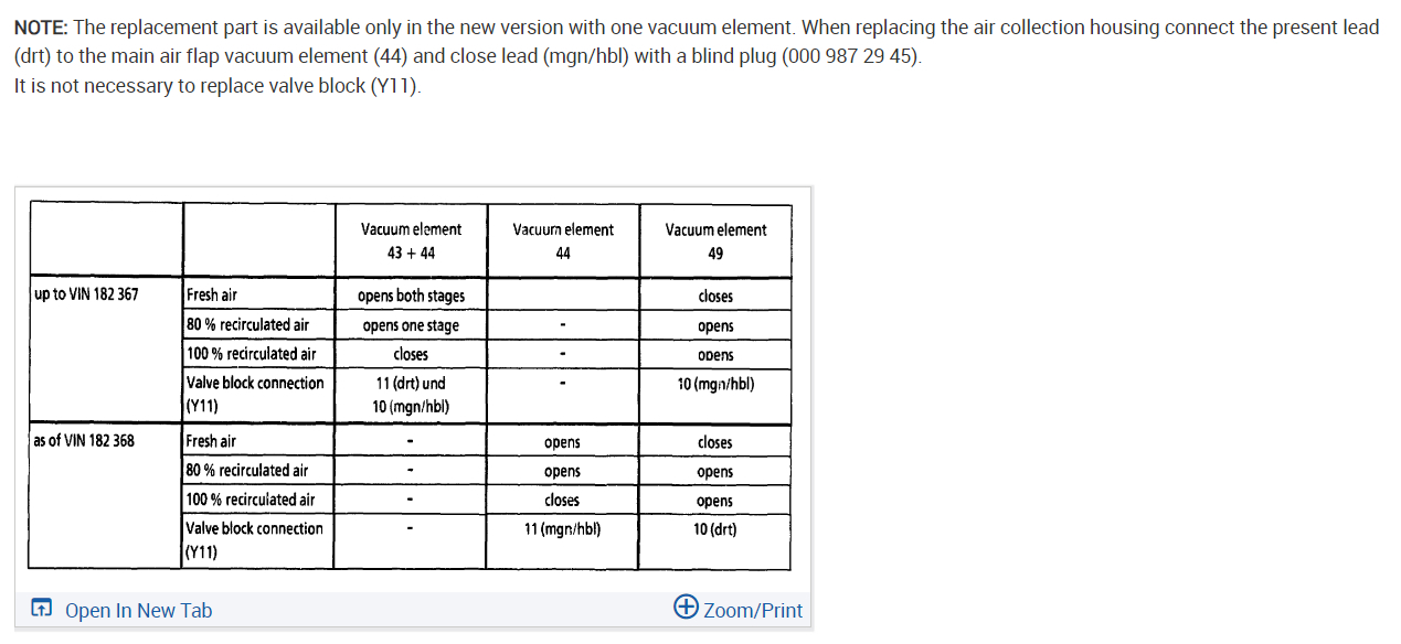

replace entire heater assembly, but hot air does not come out of center dashboard heater vent. left and right vents a working but hot air flow is not optimum level.
Work history: bypassed heater control valve and directly connected hose to the water pump. The other 2 hoses are closed by using stopper.
Looking forward for some suggestions.
