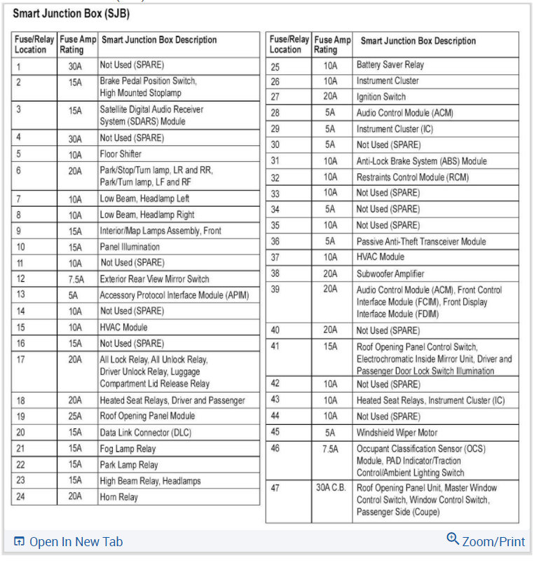

Horn does not work. I replaced the fuse and tried a brand new horn, but still not working. What to do now?

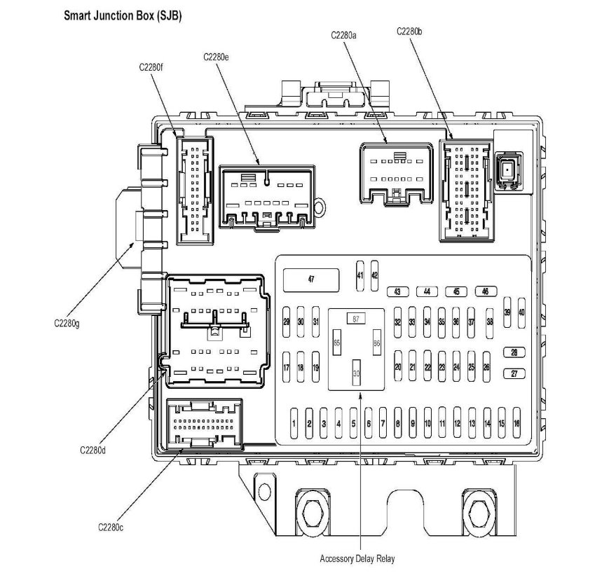

try a new horn relay located in the smart junction box (#24). It is located near the steering wheel under the front of the dash. Here is a guide to help check it with the location of the relay in the diagrams below.
Check out the diagrams (Below). Please let us know what happens.
