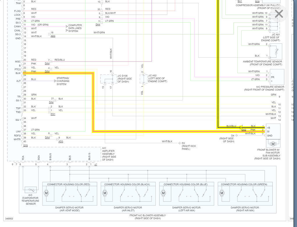

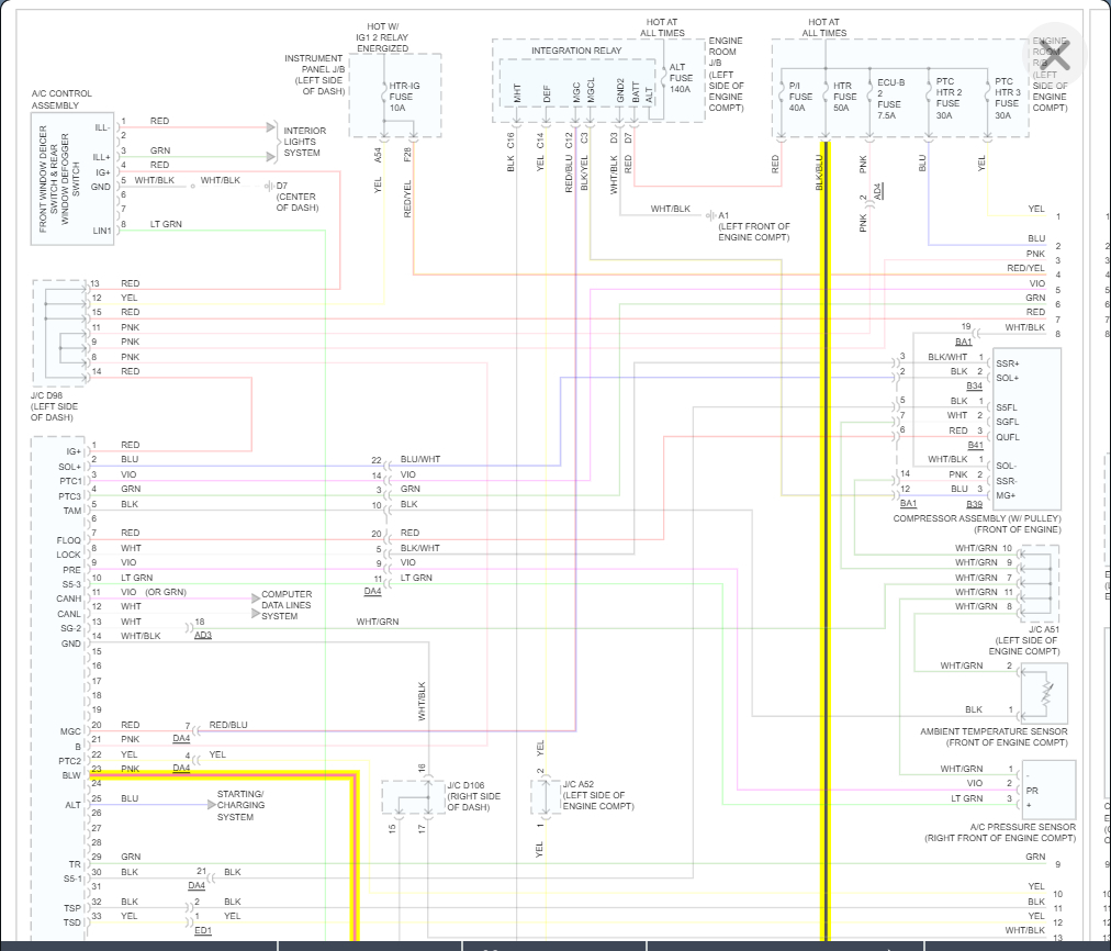

I think this is an aftermarket parts listing issue. The 2011 front blower does not have a separate resistor/control module.
This is controlled internally by the AC amplifier.
https://www.2carpros.com/articles/blower-fan-motor-works-on-high-speed-only
So, if the blower is not operating on high then we need to check the voltage at the blower motor. If you have 12 volts, then the blower motor is the issue. If you do not have 12-volts on the high setting, then we need to most likely replace the amplifier which contains the control module.

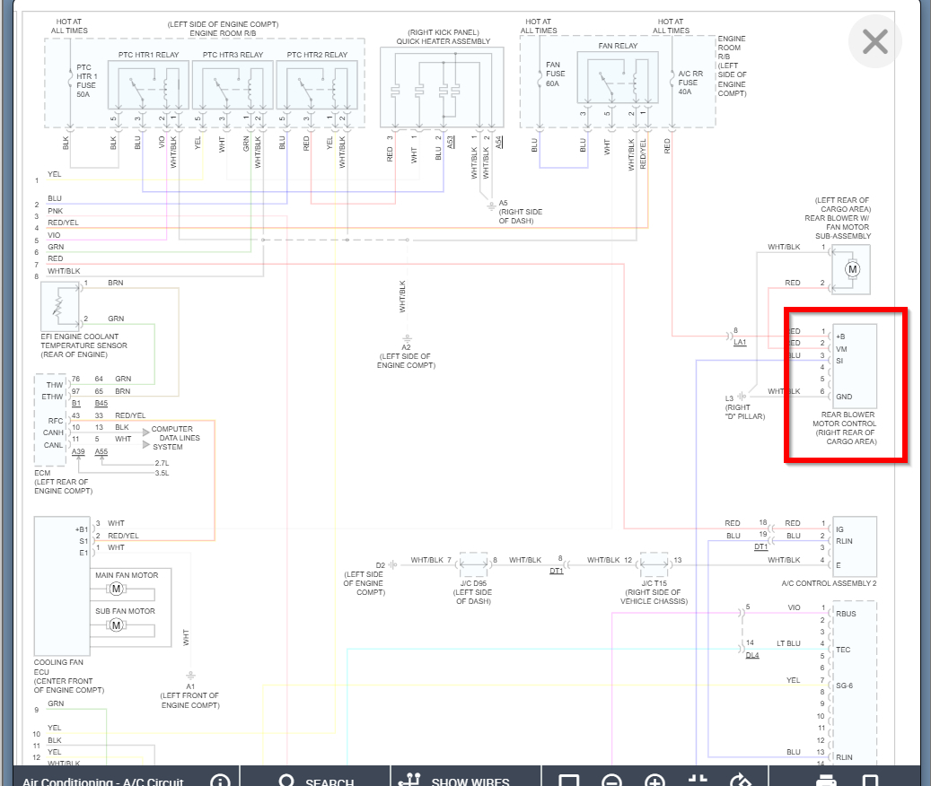

I am attaching the wiring diagram below which shows this. The rear blower has an external control module which I highlighted.
Let me know the part number of the resistor that you have, and we can confirm this.
