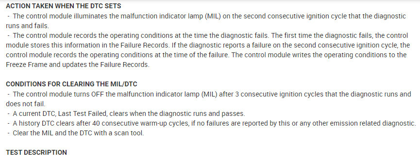

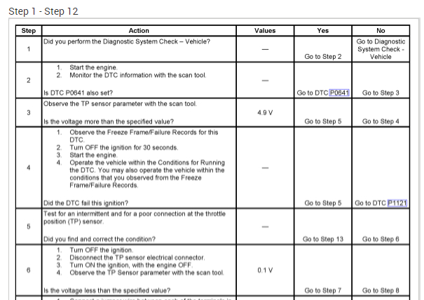

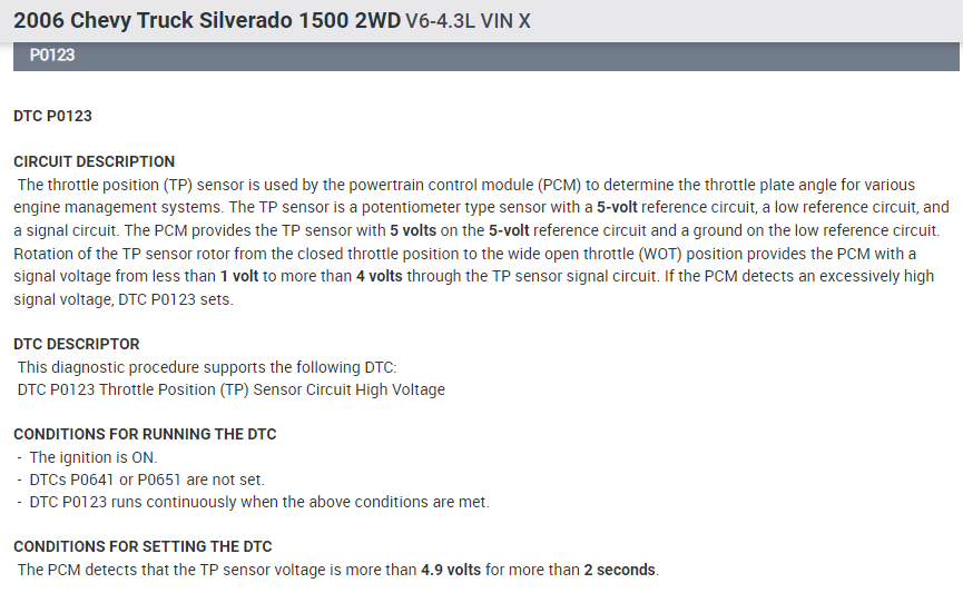

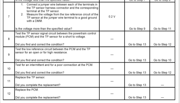

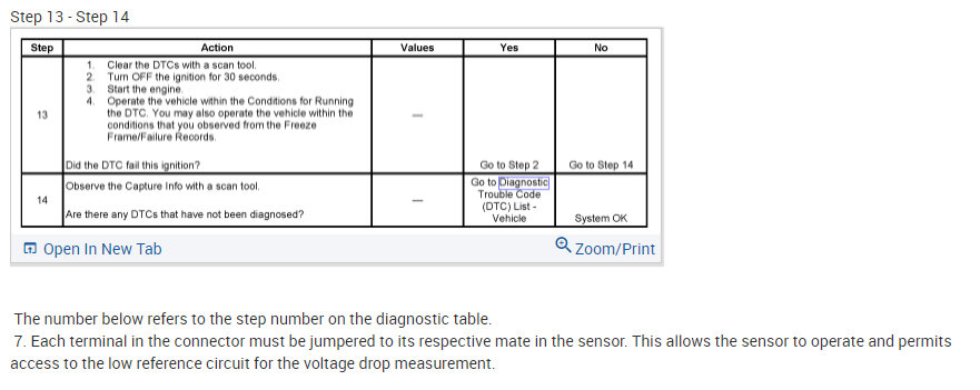

Here is the information you requested. Here is a tutorial showing how to test electrical wiring:
I've attached below picture diagnostic steps for the code P0123 relating to the throttle position sensor. This is like a flowchart for diagnosing this code in its entirety. Let us know what you find and we'll go from there. Hope this helps and thanks for using 2CarPros.
