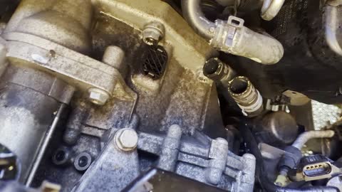

Update, please see video.
The weirdest thing about this, is when I squeeze the top radiator hose, the coolant tank surges accordingly...ish,
It looks like a previous owner has added radweld at some point, I've only had the car 18months, and have only added coolant, but did notice the slightly brownish tint to the coolant in the tank and confirmed by horrid white gravel/gel stuff when taken the pump and thermostat off.
Though strangely, not much on the pump side, but loads on the thermostat side?

Yep, you are onto something with the thermostat, I would replace it and the problem should go away. Thanks for the video it helps. Have a good weekend and let me know what happens.

In the video, the dual thermostat is off the engine and all coolant pipes that could be accessed were flushed with hosepipe until completely clear, then move on to next pipe until all run clear in all directions.
I even started the engine with the thermostat off, and coolant tank stayed full, no drain down at all.
Aaahh well, the car is booked in to a garage from tomorrow, we know them well, and it should be done by next weekend.
Thank you to all who replied, I will update with news of anything found or end result.
