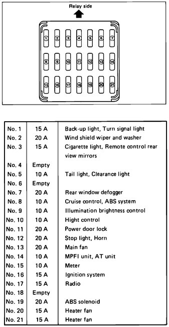

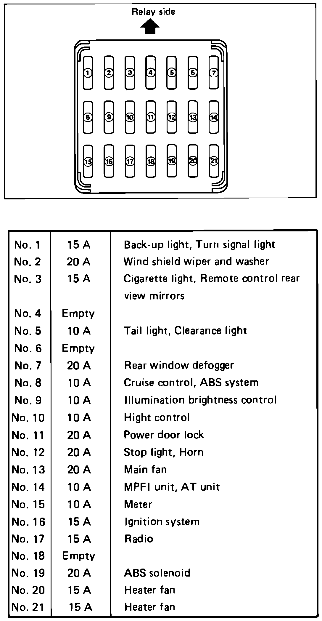

Before you remove the motor, check fuses. Check both fuse 20 and 21 in the passenger compartment fuse box. I attached a list of what each fuse is for as well as the layout of the fuse panel.

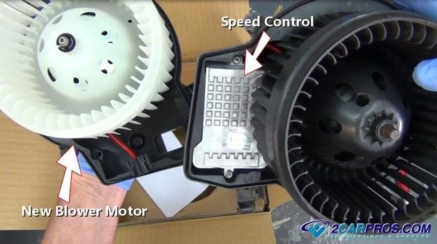

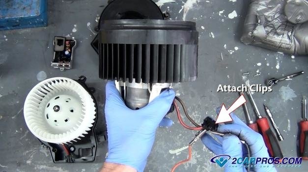

Honestly, often times, the motor is separate from the fan itself. You should be able to remove the fan itself from the motor and reinstall it on the new motor. I attached two pictures for you to see. Look closely at the center of the fan. You can see on this motor there is a clip that holds the fan blade on the motor. It can be removed. See if your design is similar.
