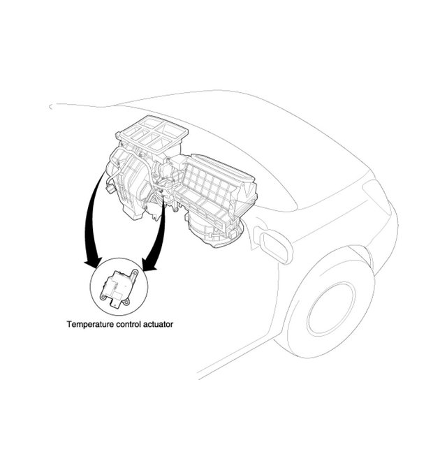

Remove the lower trim panel on the drivers side. Look up onto the - passenger - side of the HVAC box and the actuator is screwed on with three screws above the air duct. The drivers side unit will be the first one you see the passenger control is on the opposite side but in the same general location on the box.

From what the factory info shows you can get to that actuator from the drivers side, Not sure I believe it but that is what the book says. Like I said, Kia tends to be somewhat difficult when it comes to service information on some models.
I have seen the 2007 video on replacing the blend actuator and that heater case looks a lot like what they show for the 2009. I just went and compared the factory information on both the 2007 and 2009. It shows the same pictures and removal information for both. Which must be wrong as this video shows the removal in an 2007 and the instructions do not match how to get there.

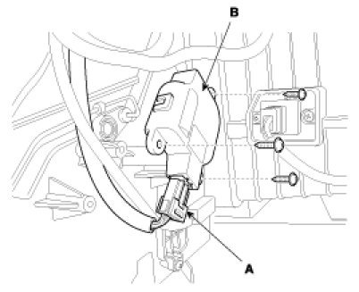

These are the factory instructions for removing the passenger side actuator on both years.
Disconnect the negative (-) battery terminal.
Remove the driver's crush pad lower panel.
Disconnect the temperature control actuator connector (A) after removing the air duct.
Loosen the mounting screw and then remove the temperature control actuator (B).
