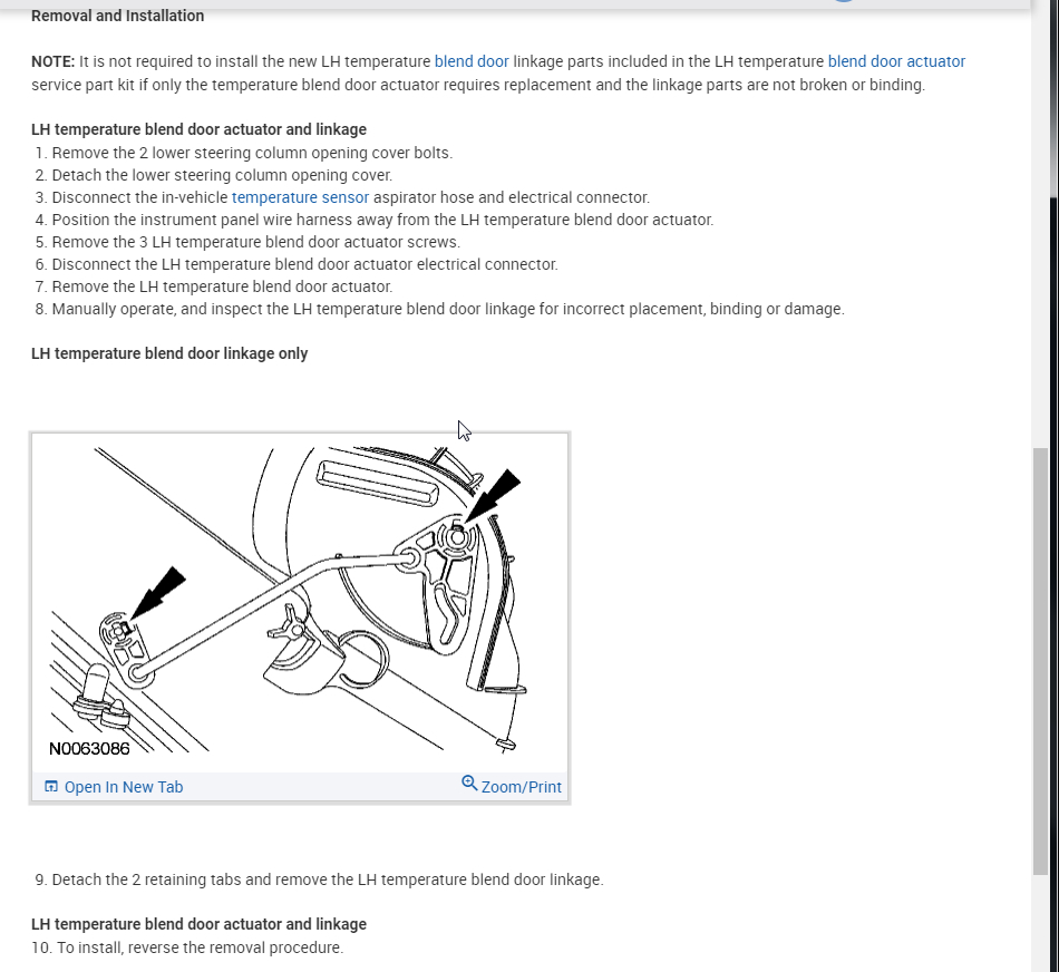

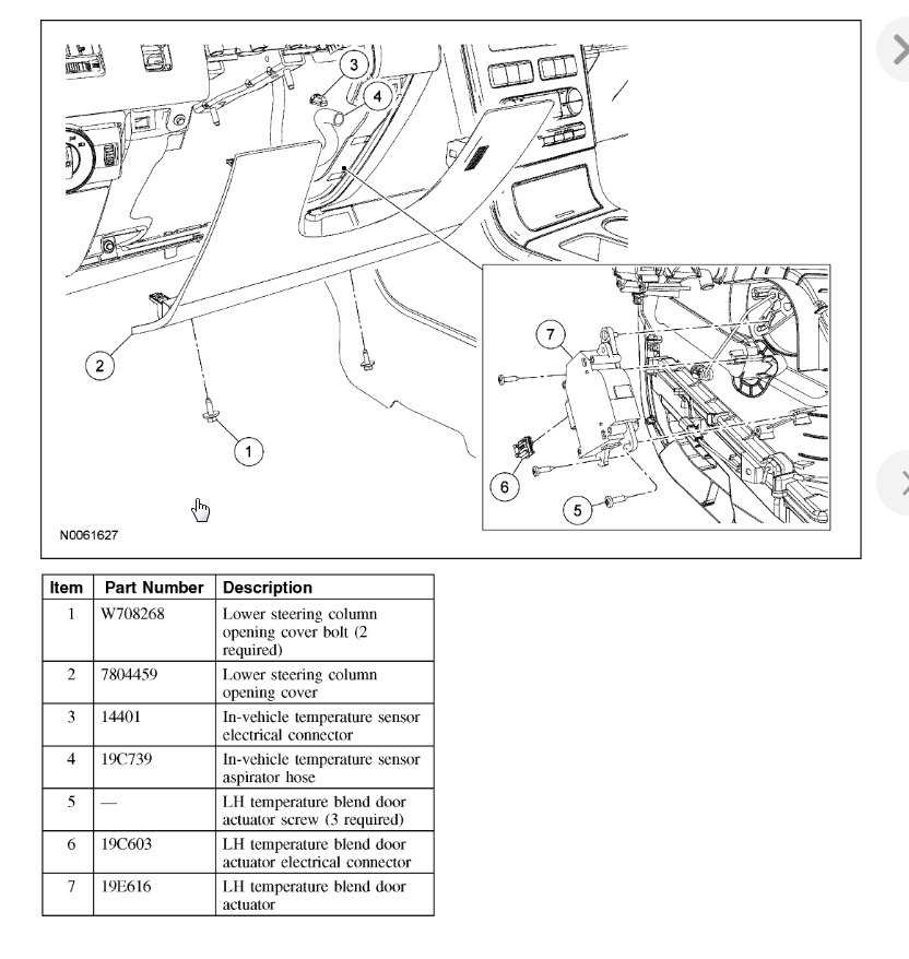

Driver side does not blow hot air when heater on. Passenger side is fine.
I was told it was a Evaporator case issue and it would cost 1700 to fix. Some code was given for the error and they say it is the reason it is cold on one side.
Is that right? I am thinking an actuator/. Any help or advice?
