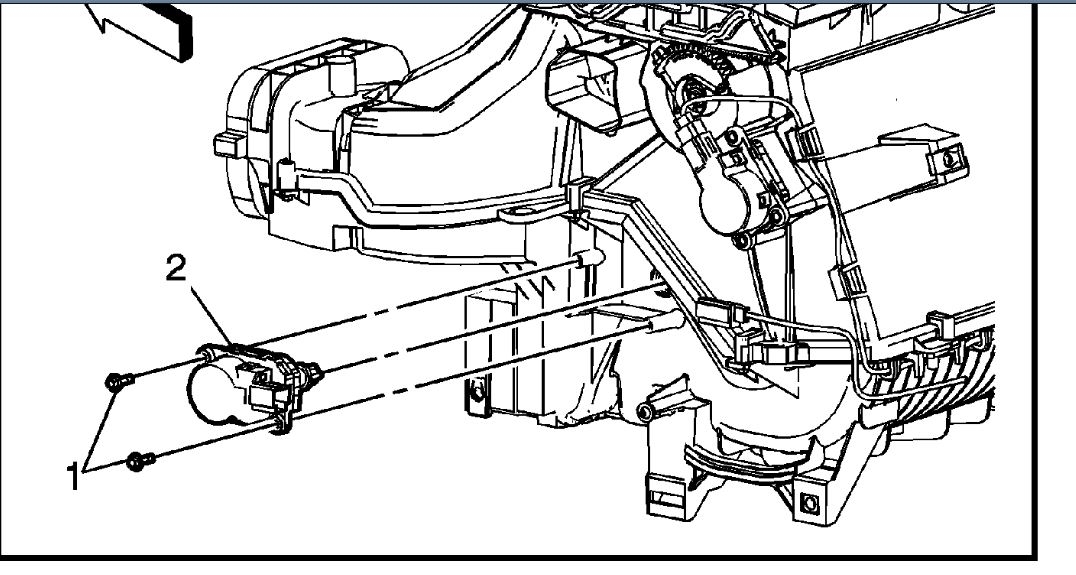

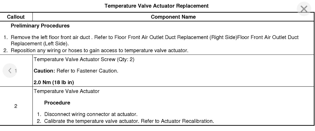

Good afternoon,
I attached a picture of the location and the procedure for you.

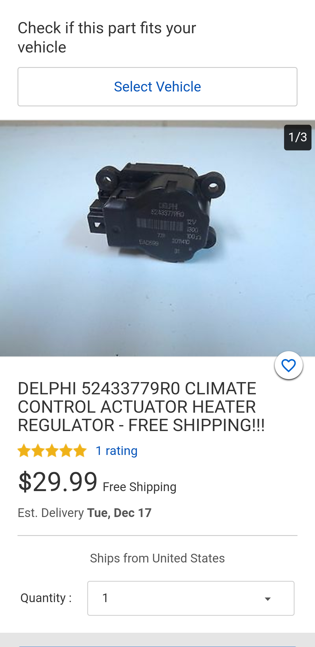

Is it the climate control actuator heater regulator? Part number 52433779R0? That is the one I changed .

The mode and the blend door are the same. You need to verify the location in the diagram I sent you as to whether you change the correct one.

The one they sent had different numbers then the one I removed. The one I removed is in the screenshot I uploaded so I wondered if I need this one instead? It is located in the diagram you sent.
Dec 7, 2019 at 1:44 PM
As I stated, both are the same. They operate and mount the same.
Can you hear the door move when you command heat and cold from the control panel? Put your hand on the actuator and see if it moves when commanded.

Okay, to calibrate.
1. Remove the fuse for the HVAC system. Wait 20 seconds
2. install the fuse.
3. turn on the key. wait 30 seconds. You should hear the doors move back and forth a couple of times.
Then start the car, let it get hot and see if you have heat.

Changed the one in your spec sheet but was different numbers than the one in the picture i sent.
