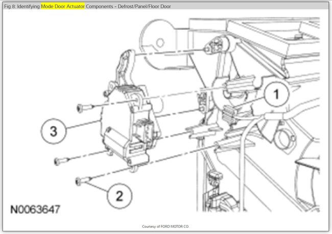

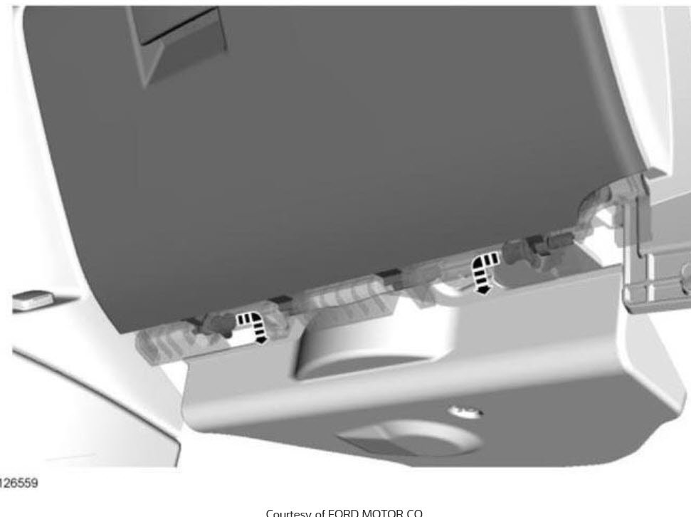

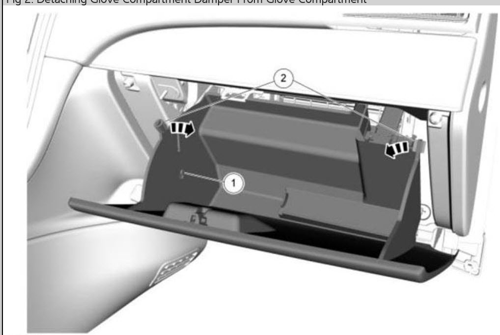

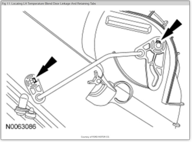

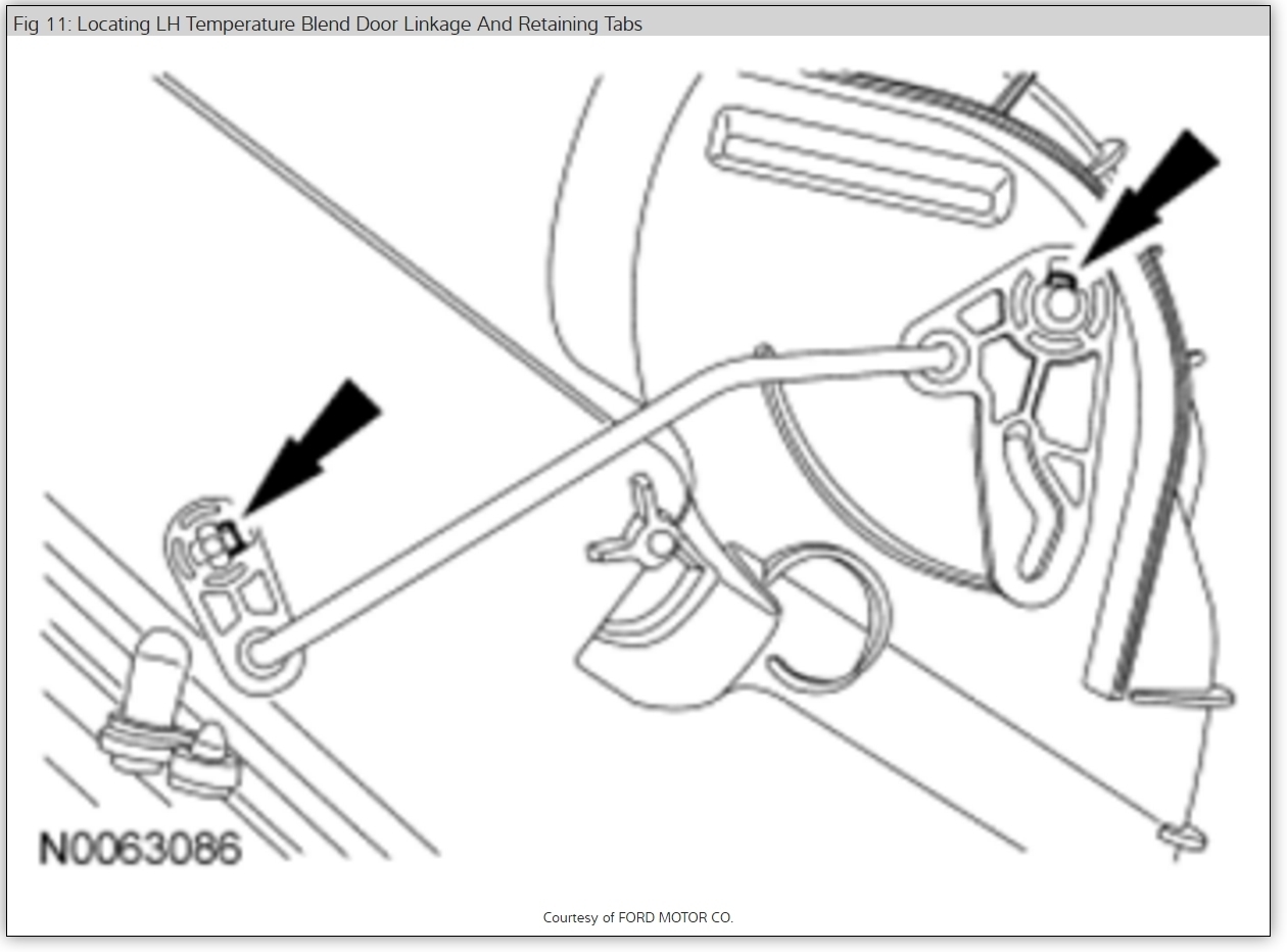

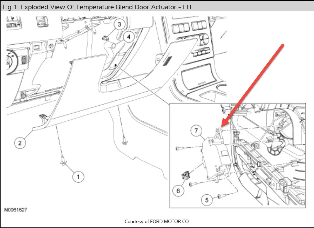

then if it's auto temp control where you set temp it has to be scanned for codes by a mechanic otherwise you 'll need to see If blend door is getting power or not. Are both heater hoses hot? actuator is below dash behind glove box see pics.

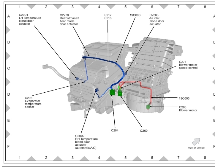

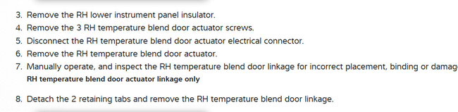

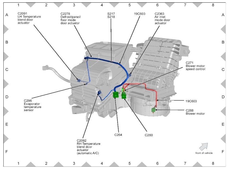

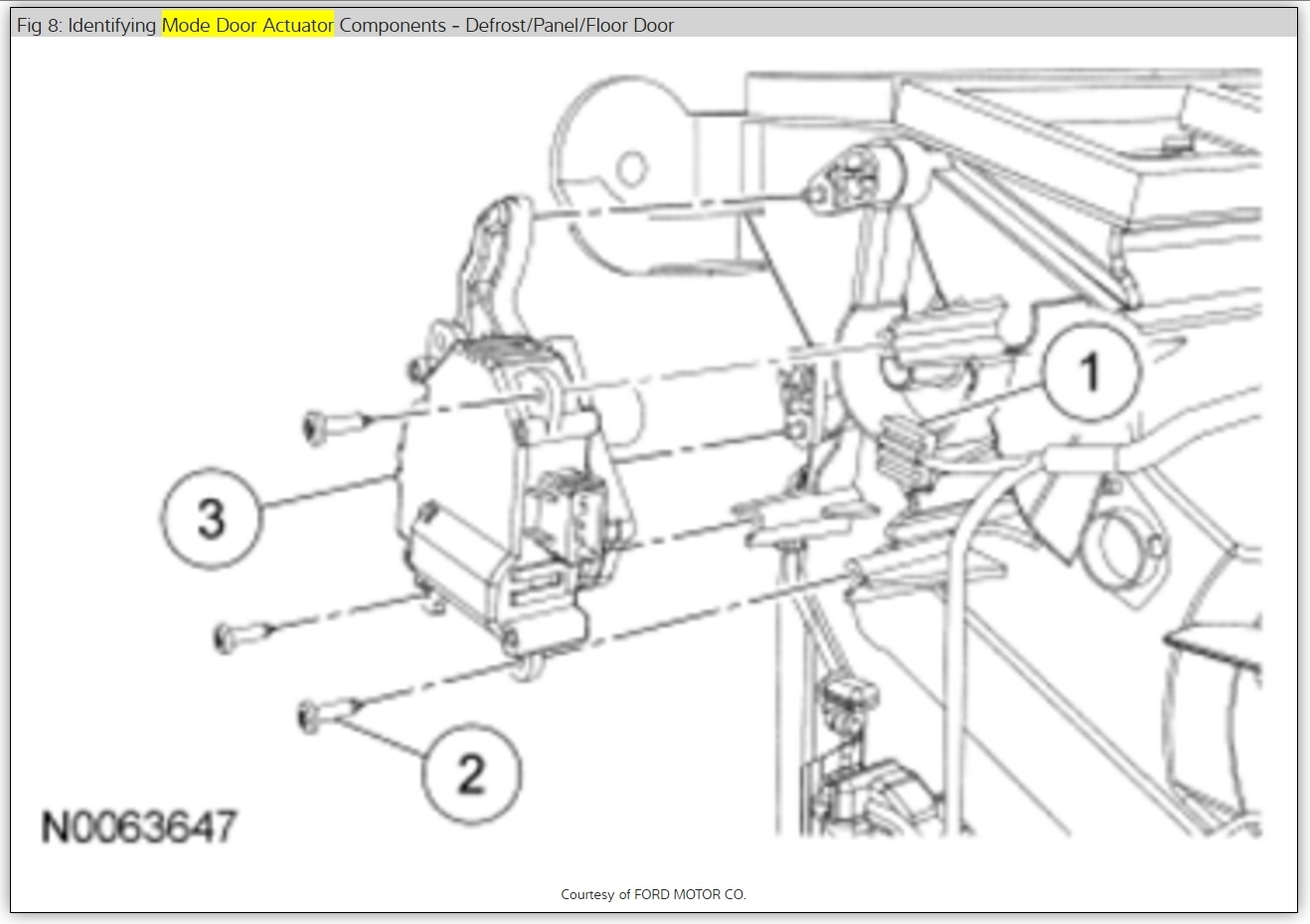

Hey JORGESEBA,
Do you hear any noise from under the dash little clicking? It sounds like it is a blend door actuator.
Here is a guide and diagrams of what the problem could be.
Please let us know happens so it will help others.
Best, Ken

Information was helpful, had the blend door replace by a auto shop with parts and labor for $150.00. the dealership wanted to get me for $350.00 to $1,000.00

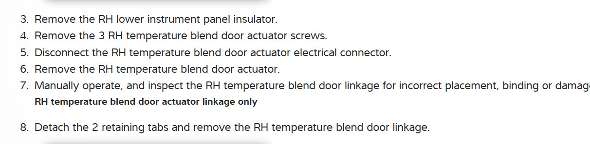

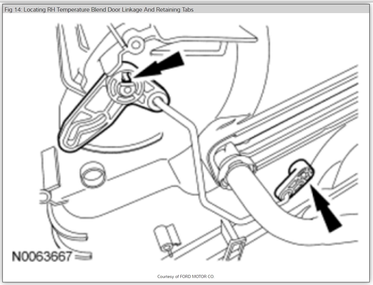

Drivers side vents and heat are blowing cool air. Passenger side blows nice and warm as it should. No dual controls, one side.
Feb 6, 2019 at 12:38 PM (Merged)
HMAC300
  • 48,601 POSTS
try pulling fuses 37 and 15 in smart junction box with key on for 60 seconds then reinstall. It may reset actuators . if that doesn't work your temp actuator for drivers side may be bad.
