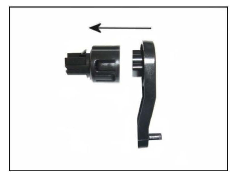

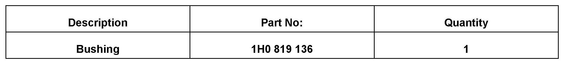

I was able to find a technical service bulletin (TSB) related to temperature issues. Its focus is on the blend door actuator. Take a look through it. All attached pictures correlate with the TSB.
The blend door control lever moves freely, but the blend door does not operate.

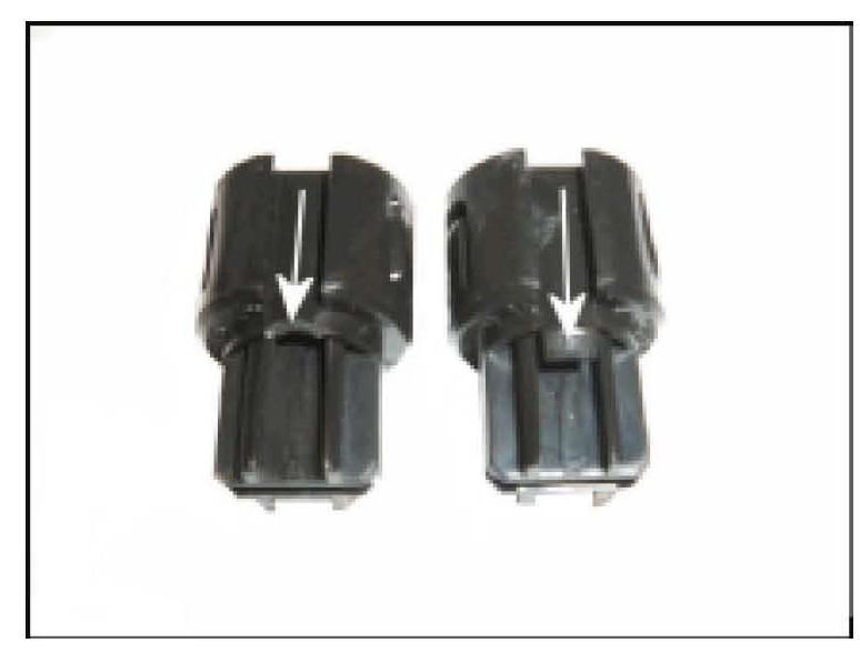

A bushing that fits on the lever may have a broken tab/clip, -arrows-, as shown.
This tab/clip may cause the bushing to fall out of the fresh air housing which can result in the door becoming inoperative and result in undesired air temperature.
Tip:
In the past the entire fresh air housing was replaced because the bushing was not available as a separate part. The bushing is now available as a separate part. The bushing can be accessed from under the center console.

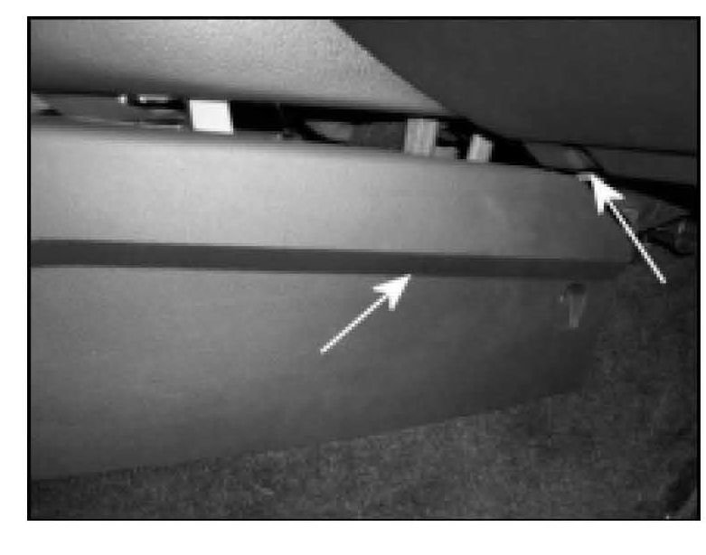

^ Remove the panels near the foot wells at the passenger side of the console, -arrows-, as shown.
See Repair Manual, Body-Interior, Repair Group 68 - Interior Equipment for removal procedure.

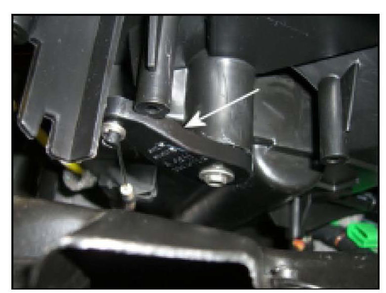

^ This will expose the location of the control lever, -arrow-, as shown.
^ Re-bolt a new bushing onto the lever, -arrow-, as shown.

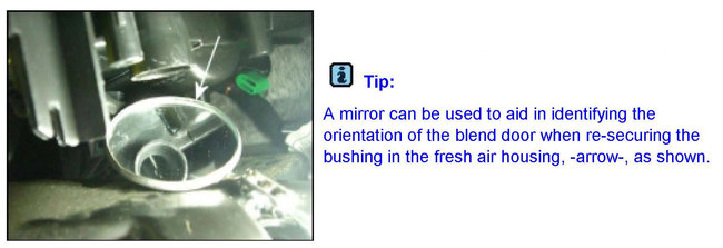

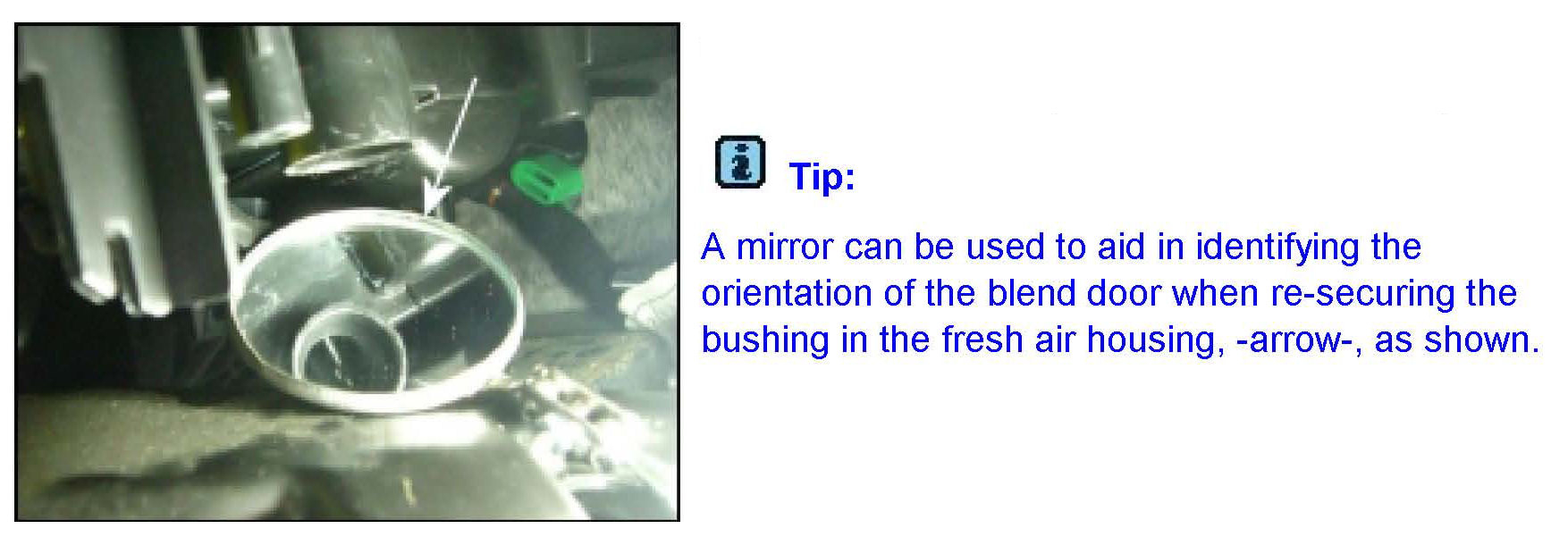

^ Re-insert the bushing with lever onto the blend door until it is firmly secured in the housing.

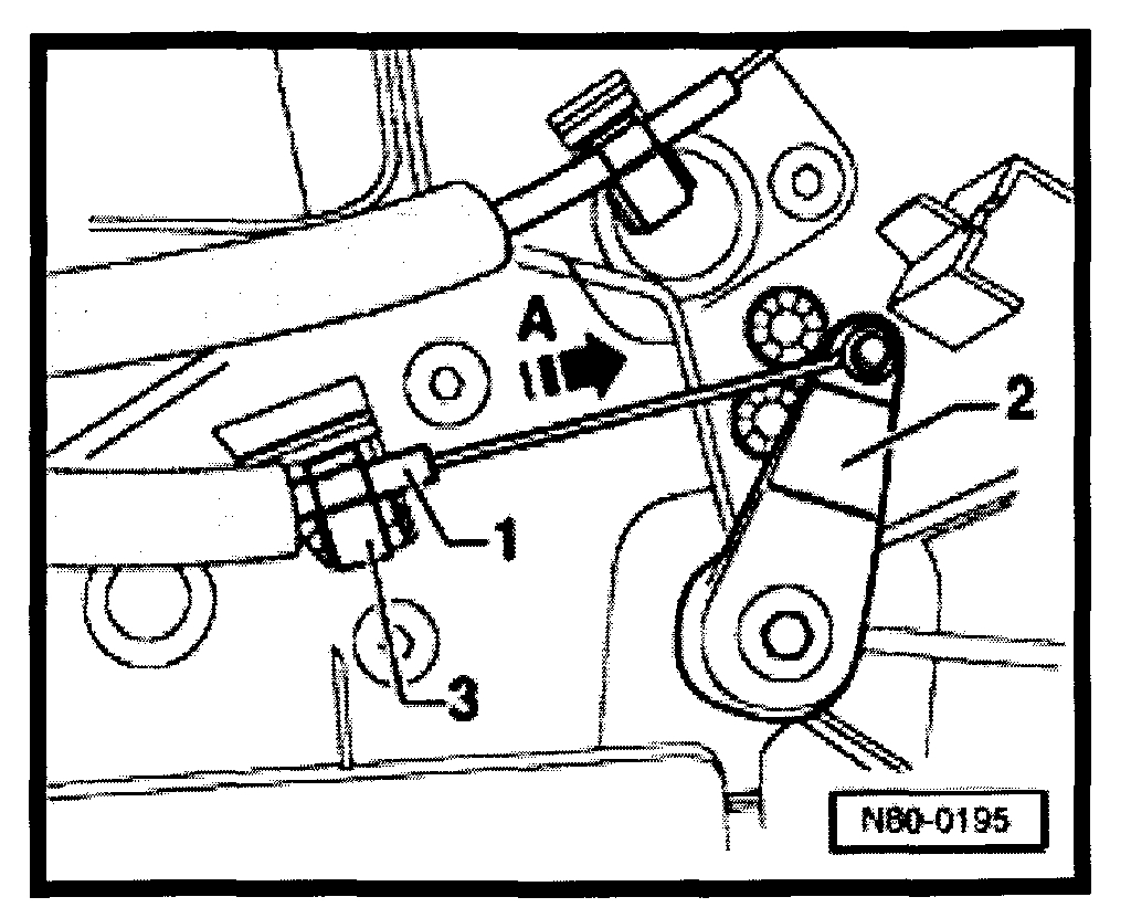

I was also able to find how to adjust the cable. Picture 7 correlates with these directions,
TEMPERATURE FLAP CABLE, INSTALLING AND ADJUSTING
Cables, Installing And Adjusting
Temperature flap cable, installing and adjusting
Prerequisites:
-Heating and ventilation controls are installed.
-Connecting duct removed.
Adjusting
-Turn temperature rotary control knob to left onto stop.
-Attach center wire of cable -1- to the temperature flap lever -2-.
-Push temperature flap lever -2- to stop - arrow A- and secure outer cable -1- with clip -3-.
-Turn temperature rotary control knob to left and right onto stops.
- When turning the rotary control knob, both end stops must be reached.
