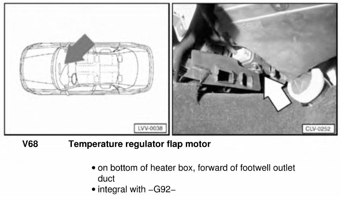

Yes, it is going to be cold winter we better get this fixed up. I does sound like you have a blend door actuator that is out which would be the ticking you are hearing which is failing to move the internal door for the temperature control.
Here is a guide to give you an idea of what I am talking about:
Below are some diagrams of what it will take on your car.
See if this is where the ticking is coming from. Also, if you can take a video with your phone of the noise and upload it here it would help us figure the problem out.
Please let us know what you find.

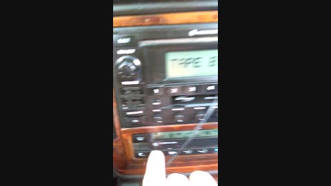

I posted the video it's the best I can get let me know if it's good enough
Oct 4, 2017 at 11:33 AM
Yep that helps, it does look like the actuator is out becasue the controller is working correctly. Go ahead and remove the actuator and move the pivot by hand to see if it moves freely. Then we can rig or fix it.
