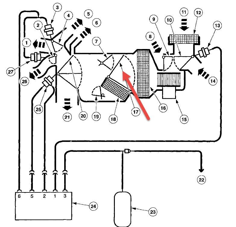

Heater core replaced and thermostat replaced. Radiator flush and nothing still no heat in 3-4 years. now I need more help.
Jan 17, 2015 at 5:43 PM
HMAC300
  • 48,601 POSTS

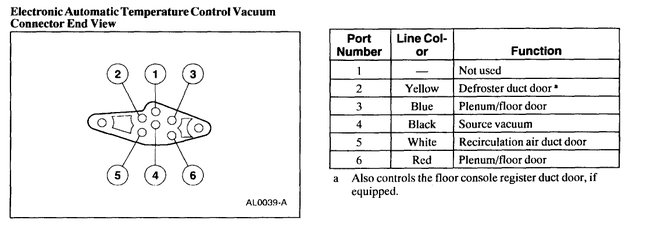

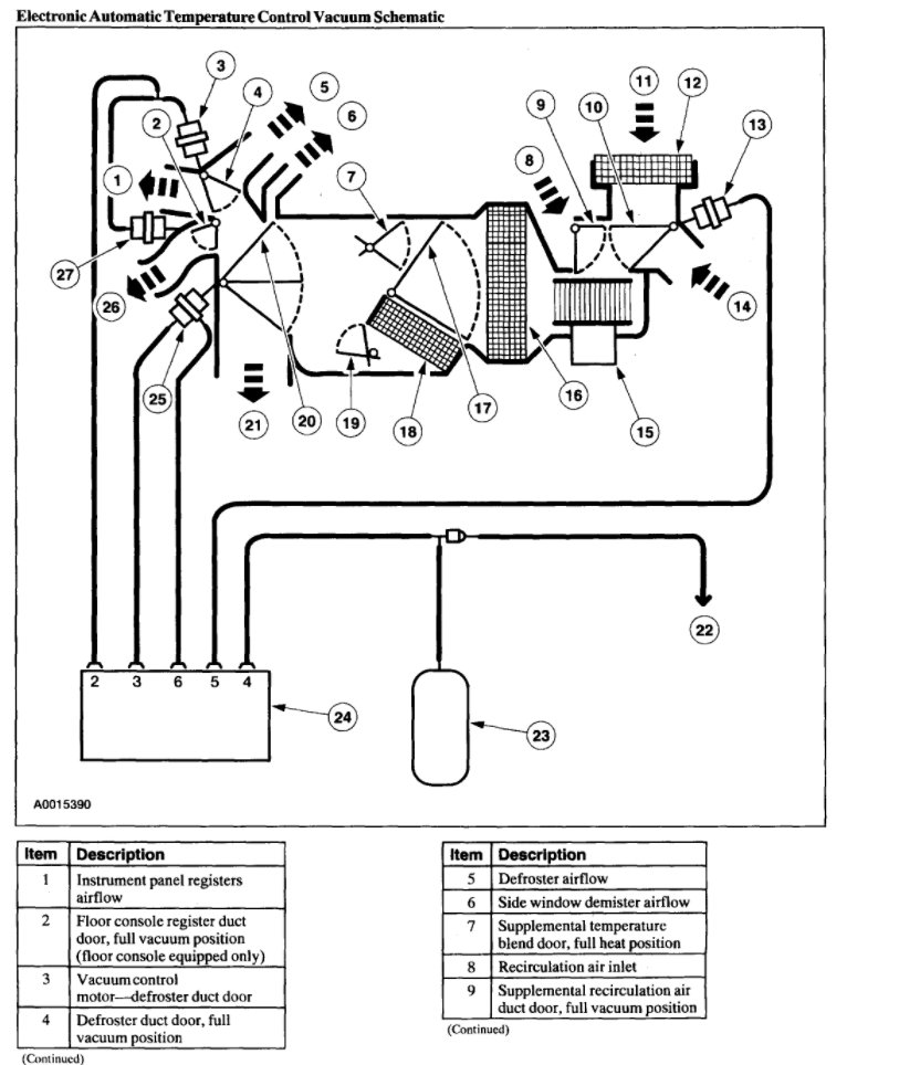

check for a vacuum leak as it is vacuum motor operated the heat door may not be opening start at engine then to control head. pic shows vacuum lines item with arrow is for blend door.

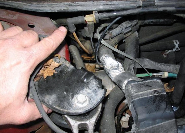

I have a 2001 ford taurus. When i turn on the air conditioning or the heater it only blows out of the defrosters. Panel floor vent will not work. A friend of mine said change the blend door and i did and i found out that all it does is regulate the heat and cold air ( 50.00 part wasted ) Another person said look for a vacuum line, i did and found a very tiny one hanging off the passenger side firewall but don't know where it goes. Sorry for the frustration but i'm a funeral director not an auto mechanic.
Jul 28, 2021 at 1:01 PM (Merged)
CARADIODOC
  • 34,308 POSTS

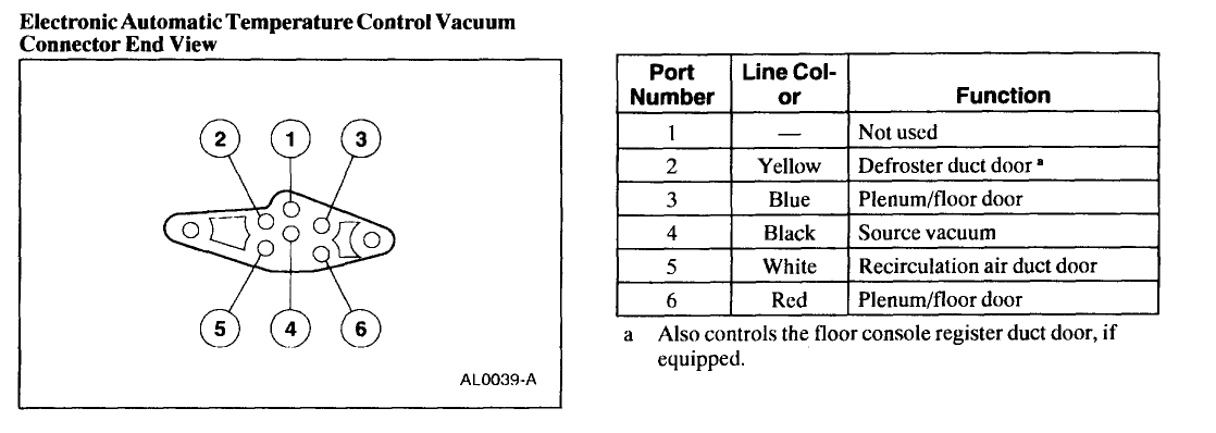

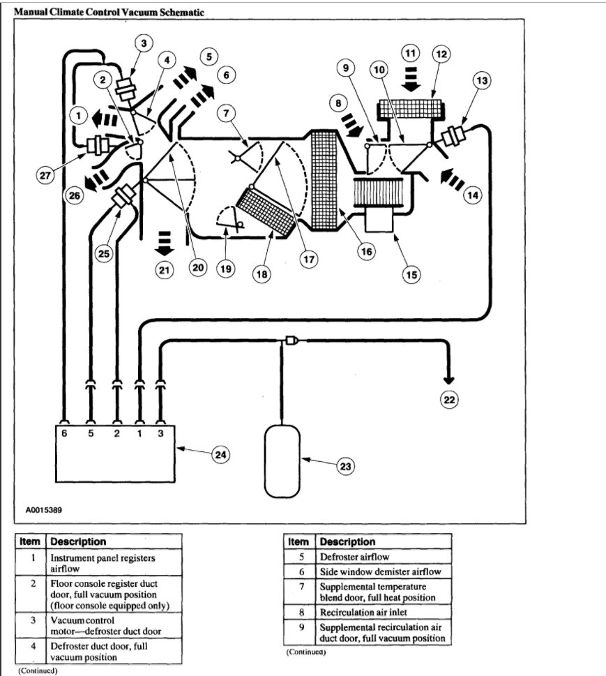

There's is a small vacuum hose that is disconnected probably under the hood headed into the fire wall on the passengers side. Look for a small check valve to plug that hose into. It will be somewhere near or on the firewall near the rear edge of the hood, and it could be about the size of a stack of three nickels with a port on each side, or it could be the style with a built-in storage chamber.
That one is about the diameter of a quarter and about 1 1/2" long, again, with a port on each end. Your car might also use a much larger type of vacuum storage canister with the port for the hose. Vacuum-operated systems are spring-loaded to go to the defrost position when vacuum is lost. Your feet might freeze but the windshield will be clear.
Here are some vacuum diagrams (below) to help you see what needs vacuum. If you need to run a new hose to the control head to fix the problem.
Cheers, Randy

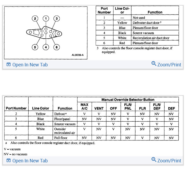

i have a ford taurus the issue im havin is, i cant direct my heat to the floor or vents. i have changed the selector switch and the blend door actuator is there somethin im missin ? i checked the blend door for movement and its not jammed moves freely, also heat works fine i just cant direct it . any help wud be great. 2001 ford taurus 3.lt
thanx
FIXITMR
  • 9,990 POSTS
this is a vacuum operated system here is a diagram. check supply line in engine compartment.

CEDDY2_
  • 21 POSTS
Thanx alot guys, looked under the hood and traced vac lines i had a broken vac line, thanx for the info.

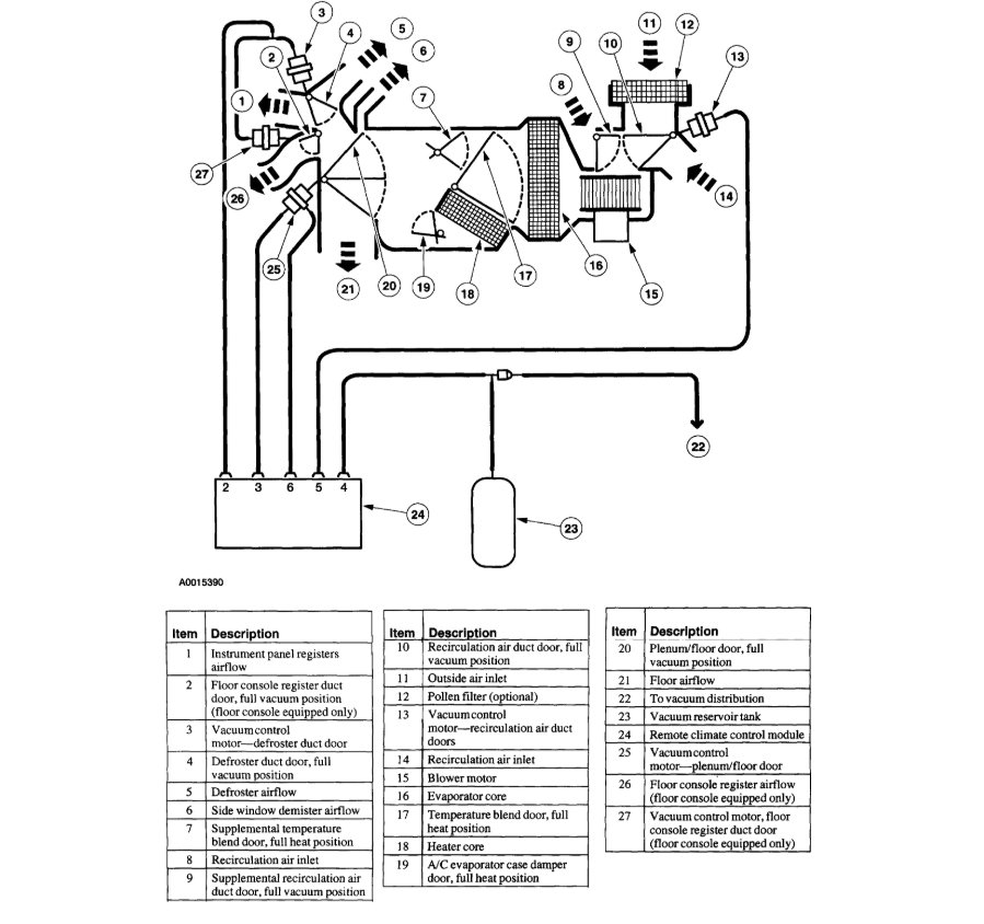

going thru a rainstorm the other day and had to turn off the air conditioner and turned on the defroster. tried to turn the air conditioner back on and it would only blow out heat. the condenser for the air conditioner is working and it is full of Freon but will still only blow out hot air. I was told it could possibly be the a/c control module but I do not know where it is located under the dash to try and change it on my own. Please advise. I'm from up north and this Florida weather is unbearable without the ac. We would appreciate any help with this issue. Thank you!!!
HMAC300
  • 48,601 POSTS

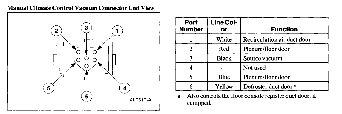

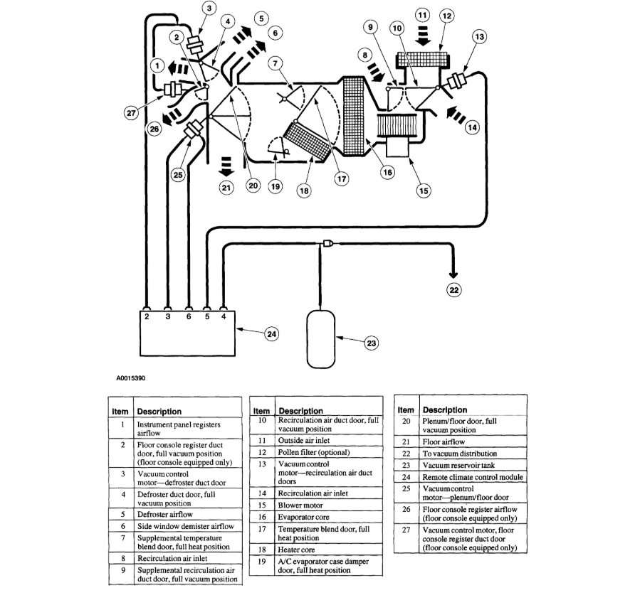

check for a vacuum leak first start at engine then to ac heat control at the back( the buttons or knobs you turn or push.) then see if item 10 is working in drawing it will be a vacuum motor and shold pull the door so only ac will come thru.

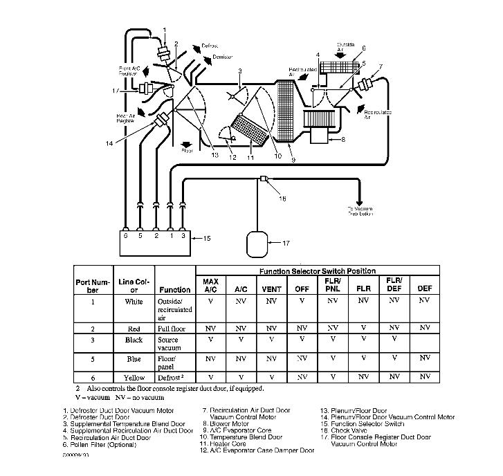

BAESHAWNFRYAR
tiny vacuum line the runs into firewall that controls/regulates climate control. what does it connect to / how do i reconnect?
CJ MEDEVAC
  • 11,004 POSTS
The small line connects to the intake manifold look for other vacuum lines and it should be there. here is the HVAC vacuum line diagrams below. Check out the diagrams (Below). Please let us know if you need anything else to get the problem fixed.
