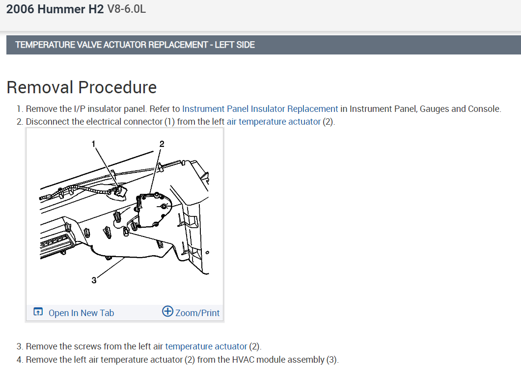

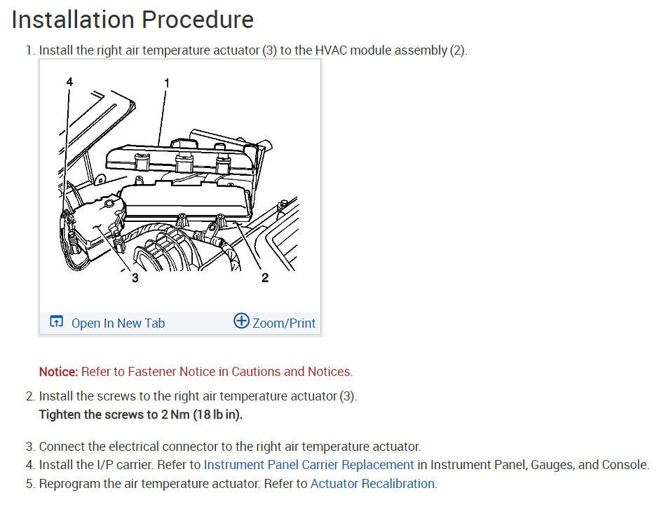

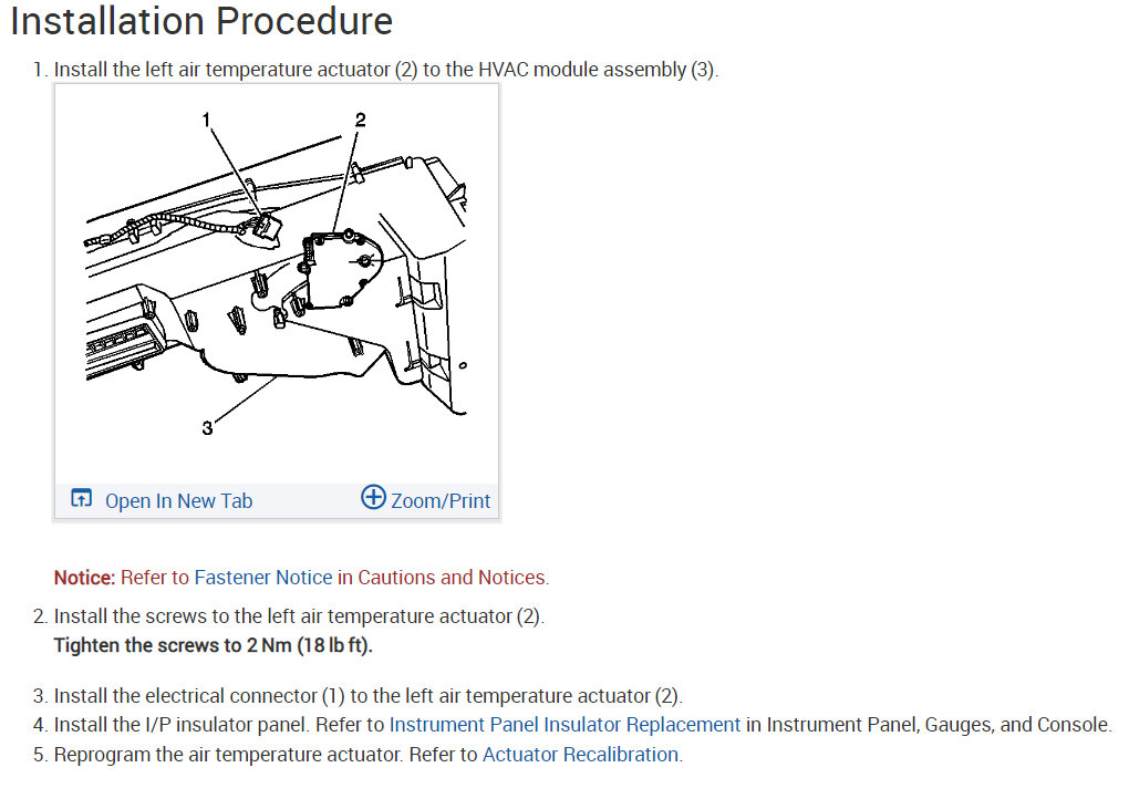

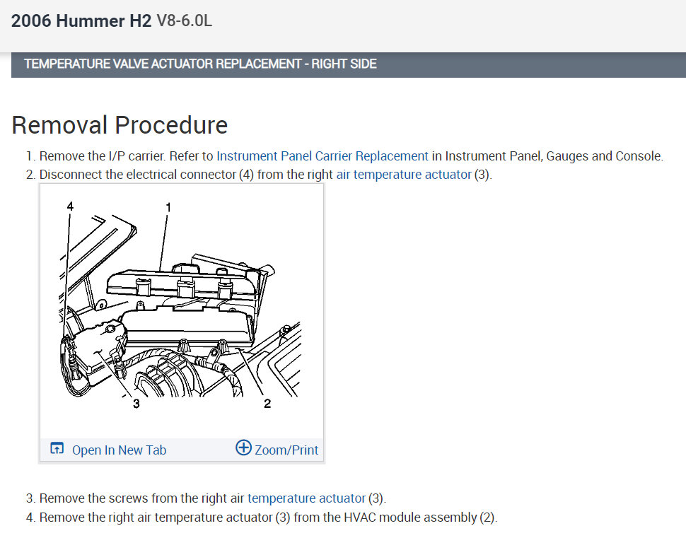

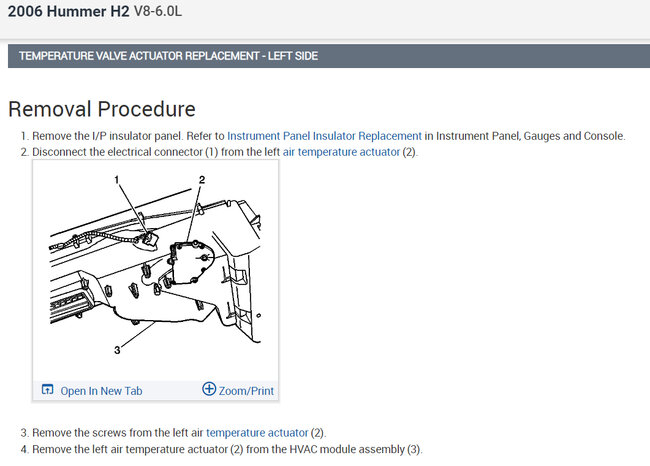

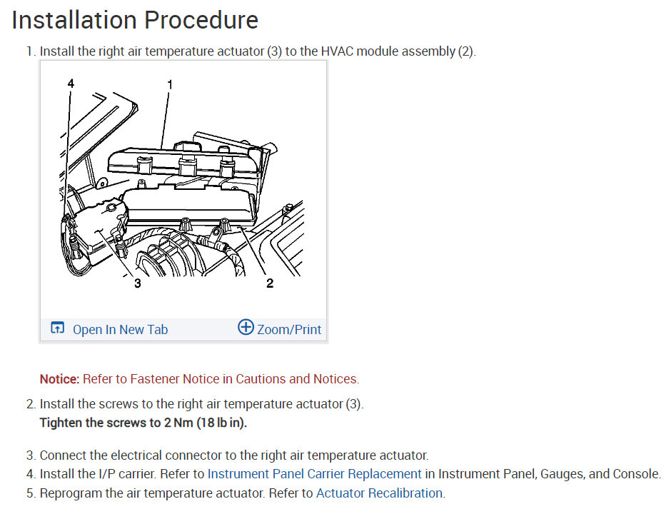

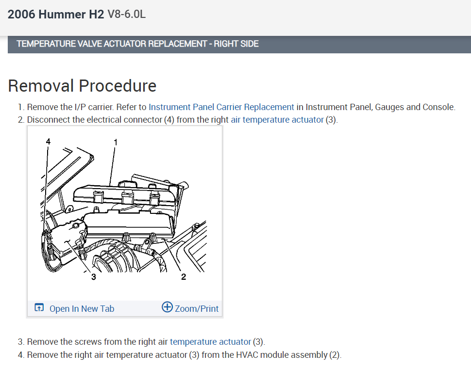

If everything looks okay here is the temperature blend door actuator which sounds like it is not working. There is one for each side.
Please check out this guide and the images below.
Check out the images (below). Please upload pictures or videos in your response to the problem so we can see what's going on.
