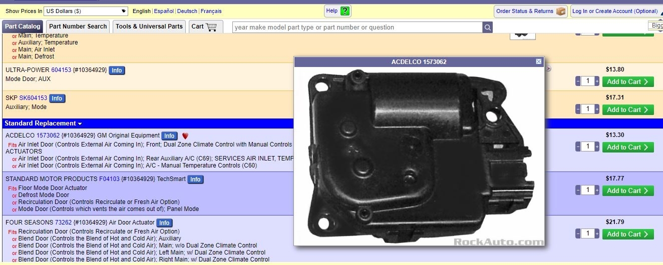

Got 2nd opinion it is the blend door was told that the dash needs to be removed (2006 Pontiac Montana SV6) big job was directed to a rapid rad .
The van does not overheat , no smoke , as how much would cost to get an estimate?
Thank you !!

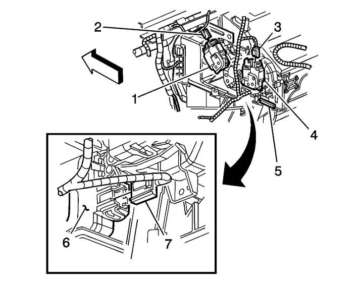

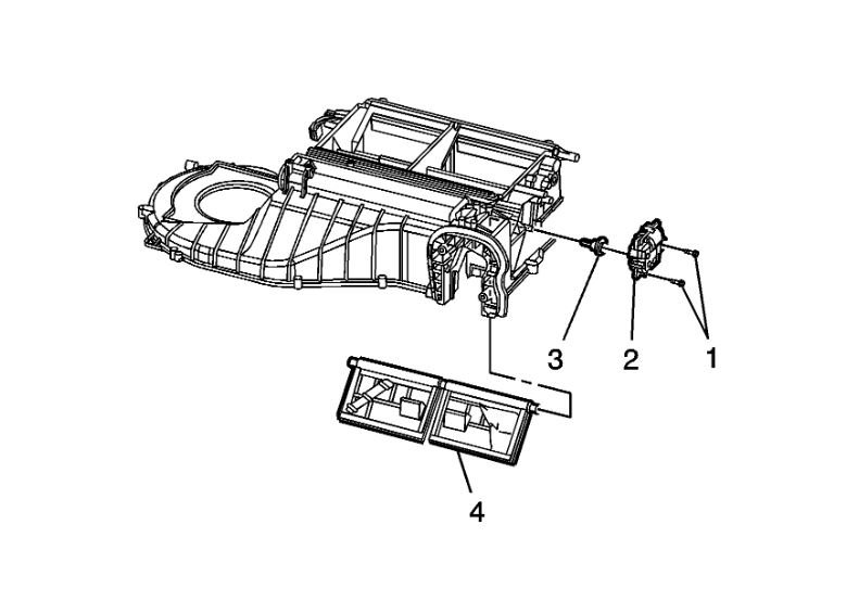

Good afternoon,
If you have a single zone which means you do not have left and right control, the dash does not have to be removed.
The estimate is not high at all. It pays about 1 hour plus the part.
1. Remove the driver side knee bolster.
2. Locate the air temperature actuator (6).
3. Disconnect the air temperature actuator electrical connector (7).
4. Remove the air temperature actuator bolts/screws (1).
5. Remove the air temperature actuator (2).
6. Remove the air temperature actuator lever (3), if necessary.
Mar 4, 2020 at 12:15 PM
