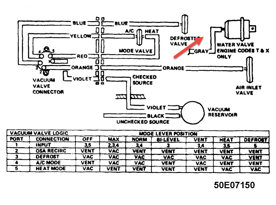

No heat inside car, could it be blend door actuator?
Dec 13, 2016 at 4:09 AM
HMAC300
CERTIFIED EXPERT
48,601 POSTS
check to see if heater hoses are hot and if vacuum going to water valve either on engine or in hose it needs vacuum to open. See picture.
