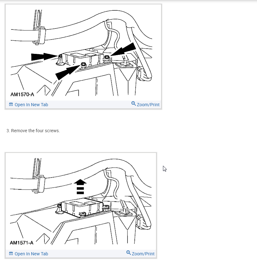

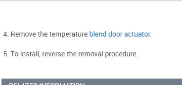

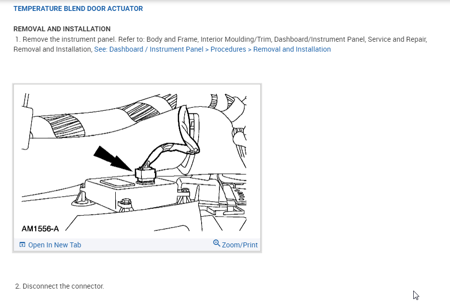

Unfortunately, you need to remove the instrument panel to get to this one. That is not a fun job. I have done this and I don't remember any short cuts. I am sorry I don't have better info for you.
Let me know if you want the process for the instrument panel and I can send that over. Thanks
