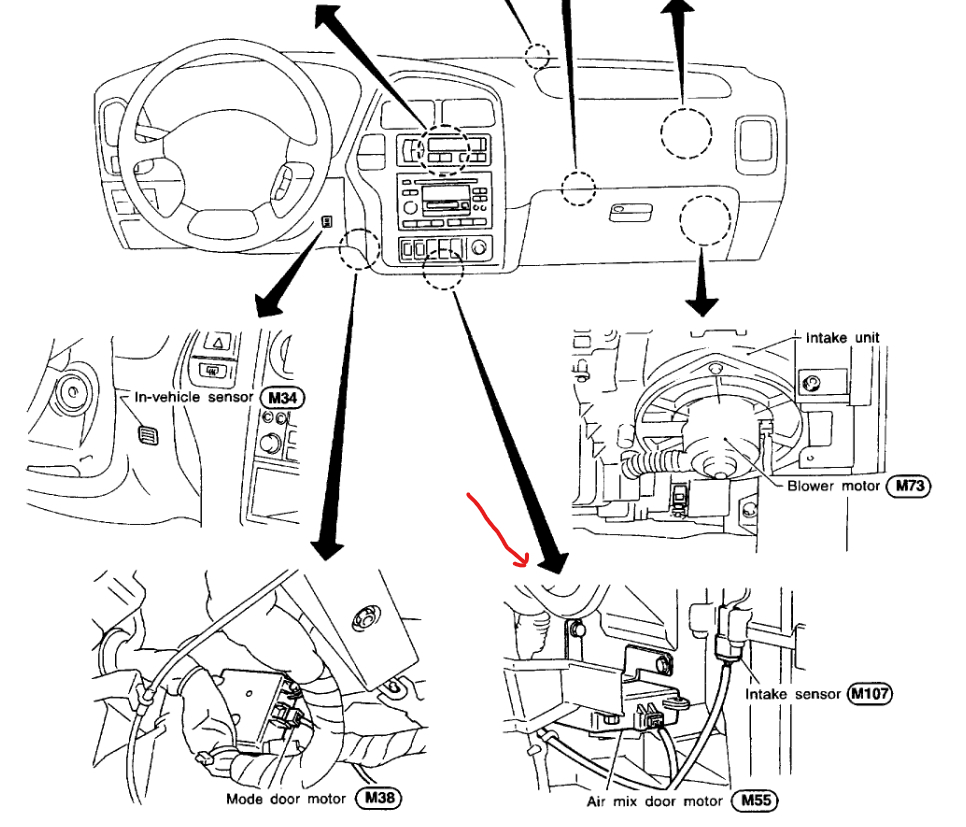

That would be the air mix blend door actuator which might bad, but I need to ask if the heater hoses are getting hot? You might be low on coolant, or you have a clogged heater core that needs to be flushed. Please go over this video for help:
https://www.youtube.com/watch?v=SNRb6pSwYuU&t=1s
Here is the location of the air mix actuator so you can check it out. Check out the images (below). Please let us know what happens.
