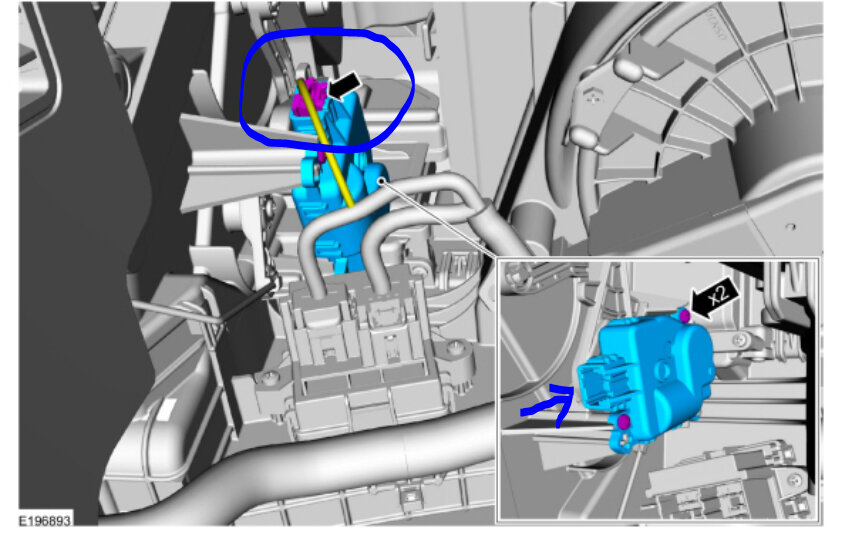

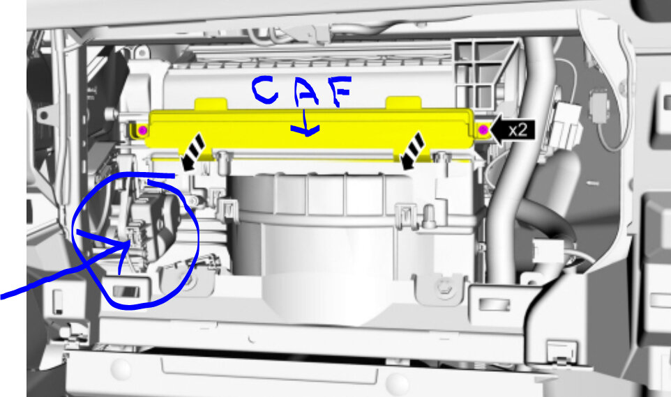

The air temperature door actuator is near the cabin air filter. There is a chance it was disconnected. I attached two pics below. The first one shows the cabin air filter location in relation to the actuator. Pic 2 simply shows the actuator connector.
Check to see if that is loose, disconnected, or damaged in any way. That is what controls the air temp entering the vehicle.
See pics below.
