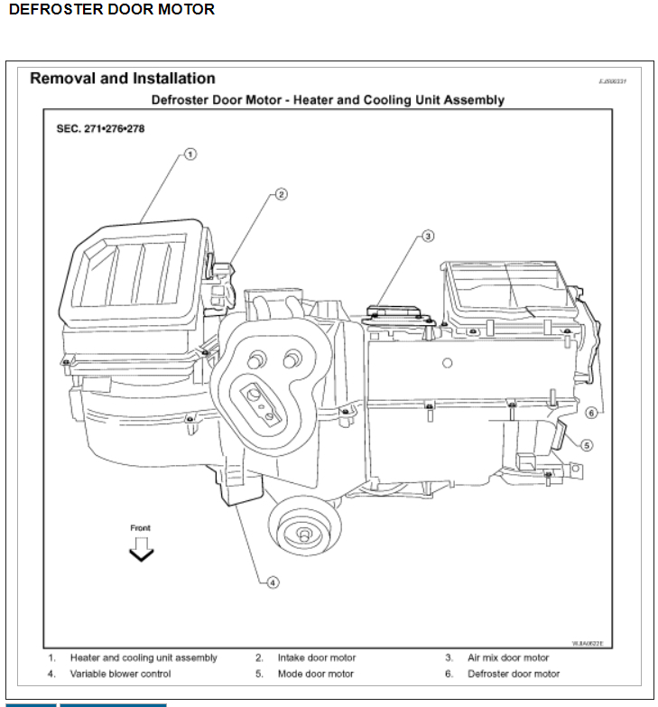

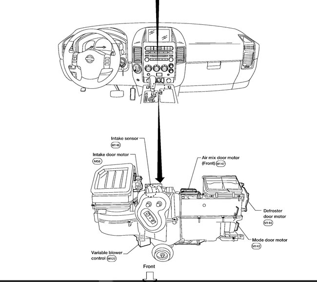

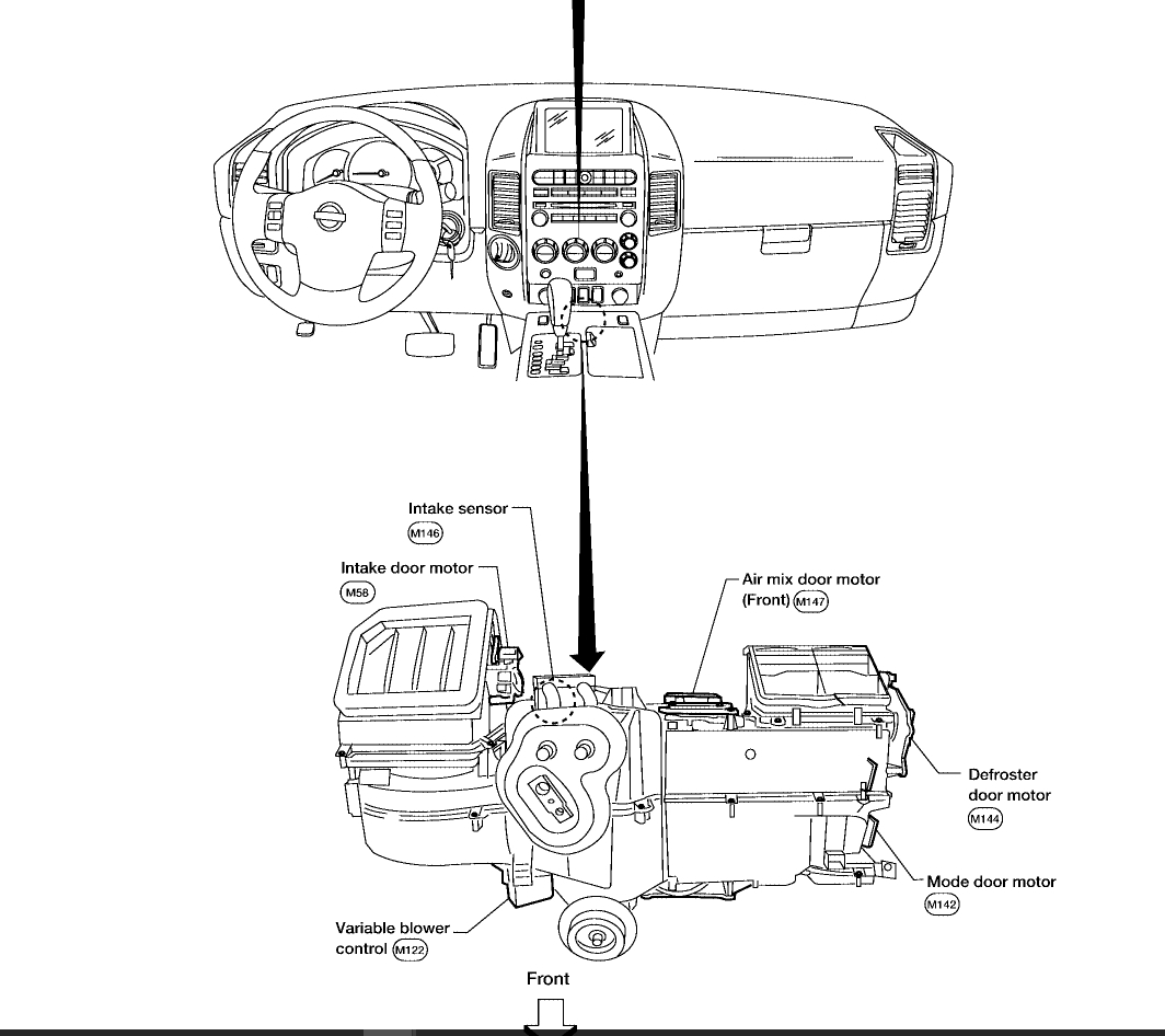

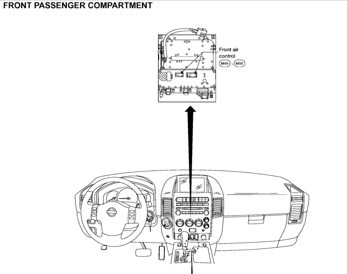

This sounds like a classic temperature blend door actuator that is not working.
Here is a guide to help us see what you are in for when changing the actuator out:
This guide may help as well:
https://www.2carpros.com/articles/car-heater-not-working
Here is how to change the part on your car (below).
Check out the diagrams (below).
