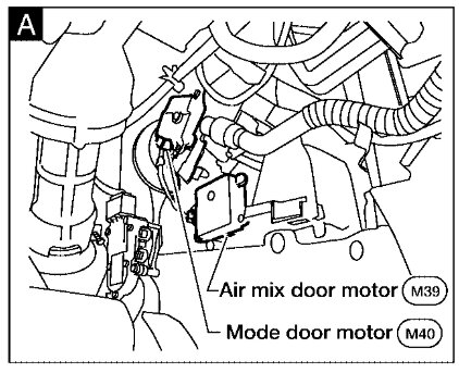

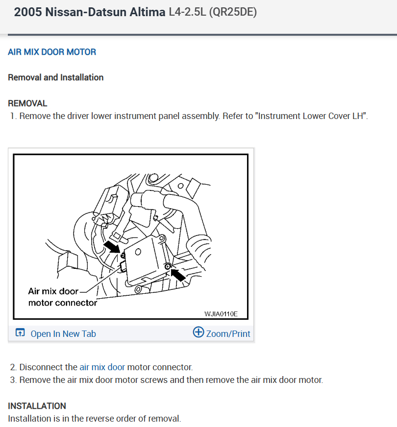

So, I’ve changed both thermostats and did a radiator flush. The car only blowing cold air until I reach 45 MPH, then I get heat. No heat when parked or idling. I was told that it could be my blend door actuator. Where is that located and how do I remove it?

I don't think the actuator can cause this problem, but you never know here is the location of the temperature actuator (air mix door) so you can check it out. Check out the images (below). Please upload pictures or videos in your response of any problems so we can see what to help you with.
