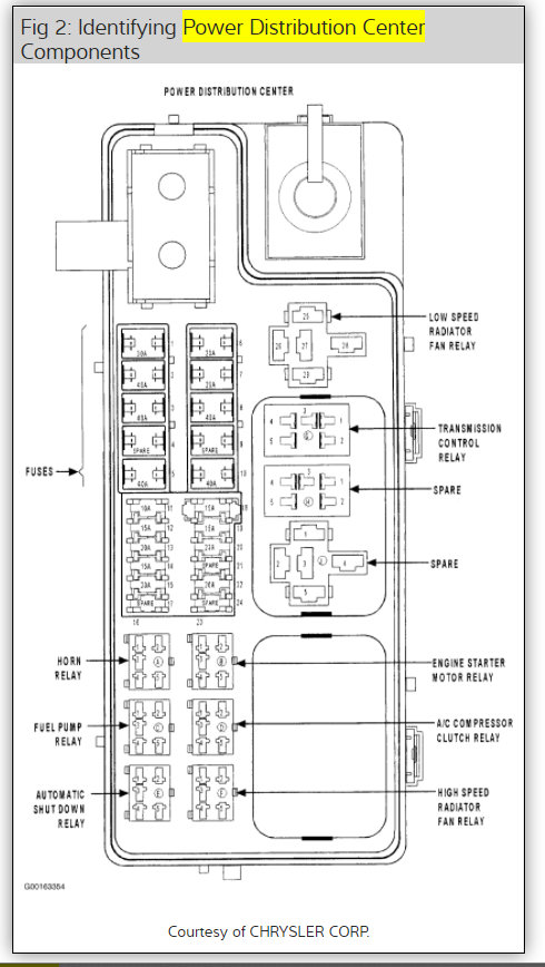

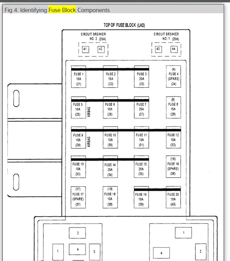

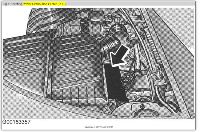

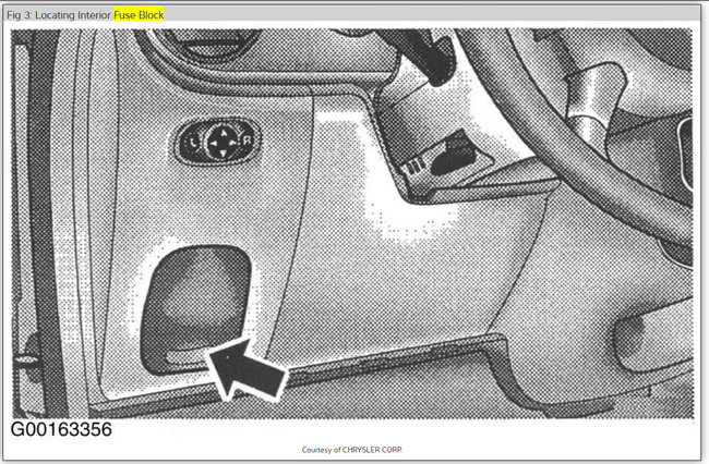

It sounds like you had a voltage surge when you reconnected the battery cables which happens, let's start by checking all the uses in the under-hood and interior fuse panel. here is a guide to help with the fuse locations in the diagrams below:
