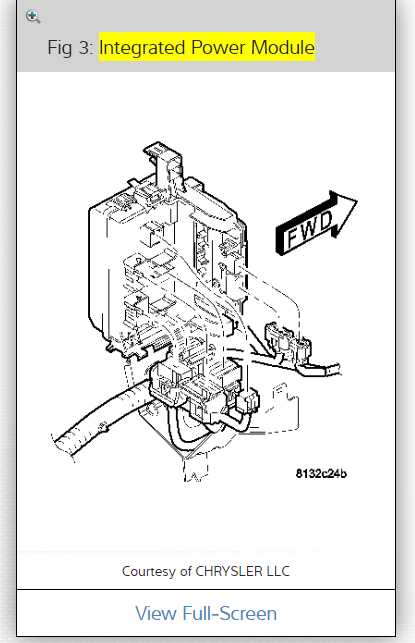

Yep, this sometimes happens when the battery is jumped, the TIPM is weak in these cars and it sounds like it is out but to be sure we may do a CAN scan, you can get a CAN scanner (Controller Area Network) from Amazon.
Here is a video to show you how:
https://youtu.be/u-4syLc-ifQ
and
https://www.2carpros.com/articles/can-scan-controller-area-network-easy

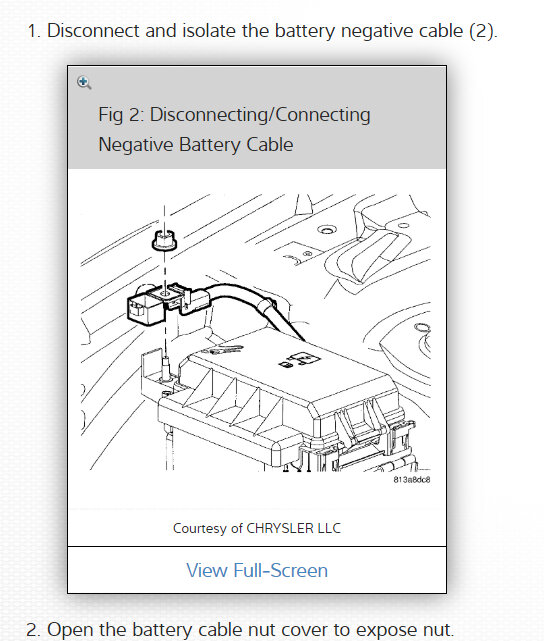

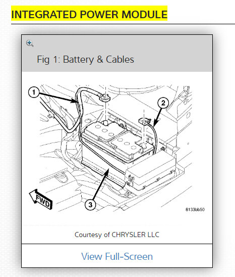

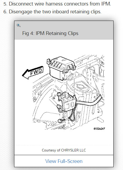

Here is how to change the TIPM in case you need it which is easy to do because it-self learns. Check out the images (below). Let us know what happens and please upload pictures or videos of the problem so we can see what's going on.
