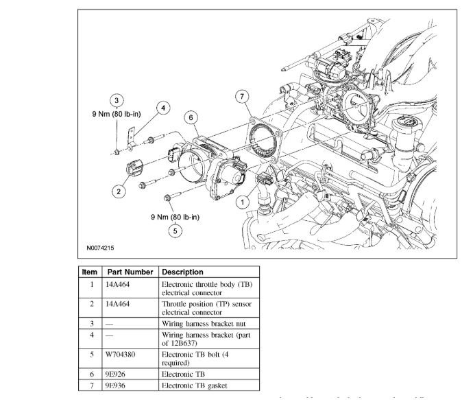

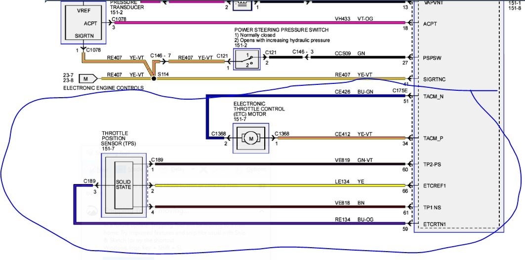

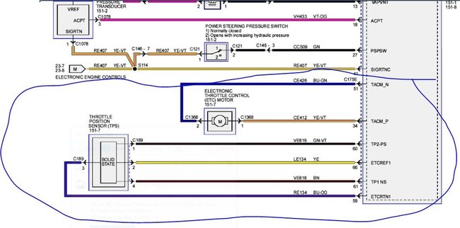

I attached a wiring diagram for you to view of the throttle body control.
Check the connector to be sure it is clean, tight and no damage. It is a common issue for this problem.
