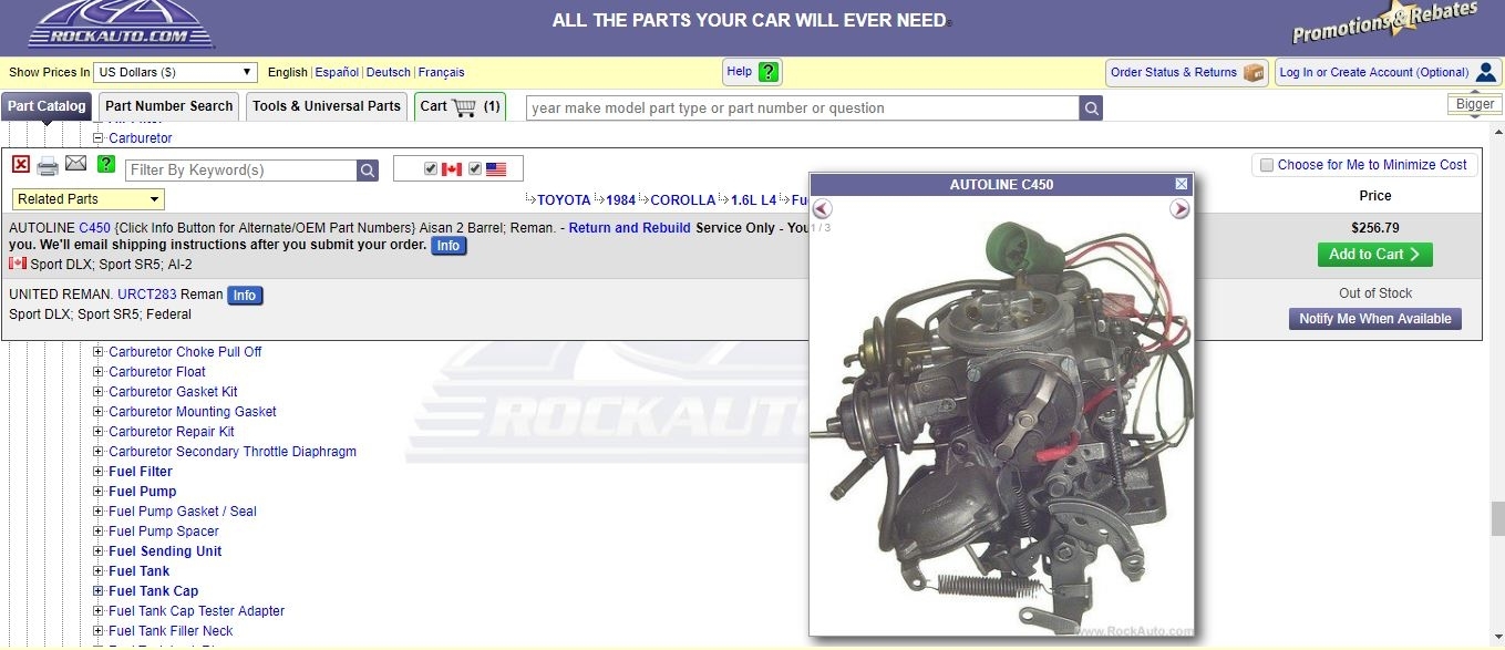

You may want to consider replacing it. Rock auto has a replacement you may want to consider.

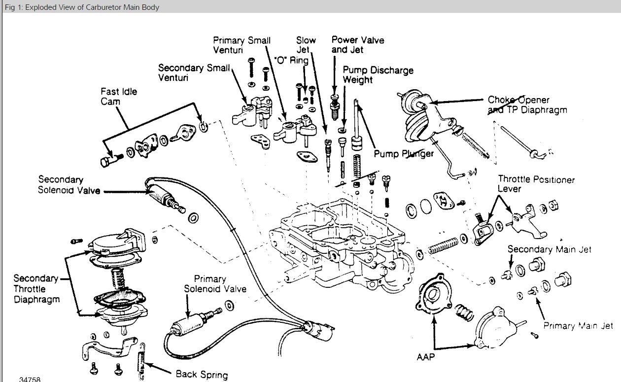

Even before that check the accelerator pump. Look down the carburetor air horn as you snap the throttle open one time. You should see a gas stream squirt down the front carburetor barrel(s). If not the accelerator pump is bad or the float bowl is empty of gas.
the rebuild kit should come with instructions, but here is an exploded diagram showing the accelerator pump plunger.

You need to rebuild the carburetor. the accelerator pump cup is the part you need to change, it goes onto the pump plunger. And make sure the discharge ball isn't stuck in the bore too.
