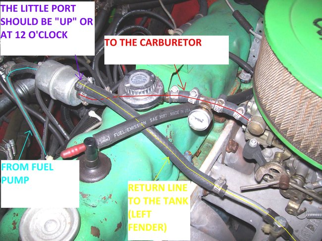

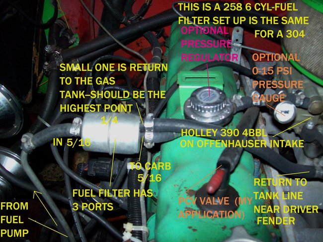

Probably it's really a 258 cu. in. inline six (4.2 liter for all you metric people).
Still have an original mechanical fuel pump?
Have you taken the rubber fuel line loose nearest the carburetor and turned the engine over a few revolutions to see if it gets pumped that far?
I have more!
What do you have this far?

Yes, I have turned the engine over and if I take the gas line off the filter it pumps through but when I hook up the filter that has one line going to the carburetor and one going to return back to the gas tank it doesn’t come through. But you can blow through the filter easy? That’s where it doesn’t make sense. Do I have to have a filter with an outlet going back to the tank ?

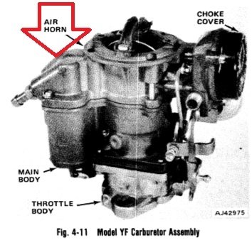

This is a 1 barrel Carter YF carburetor?
How long has it been since it ran normally?
Disregard the regulator and pressure gauge in my pictures.
Sounds like your float is stuck or the needle and seat is stuck closed.
The carburetor thinks the bowl is full, and won't let more fuel in.
Last pic, whop the carburetor with a rubber mallet a few times about the area where my red arrow points. This is over the float/ needle/ seat on a YF.
Maybe it will shake loose, let's not damage the carburetor with the whopping!
Give it a try.

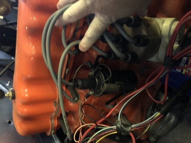

Okay. So I checked the coil and I’m getting a red spark. It’s a new coil but old condenser and distributor. Do I need to replace them ? Also I looked into a hei distributor that I use my coil with. It has 3 wires. One on each side of the coil and the other is for a tachometer. Have you ever used one ?

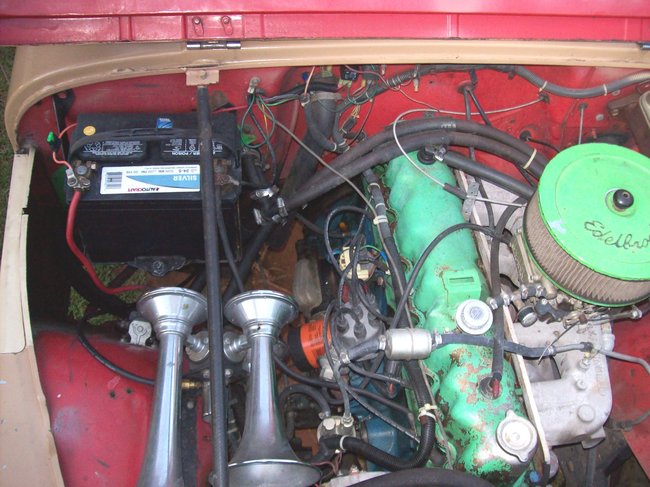

It's hard to see what you have from here, what is stock, what has been changed over the years.
How about laying your hood against the windshield frame. Remove the breather and take me a really good, well lit left side/ right side/ overhead pic of the engine.
Maybe a shot of the solenoid, distributor and ignition module.
I'm not much of a fan of changing things that work well.
I am into "upgrading" to a Motorcraft ignition system (which came out with the 1979 CJs) It's so much better than the Prestolite ours came with.
The HEI and other high speed items really don't improve things like you read in those Jeep forums or how your buddies make them sound. I tend to think of these items as things just to brag about.
The upgrades I discuss are actually beneficial or actually make things better.
The HEI and other high speed upgrades really don't help your run of the mill everyday Jeep out much, sure, if we were turning mega RPM's and had money to blow one might somehow benefit.
Keeping things mostly simple is how I like it.
Let's see some pictures then I can maybe make better suggestions.

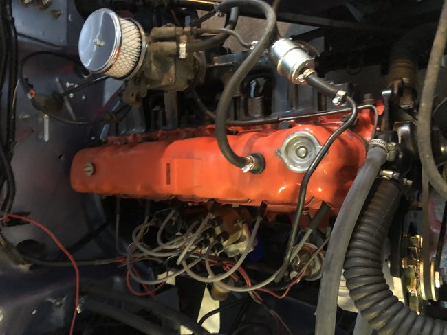

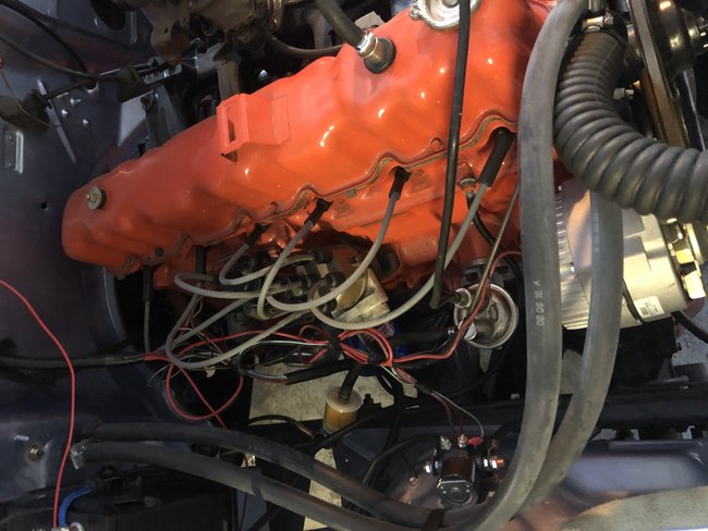

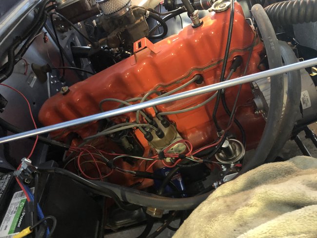

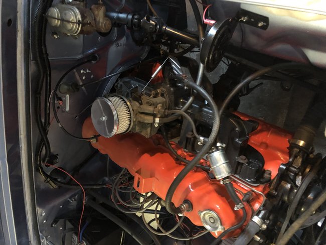

Here they are. Sorry it to so long.

As it stands now, still not whacked the top of the carburetor?
Your whole engine compartment is so darn clean and pretty! Come make mine look like that!
I found one glitch that is unrelated to the bowl filling up.
It would affect the way the engine runs and tunes up.
The PCV valve is in the front hole. It's job is to remove combustion gasses and water/ moisture from the crankcase.
The carburetor is engineered to also run off of the air that runs through PCV needed for combustion.
In stupid terms, lets say 90% of the air goes through the carburetor's throat and 10% comes through the PCV. All of which is needed to make things run correctly.

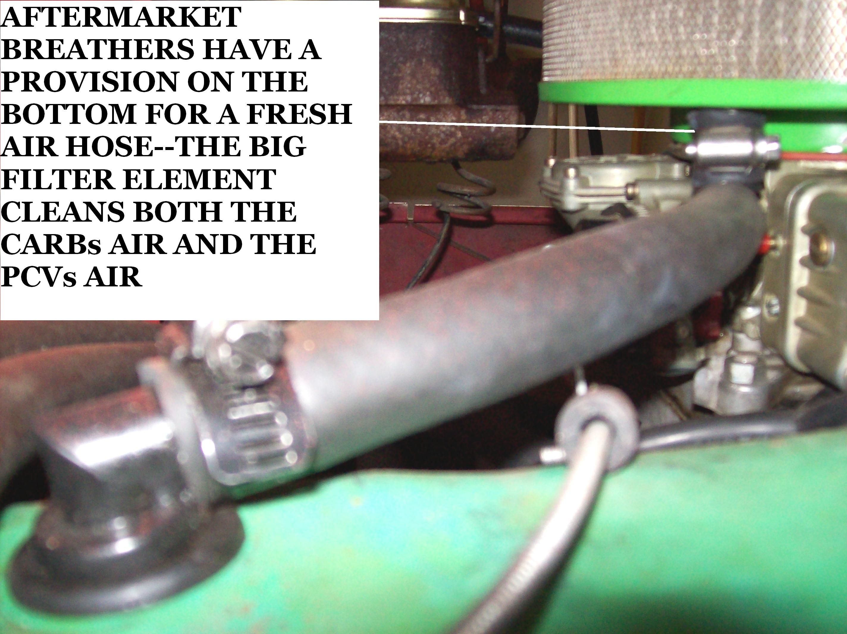

As it stands now, the rear hole in the valve cover looks to be closed off. Basically, this would be the same as plugging the PCV hose off as air cannot continue to move through the PCV after a vacuum gets pulled on the engine block. The 10% of air no longer gets to the carburetor and correct tuning is impossible.
The easy fix for this is to simply pipe over to the air cleaner and draw clean fresh air from there. You might modify your air cleaner, or purchase another with the provision. I recommend this way over the next option I show below. (See my pic)
This option basically sticks a filter up out of the second hole. Eventually it gets stopped up or restricted and you are unknowingly back in the same boat you started with, unless you stay on top of things. See my link.
