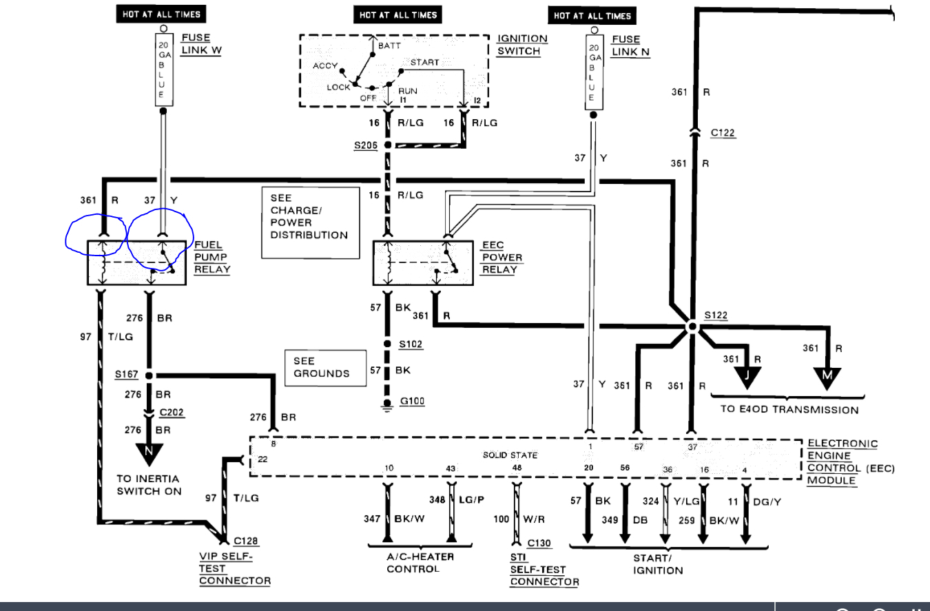

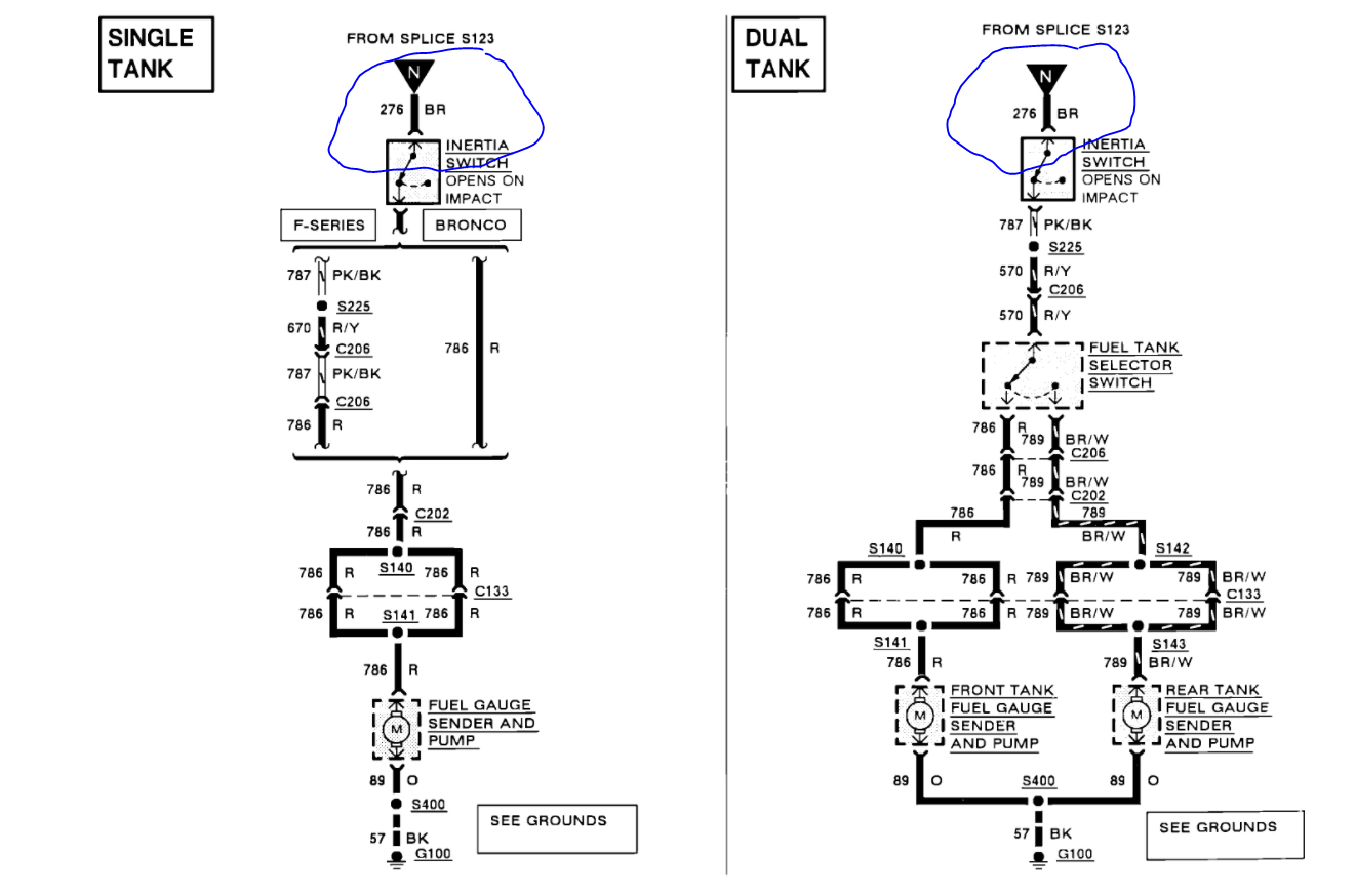

Have same issue 1990 F250 xlt. My EEC and fuel pump relays are good, the reset/shut off switch good, check all wiring i could. Replaced tank selector switch, fuel filter. And sometimes it will kick on and prime runs fine. Others hear relays clicking but pump not priming. Never had problems with pumps stalling when it's running. Lost is an understatement for me. Been almost a year and still having this problem always worrying when i turn truck off that it won't start back up. help!
