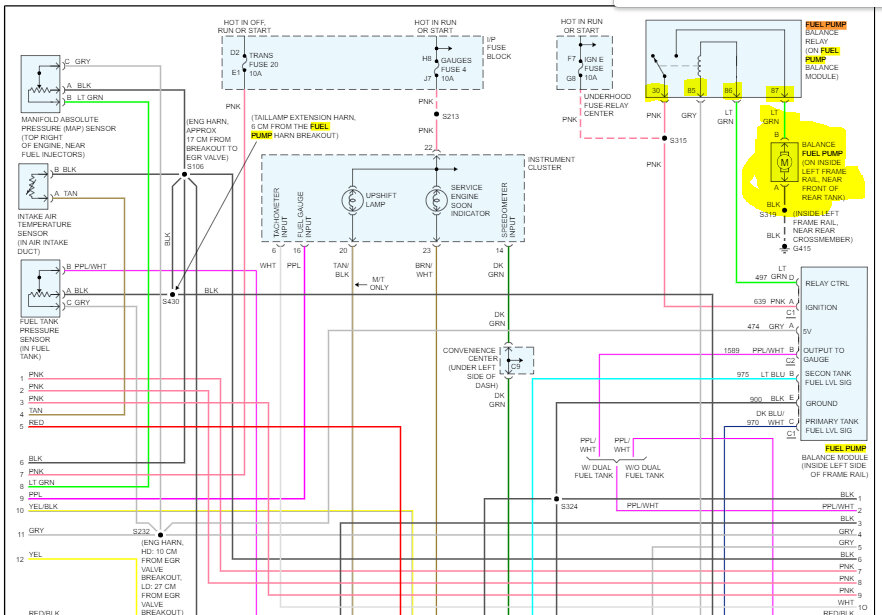

I'm not sure what would have changed from replacing the oil pressure switch. It shouldn't have affected the fuel pump.

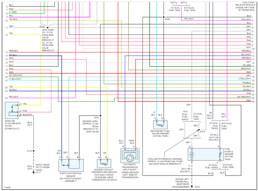

I attached the schematic below. Have a helper turn the key to the run position while you check the light green wire at the pump to confirm there is power. Keep in mind, the power supply will be brief.
Try this and let me know what you find.

Thank you, Joe. I was able to confirm that the pump was working properly after I figured out that I had put the wrong connector on it. However, I have no power going from the relay to the pump. I have constant power to junction 30, but when I turn the switch to the on position, I get nothing to the pump, not even the prime. I jumped from 30 to 87 and had power briefly but blew a fuse. I replaced the fuse and relay but nothing. In a YouTube video the guy kept saying that there were multiple fuses for the pump, but I could only find one.
Sep 18, 2023 at 5:02 AM
When jumping the relay, did you cause a short which led to the fuse failing? I ask because that shouldn't have happened.
Now, do you have power to the primary side of the relay? It would be related to pins 85 and 86. Also, is there a ground path being provided to actuate the relay?

I have constant power to pin 87. I no power going to any other pin. I’m fairly sure that when I turn the key to run, I should have power to the pin that actuates the magnetic switch to let power go to pin 30 to turn the pump on. Is that correct? Is there anything that I could have missed when reconnecting the distributor? Or a fuse or fusible link?
Sep 19, 2023 at 4:39 PM
When the key is on, there should be power to two pins. However, power stops after approximately 2 seconds if there is no ignition signal. When you checked, did you have someone turn the key on while you checked? If you turned it on and then went to the relay, chances are you won't be fast enough. LOL
Also, how many connector pins are on the relay? Is there 4 or 5?

There are 5 Pins. And you are right, I thought I had more time to get back to the relay, but 2 seconds doesn’t even give me time to get around the door let alone get to the relay. I will get someone to help.
